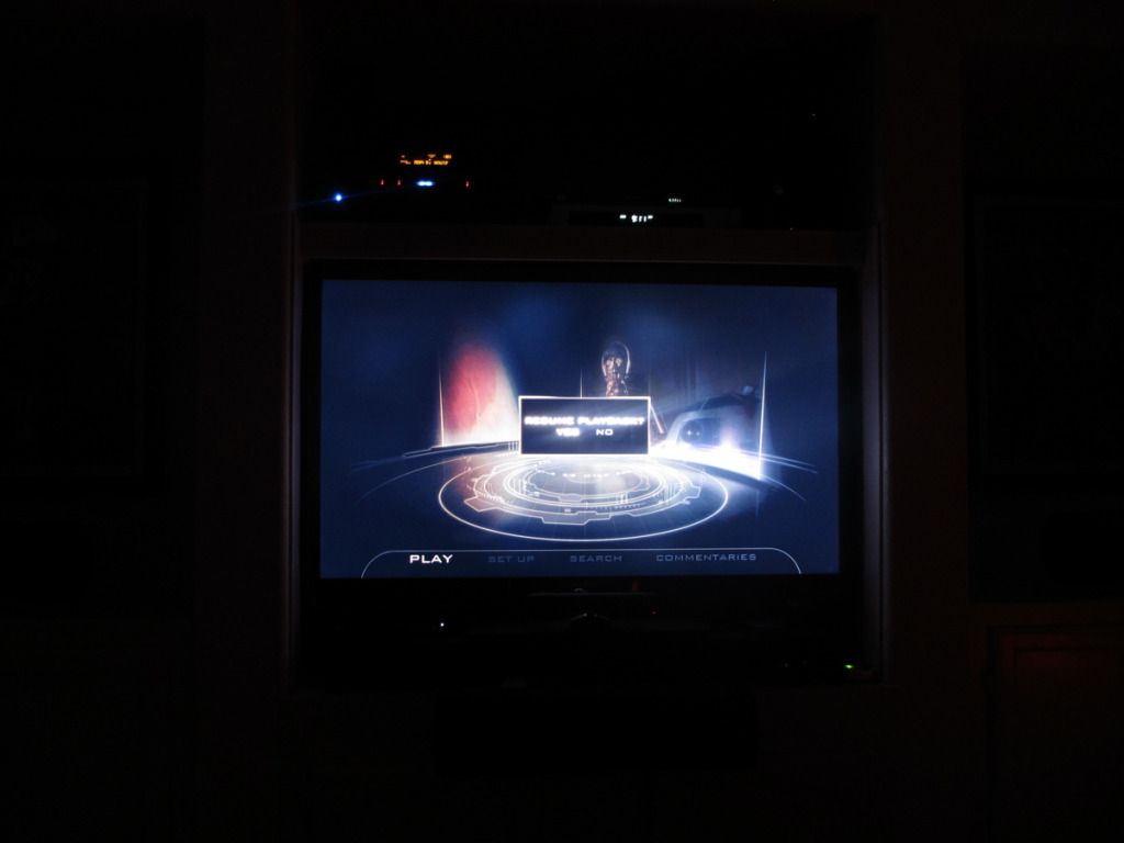

Hey guys. Looking for a little help here. I am looking to replace a Sharp LC52LE835u that I bought last year. I am now on my 4th replacement and they mentioned giving me a refund. I have had horrible clouding issues. I notice a few posts that talk about flashlighting / bleeding / clouding. I want to see if anyone has had any clouding issues that would be as bad as this pic.
you can see the blueish color blobs to the left and right of C3PO's head.
aaronwalker1974 is offline

Does the light bleed interfere with the picture at all? Like in my pic?
Also did you notice any lag while playing uncharted? Did you do anything like rename the hdmi input PC or play on game setting?
My biggest concern is screen uniformity followed by lag. I also don't want a plasma as I had a G25 that would have horrible image retention that would last over a week.

Liked: 33
I only notice it when the screen is completely black. The bleed is better or worse based on my settings mainly the backlight. I have had a plasma for years, so I'm not a fan of super bright. I prefer more natural. I usually use a cinema mode with the backlight 30 or less.
I have only played uncharted 3 in 3d. I used the game mode setting and didn't notice any lag.
I think unless you get a set with full array led backlighting, you won't get uniformity like a plasma. It's the nature of the edge lit led design. You pics do look pretty bad though. That would bother me too. I traded the LG 6700 60 inch plasma for this one. I had 2 in a row with dead pixels. It also displayed 1080i blurays incorrectly. Only switching to game mode made it play properly for some reason. The overall picture on the plasma was better, but for me this was a better option. I have gotten hooked on 3d and I don't have plasma paranoia about burn in anymore.
Good luck with the search.

http://www.imagebam.com/image/1b65d8190131823
note: the light is a reflection of a ceiling light, not an image on the screen. And of course the bottom of the screen is my camera's (Nikon P510) flash.

the picture looks good. Didn't see any bleeding / flashlighting.
This is really bad. I have had flashing issues, but never over an image like you have here. Return it.
