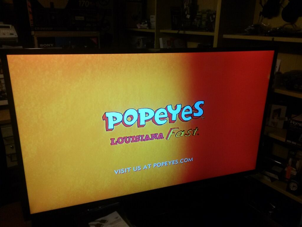

So, specifically for you, if his panel is half lit, it's probably a bad LED string, and no problem with the panel.  You should be able to swap panels (CAREFULLY!!!), and be good to go.  Try to get a pic of his screen in the ON state.  If there is a straight line down the middle, and half works and half doesn't, he might have connections issues with the panel and T-con.  If there is a dark triangle at the bottom of the screen (about two feet long at bottom, peak of dark triangle about a foot above bottom), then it's a bad LED string.
Good Luck! and BE CAREFUL WITH THAT PANEL.  It's the whole value of the set, though I'm sure you know that by now.

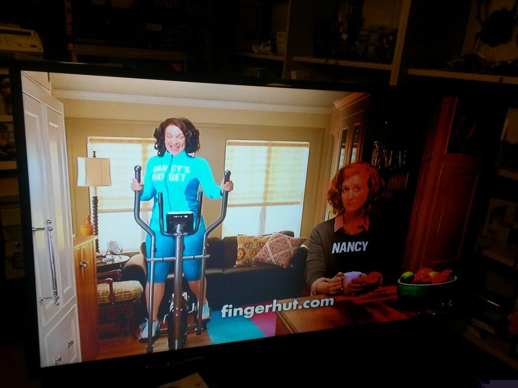

Posts: 3
Here's the pictures from his tv. I'm driving up there now. Is this doable or his panel bad? If the led string is bad, then how can that be replaced?
