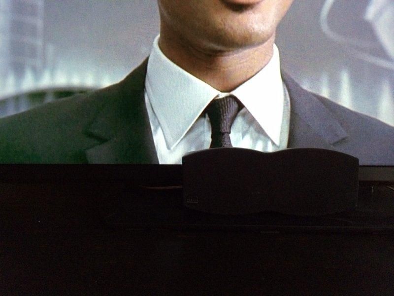

Hello all,
I just purchased the 80LE650U after a great sale on Frys that Amazon PM'd. I received my TV over the weekend. I noticed that there is a lot of clouding or DSE as I have seen it referred in this thread. Its more pronounced during the start up screen saying "Sharp" or totally dark scenes. I know this is normal with edge lit LED screens.
What I want to know is what is acceptable clouding?
I see people refer to white spots? is that the same as clouding?
Attached are links to picture of the clouding issue that I am referring to which I felt was excessive but would like others to give their feedback.
http://i37.photobucket.com/albums/e9...p80/photo3.jpg
http://i37.photobucket.com/albums/e9...p80/photo2.jpg

No, if you can see something clearly enough that should not be there but that you are able to photograph, I cannot imagine that would be acceptable.
White dots are literally pinhole size bright white dots. Clouding is large, several inch blobs and paler lightening. Very different.
So I guess I have to Ask Amazon for a replacement. Is there any way to guarantee a better panel? Like from serial # or manufacture date? mine is May 2014.
Also any test I can run as soon as TV is delivered to know if its good or return it right away?
Appreciate help input.
Sorry I really don't know of there being any bad batch.
For test patterns, that's tough. What did you watch to see it appear this time?
There is a DVD of test patterns some people use to age the phosphors in a new plasma, made by some avs folks I think, that might be useful I guess.
This one just appeared on the start up screen. Wasnt obvious during the day but when I turned it on at night in dark room, It was obvious.
Would Sharp provide any support on this issue under warranty?
Also any suggestions on a movie to watch that would tell me if the cloudiness impacts the experience? I assume something like a dark knight has a lots of dark scenes or anything since then that experts use to determine the quality of the screen?
Best to call Sharp about warranty service. They will want photos.
For testing, I am told that "The Descent" is a reach good test of dark scene capability. "The Dark Knight" is less ideal because specular highlights will make stuff look better. But if you are not seeing it after several days of watching material, that's a good sign.
