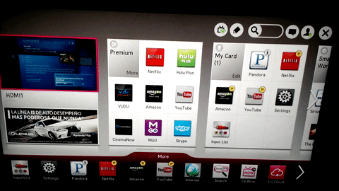

Since one of the latest updates I've been experiencing some funky issues with this television...
Some strange side menu was coming up on the left of the screen and I was having difficulty getting it to go away. Somehow the TV got kicked over into Demo/Store mode and I had to go in and manually change it back. I think it's stopped doing that now?
My video settings appear to be switching over to vivid on their own and I have to change it back to Game every time I use it now. Every time I turn the TV on or change the source it keeps flipping back to Vivid video. Not sure about the sound, I pay less attention to that I guess? Should probably check when I get home from work.
The brightness of the TV keeps dimming on me while playing games when it is in Game mode. Brightness settings shouldn't be changing on their own should they? I will pause and go into different menus and I come back to the game and boom it kicks over into the correct brightness again. Then a few minutes later it will slowly dim until it is dark and difficult to see again. Frustrating.
Anyone else experiencing anything like this with the latest firmware updates?

Short answer; no.
Longer answer; I'd try resetting to factory defaults, turning it off, and then turning it back on and redoing my settings to see if they stick. If not, I'd be contacting LG's support. Might ask if poltergeists are covered by their warranty.
Hope you get it sorted.

So uhhh yeah.
considering that everything else had been changed/set to defaults/etc
Checked video settings again and Eco mode was set to Auto.
Changed it to Off and that probably fixed it (Duh)
Haven't checked it yet. Will take a look at it again in the morning to see if anything resets again.

I was thinking about the "factory reset" under options, but hopefully you've found the culprit. Now that you've mentioned Eco Mode, I've found quite a few posts by people with similar problems and Eco Mode being responsible. Making a note to never use Eco Mode.
