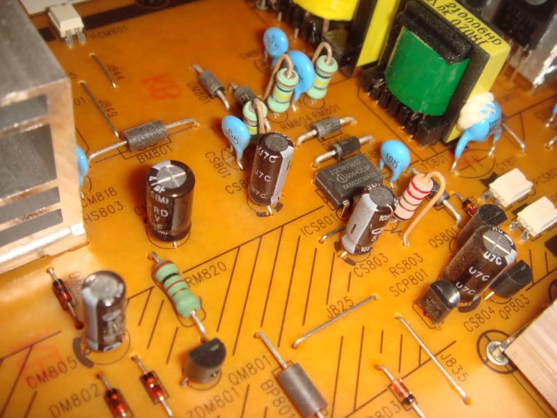

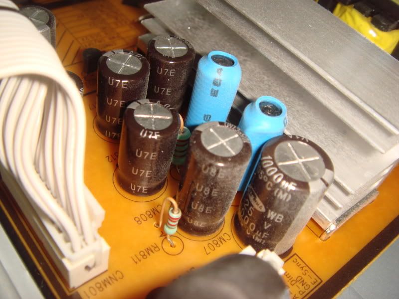

post #19243 of 19636 Old 07-06-2010, 03:46 PM
Lance_M's Avatar
Posts: 71
Hey guys,
The last few days my tv has been taking longer to start. Sometimes, it will start up fine, but then after a few minutes on it will cycle to search for a signal an then turn itself on. Mind you, the tv has been sitting in storage for about a month.
I have a tech coming out on Thursday from calling samsung, but they said if its not a capacitor issue I will be charged $79.99.
Here are some pictures. I don't see any bulging. I am thinking about canceling the appointment and if it gets worse call back. DO you guys see anything????
Lance_M is offline

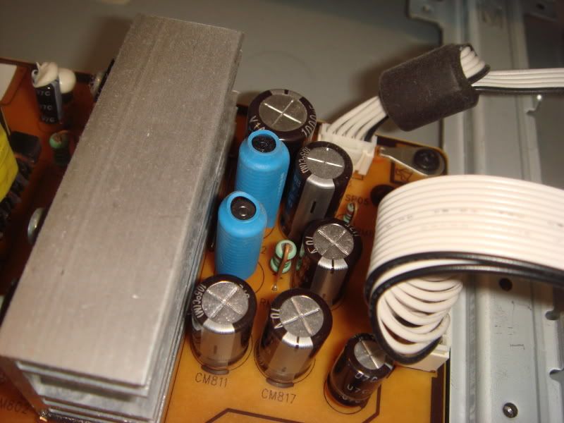

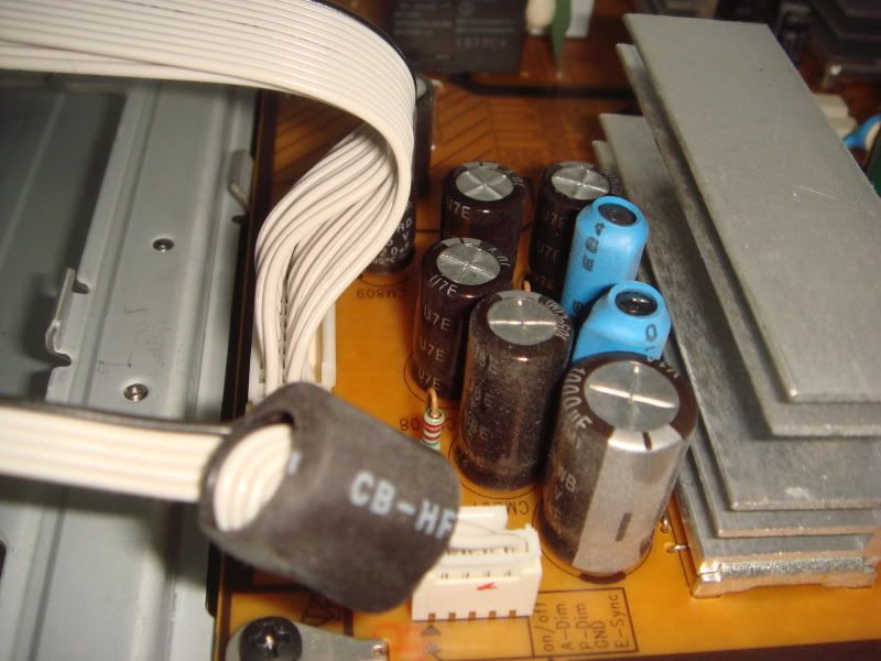

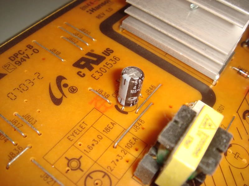

post #19244 of 19636 Old 07-06-2010, 04:03 PM
scsiraid's Avatar
Join Date: Nov 2003
Location: Vero Beach, FL
Posts: 1,934
Originally Posted by Lance_M View Post
Hey guys,
Those caps look fine.
scsiraid is offline

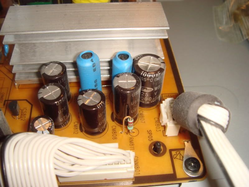

Hey guys, I need some help here. I have the Samsung LNT-4061F LCD.
My set goes off its extended 3 year warranty in less than a month. Unfortunately, it's from circuit city and the company that bought those warranties have been a bunch of aholes in the past. Someone was supposed to come out Wednesday to look at the set, but n one has contacted me yet from the local service center.
Anyway, here's my question: I've been reading all the reports on this thread about the pink pixel issue. Mine seems to be similar, but different enough for me to ask on this forum if my problem is the same - when i turn my set on, it often has green dots all over the right side of the screen, along with a white "tear" on the top left part. The rest of the screen is covered with other weir stuff, some violet. But not much. Much more green and white text and dots.
I'll attach a few pics to show what I mean.
Any input would be much appreciated, since the service guy is supposed to be here Wednesday (today).
smail.nathan is offline

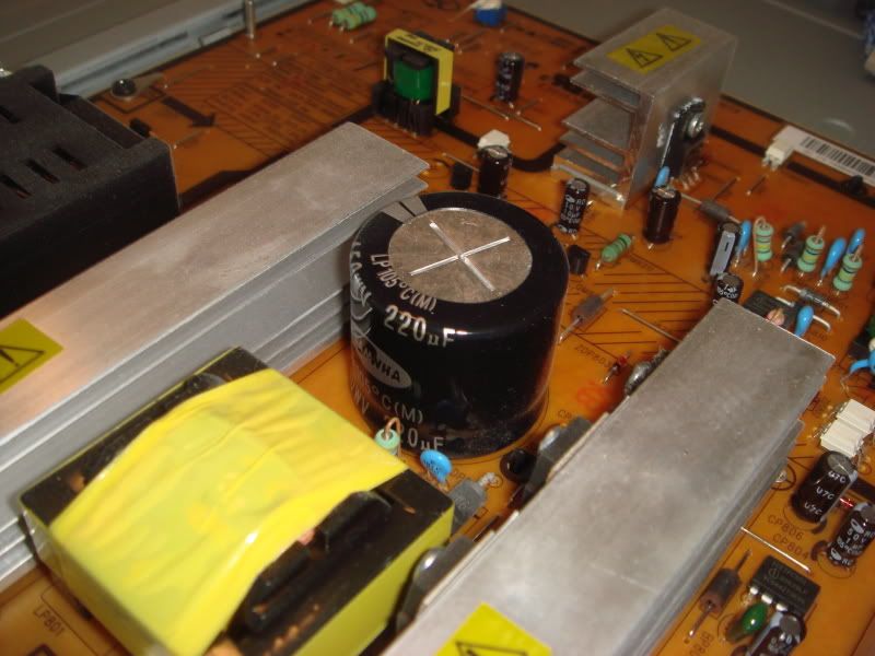

Posts: 11
I am also having issues with the power cycling and clicking and purple/pink snow. Took my TV apart last night, and there are 4 out of 5 of the 10v caps that are bulging/leaking. I called Samsung and spoke to CS and ECR. My TV was made before the free out of warranty service range... July 07. I will attempt the fix myself this weekend.
Update:
Got anxious. Borrowed a soldering gun from a co-worker and passed by RadioShack to pick up the 35v 1000uF capacitors. Took apart the TV and replaced the 4 capacitors in about 2 hours max. TV turned on without any of its previous issues. Saved a couple hundred dollars. Thanks for all the input on this thread!
KrZYtRiP420 is offline
