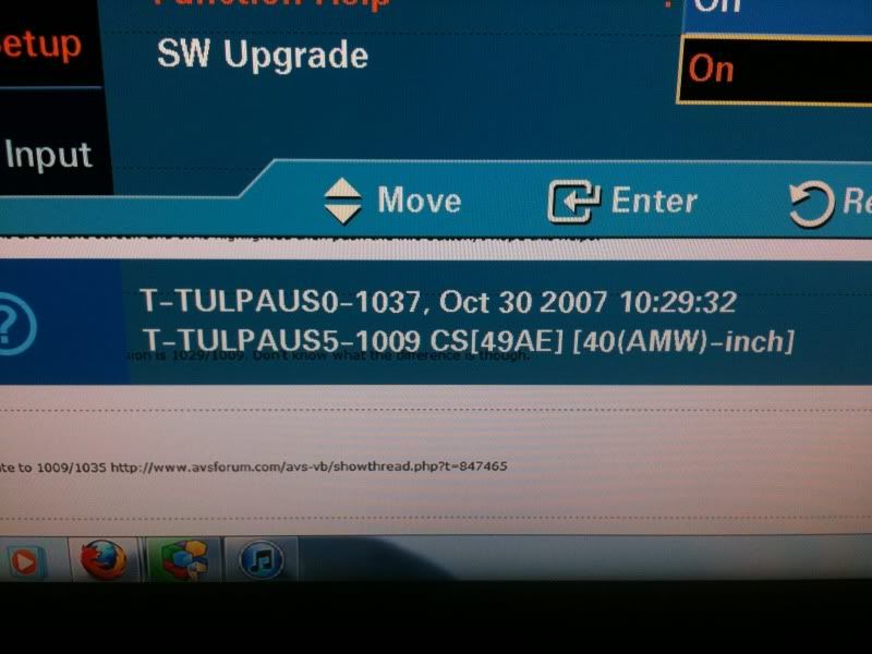

I got my Samsung 46" LCD HDTV in very early 2008. It's worked good, excpet that once in a while, it goes off by itself, clicks then comes back on...
I just found out there was a new Firmware patch (applied using usb thumb drive) I found and installed, not sure if it helped, and what issues the firmare helped.. I think it is Firmware 1020. It was 1015 before I flashed it. I have no clue if it fixed that problem or what else the firmware is suppose to update. I am sorry if this thread is only for other problems, or all problems with this model of Samsung TV, and several other models.
thanx..
note: when i flashed the firmware, the LCD TV hated al lo fmy USB thumdrives, except for my HP USB thumdrive.. it accepted that one and i was able to flash and upgrade.. I cannot find th elink I got the formware from... if i find it I wil post it again.. I am not even sure if it wil fix that issue.. I alos have an oissue where when I am looing at the LCD as a compute rmonitor I get these thin red and blus eline running down the left side,,, they go away after a while... hours or days.. they are not bad,, but should not be there anyways.. this 46" LCD HDTV sure does put out a lot fo heat, especially int he summer it makes the room a sauna...
It's been a good tv,, overall, except for those issues... I also use it as a computer monitor in HDMI mode, from my HDMI cable, connected to my Nvidia video card in my computer..

Dubrxsti's Avatar
Join Date: Apr 2012
Posts: 3
I have acquired firmware updates 1032 1035 and 1037 so for people that are looking at upgrading of downgrading let me know and I will get them to you.
