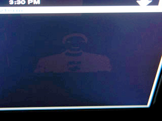

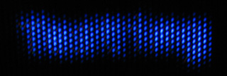

Back to the problems I (still) have with the set.. The five issues that concerned me the most, in order of most-to-least annoyance, were apparently not addressed/fixed in this particular update. To recap, these are:
1. Blue-on-black and Red-on-black "smear" / "blur"
2. Simulated "Burn In" when going from normal scenes to black screen (or even partially black screen).. effect can be lessened by turning down backlight:
3. Halo brightening effect with dark text on a light background:
4. "Sparkle" up-down subpixel effect
5. "Jittering" at the first of Harry Potter 5 Blu-Ray DVD, when they're doing the aerial pan over the park, particularly the road going horizontally across the top of the screen. I have no photo/video example of this, but it doesn't bug me nearly as much as the other stuff.
