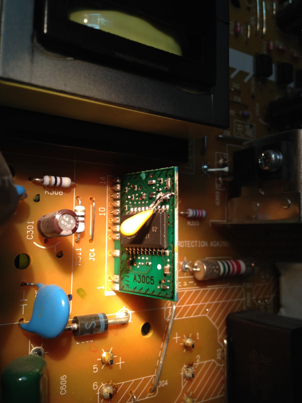

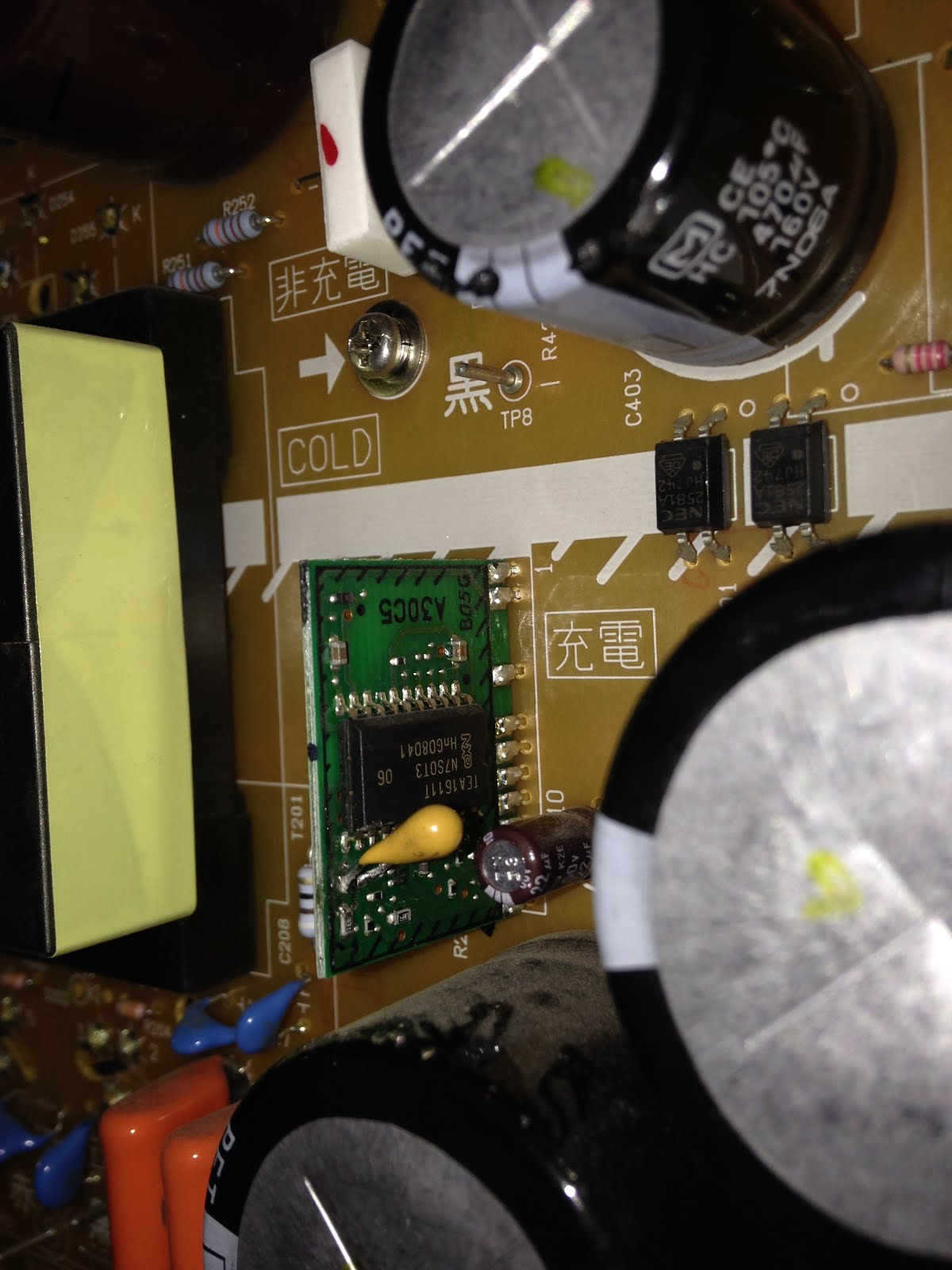

My friend donated his "broken" Panasonic th-42pz85ea with two blinks. After a lot of googling I came across this thread and I must admit I would have never have found the fault in those minimal 1uf capacitors.
I replaced the few caps on the power control boards with discrete ceramics and to my great disappointment, I got six blinks.
I disassembled the SC and the upper and lower drivers, metered them, but nothing was shorted. I proceeded to disassemble the thing several times, even grounding the SOS6 test point which made the display turn on but with no picture. After giving up I powered it on with the A control board disconnected. The plasma fired up completely white with some stripes that were easily fixed by reseating the SC board connectors. After reconnecting the A-board it started to display analog static. Success! It's been two days since the fix and it's still running strong. Perhaps the disconnection reset some register somewhere or just getting the energy recovery circuit running at full volume exercised the components enough to make it power on.
Thank you for the great insight!
I did notice that someone said that M301 is 15v standby but it's actually the Vsus controller, at least on this screen.

Most common problem on this model is the PSS board. http://www.shopjimmy.com/panasonic-n...06-p-board.htm
In order to diagnose this problem you need to take off the back and check for standby voltage on the PSS board with your meter. If you have no standby voltage (3-5v) then it's for sure the PSS board.
toohip is offline
