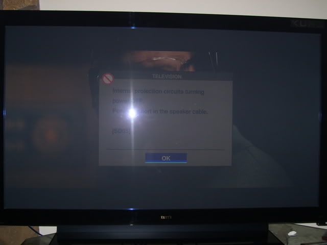

Originally Posted by chadmak09 View Post
Something strange is happening with my 151 every once in a while.
While watching a movie that has a loud burst of sound, the TV will display an error message and power itself completly off.
This has only happened about 7-8 times since I have had the TV, It rarely ever happens, and the Tv always powers back on, but it has me a little concerned.
the first time it happened, I went and bought some High quality Speaker cable and replaced the speaker cables going to the TV speakers.
So there is no short in the speaker cable.
It seems to only happen when there are extremly loud bursts in the movie.
I had it happen a couple of times while watching the blu-ray "Hulk". which has some VERY loud moments in the movie.
Today I was watching the Blu-ray "War" on my PS3, and it did this.
It happened in the movie when jason stratum was at the shooting range and the loud gunshots started.

I am going to give that a shot!
thanks.
Its been a really rough day ever since that happened this morning.
Been crying a little . Very worried about my baby.
You said it usually only happens during very loud parts of the movie, and even then it was only about 8 time or so that it has happened. So try playing the movie at a lower volume levels and see if it still happens. If it don't, then maybe you are just trying to play the movie louder than the TV itself can play it with no problem, and that the TV's audio amplifier section is going into some type of clipping or overload on very loud sounds. And that this warning about the possible shorted speaker wires, is maybe the only kind of message that they programmed into it to tell you there is something wrong in a case like trying to overdrive the volume output of the TV.
And if it turns out that is what it is, then you just are going to need to ramp down your volume levels a bit during action films with very sudden loud sounds. Or better yet, buy a surround system for when you want to rock the house with things like the loud explosions during a action film.

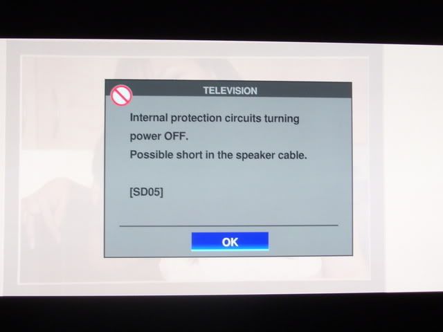

Hey guys,
The error message I get is this:
"Internal Protection Circuits Turning Power Off... Possible Short in the Speaker Cable"
The TV powered off and I decided to grab my camera, rewind the movie, and see if it happens again .
It Did.
So I have a couple snapshots of this happening.
here they are:
Have any of you guys seen this?
Just wondering.
I guess I will give Pioneer a call and see what they have to say about it.
