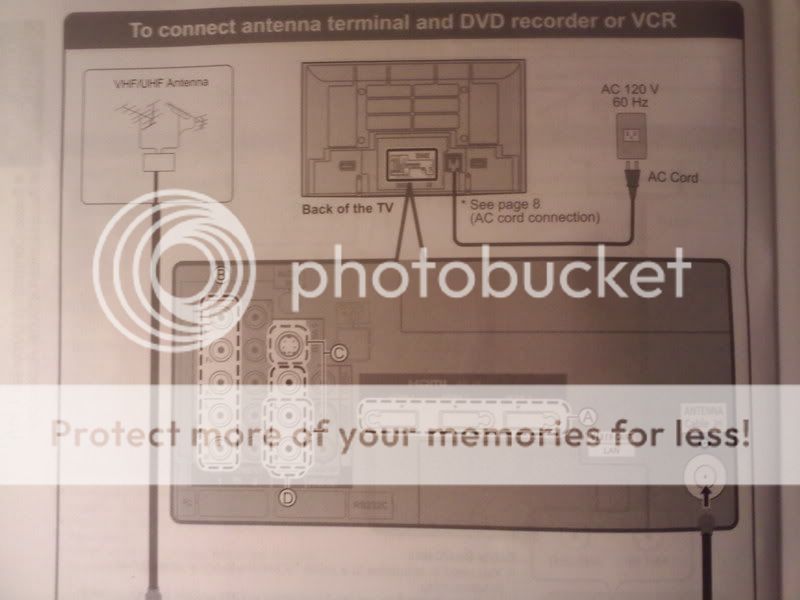

Having my 65pz850 serviced for a bad D board and the techs had the back off so I took some pics before they decided the job needed to be done in their shop. Should have it back to me tomorrow. Hoping for the best.

Well maybe it's for the best after all because the "fixes" didn't work and the plan now is to replace the panel. I'm trying to get panasonic to just ship me a new set but they are resisting and want to just replace panel. Service tech says it only takes 2 hours to drop in a new panel and will be good as new (SURE HOPE SO SINCE IT'S ONLY 3 WEEKS OLD). Guess I can look forward to doing the break-in thing one more time. Anyone know what the cost of doing this repair when it's no longer under warranty, say in 2 years. May have to think about a EW afterall.
