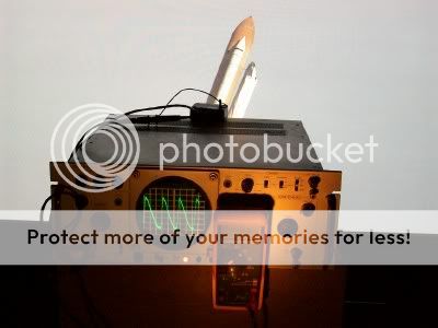

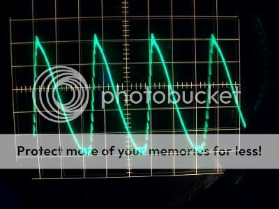

Mr. Blackburn, I present the following pictures as evidence that a photocell can measure refresh rate on a Pioneer plasma. These particular measurements were made on a PRO-141FD.
The Tektronix oscilloscope's sweep rate is set for 5 milliseconds. The Video source is a Pioneer 09 playing a 1080 24p scene from the Blu-Ray version of Digital Video Essentials.
Pure Cinema Film Mode Off 59.94 Hz
Pure Cinema Film Mode Advance 71.93Hz

I have new information regarding the "Pure Cinema" mode refresh rates on the non-elite models. I've created two videos and put them on youtube:
http://www.youtube.com/watch?v=_Hmmb-RCfII
http://www.youtube.com/watch?v=vmPP-CwzHTQ

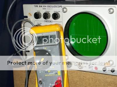

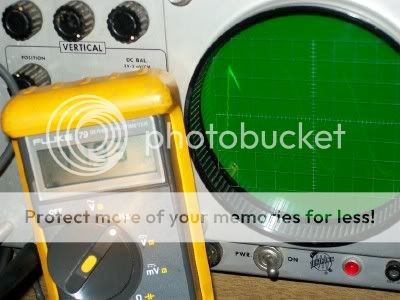

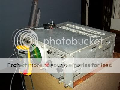

The videos show my 5020 in all of the "Pure Cinema" modes while being measured for refresh rate using a photocell device sent to me by Bogney Baux. I believe it proves that "Off" mode does not display the 24p effect and that "Standard" mode does not perform 3:2 pulldown when supplied a 1080/24p signal. These two items have been points of contention on this forum for awhile.
I've measured the refresh rates in all of the "Pure Cinema" modes with multiple input resolutions:
Advance
480/60i - 72 Hz
480/60p - 72 Hz
1080/60i - 72 Hz
1080/60p - 60 Hz
1080/24p - 72 Hz
Smooth
480/60i - 60 Hz
480/60p - 60 Hz
1080/60i - 60 Hz
1080/60p - 60 Hz
1080/24p - 60 Hz
Standard
480/60i - 60 Hz
480/60p - 60 Hz
1080/60i - 60 Hz
1080/60p - 60 Hz
1080/24p - 72 Hz
Off
480/60i - 60 Hz
480/60p - 60 Hz
1080/60i - 60 Hz
1080/60p - 60 Hz
1080/24p - 60 Hz
The measurements exactly match those of Bogney Baux performed on his elite model Kuro.

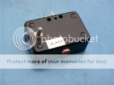

I will admit that I was a bit skeptical when I saw the simplicity of the device. After seeing how it works and researching it a bit however, I'm convinced that it is giving an accurate measurement of the refresh rate. Cinematographers and audio/video engineers have been using devices like this one for a long time to measure refresh rates of TV's, monitors, and flourescent lights.
Thanks to Bogney for sending me the parts and telling me how to assemble them.
Comments and questions are welcome.

480/60p - 60 Hz
1080/60i - 60 Hz
1080/60p - 60 Hz
1080/24p - 60 Hz
Thanks! That's obviously what we'd all been suspecting. Very good to know. I guess we have to choose between 72 Hz and modified grayscale then.
