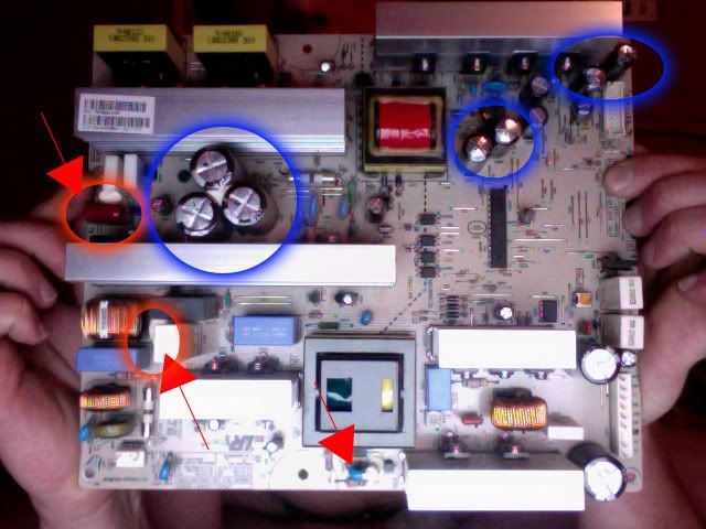

Hello all,
I found this page stumbling through google, took my board out of my VP322, and now i am at a standstill. I see that there are "tubular" capacitors that are bad (2 small ones bulging, 2 med ones bulging, and 1 large one is leaking, but there are also 2 round blue ones that are leaking, and a rounded squarish orange one that is leaking. I can post up a picture if it helps to identify these parts.
My biggest problem is finding the new capacitors, i literally have no clue how to find them, but if i could find them i would be able to replace them. Can anyone help me ID these broken caps so i can get new ones?
here is a basic picture until i can find my digital camera
oldskoolveedub is offline

The 4 capacitors on the upper right, in the blue circles, are failed and need to be replaced. The others I can't see real well but why do you think they are leaking? The white goop is silicone applied at the factory for stability, that's not a sign of failure. The three electrolytics in the blue circle actually look fine too, they are not bulging. You can replace them if you want, they will fail someday. The orange/red square capacitors are MPP's (metallized polypropylene), they pretty much can't leak and almost never fail.
If you post some other pics I'll look at them but I'm almost certain all you need are the 4 on the upper right. They are available at Digikey, Mouser, Newark etc. See the post immediately before yours, those are the ones you want (confirm the values and voltage ratings and when you put them in make sure you pay attention to polarity). Let us know how it works out....
