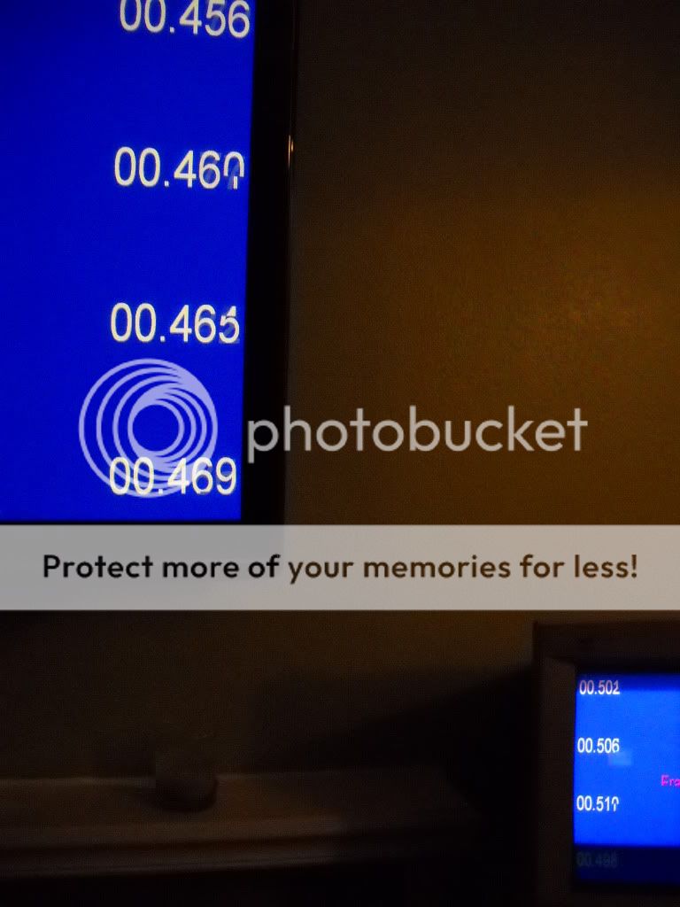

cleh19 did some tests on the Samsung 50B650:
http://www.avsforum.com/avs-vb/showt...2#post17298562
quick results -
80-100ms in non-game modes
30-50ms in game mode
NOAMattD is offline

Used a different laptop to re-test the G10 for a baseline, and also tested the S1 for the first time. Did these back to back with the same settings. Also discovered some very important information on testing procedure, I'll be updating the OP to reflect this.
Anyways, results were very unexpected--they do not seem to be the same like I would have thought. G10 measured 10ms-20ms almost every time against this laptop--across like 20 pics. S1 measured 20-30ms across the same. My camera is crappy, so this could be something flakey with it if that's even possible. More likely it's a difference b/t the G10 and S1 in general or a difference between the size classes, G10 is 50" S1 is 65".

this is with aero disabled, HDMI input labeled as PC, picture set to game mode, aspect ratio just scan. and any other option that would add processing time set to off.(wide gamut, dynamic contrast etc)
50PK550
weird? it varies between 40 and 90, perhaps I should use something other than web based timer? I don't understand what could cause it to do that. I will make a video!

I ran tests on my Pioneer Kuro 5080HD (2007 model) awhile back but I want to do it again to be sure my results are accurate (based on new info Ive learned on testing input lag) I was seeing around 30-35ms lag (avg.) between several shots I took with my PC hooked up via HDMI, TV was set in PC mode. (used my FW900 CRT as a baseline).
Ill post pics when I run the tests again (soon).
UPDATE: My CRT died only days after making this post just in case anyone wonders why I never ran tests again, I dont feel comfortable testing with an LCD as a reference, I hope to get the CRT fixed in the near future (Sony GDM-FW900).
