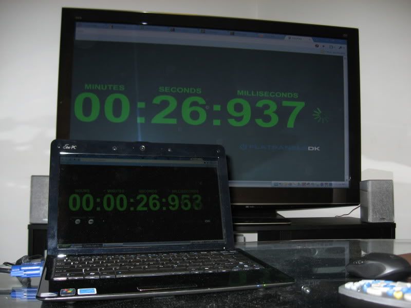

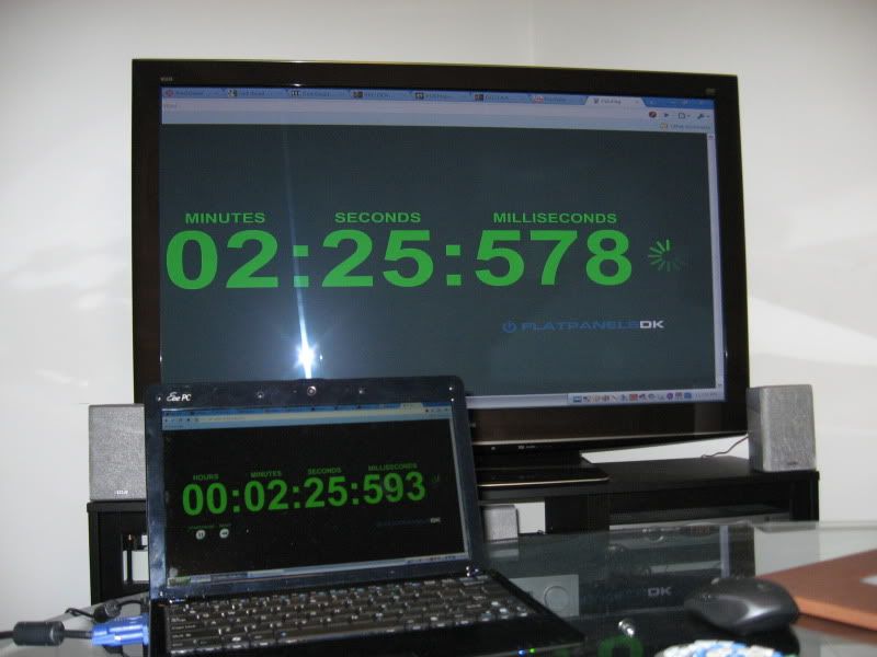

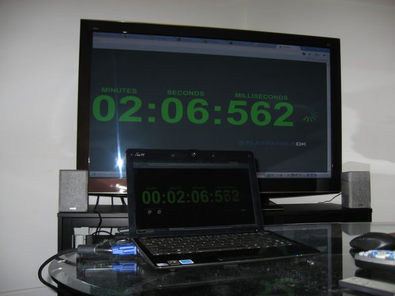

Anyway, I did an input lag test on the Panasonic TC-P54VT25 using a laptop as a reference. I don't know what the input lag on the LCD for the laptop itself is, so this will just have to be a preliminary result.
Anyway, here's what I've got:
37 vs. (somewhere between 37 and 58):
62 vs. (somewhere between 62 and 78):
78 vs. 93:
So it looks like about 15ms different from my laptop LCD.
Also keep in mind that the plasma was about 4 feet farther from the camera than the laptop. Due to the fact that the light being emitted from the plasma had to travel an additional 4 feet, it's lag time was unfairly increased. As such, please subtract 4.07ns from any input lag results gleaned from this test
Also note that I had a little bit of trouble with resolutions... my laptop (well... netbook really) couldn't output in a standard resolution recognized by the TC-P54VT25, so I had it outputting in 1366x768. The way the TV handled this was by simply cropping the image down to 1280x720 (I think), and then scaling it to 1920x1080. So maybe the TV's resolution scaling and the laptop's inherent input lag cancel out???
What I really need to make this test accurate is a laptop that can output 1920x1080 and a CRT.
I guess we'll have to make due with this for the moment.

Originally Posted by JRod0802 View Post
Hmm.... sure wish I still had one of my old CRTs! (I never thought I'd say that...)
[IMG]http://i42.photobucket.com/albums/e329/JRod0802/IMG_0249.jpg[/IMG
[IMG]http://i42.photobucket.com/albums/e329/JRod0802/IMG_0251.jpg[/IMG
78 vs. 93:
[IMG]http://i42.photobucket.com/albums/e329/JRod0802/IMG_0253.jpg[/IMG
Thanks for the test JRod, added to the OP. Your results seem to mirror what I got on the G10 with a flash timer and low end laptop (integrated graphics).

Here's the link to their 2009 results...
DDay "The Best Gaming TV Test 2009 edition" - results on page 2
koffas is offline
post #107 of 801 Old 07-05-2010, 07:20 PM
AABBCCAA's Avatar
Join Date: Aug 2008
Posts: 54
They are using a Notebook for their tests, and windows aero seems to be activated in those pictures.
On top of that, they are using a simple flash based timer and only take 3 pictures for each mode.
Might as well roll a dice to see which display performs the best.
AABBCCAA is offline
post #108 of 801 Old 07-05-2010, 07:55 PM
koffas's Avatar
Location: Silicon Forest
Posts: 974
True. It's not clear to me how they control for the lag on LCD screen of their notebook (set in clone mode). In that case, at best, the results give a relative comparison, not an absolute figure.
But they say (via a google translation):
"We do not know if the HDMI output of your notebook has a few milliseconds later than the display, but being the source the same for all tests, it has no bearing on the results."
koffas is offline
