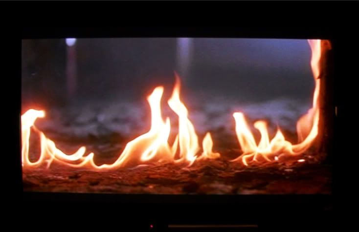

Against my better judgment, I'm gonna throw a couple pics up I took. They didn't turn out as well as I'd hoped, and the picture definitely looks better in person. I'll just feel better about myself if I pretend the time I spent taking them wasn't a complete waste of time.
From my P42U1
DVD in 480i:
Backdraft
Collateral
DVD "up-converted" to 1080p:
Gladiator (watching this movie on the big screen sure is a treat, Last Samurai and LotR series, here I come!)
Dark Knight
