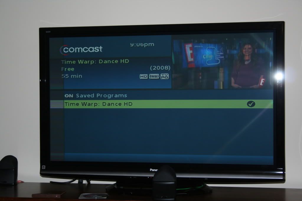

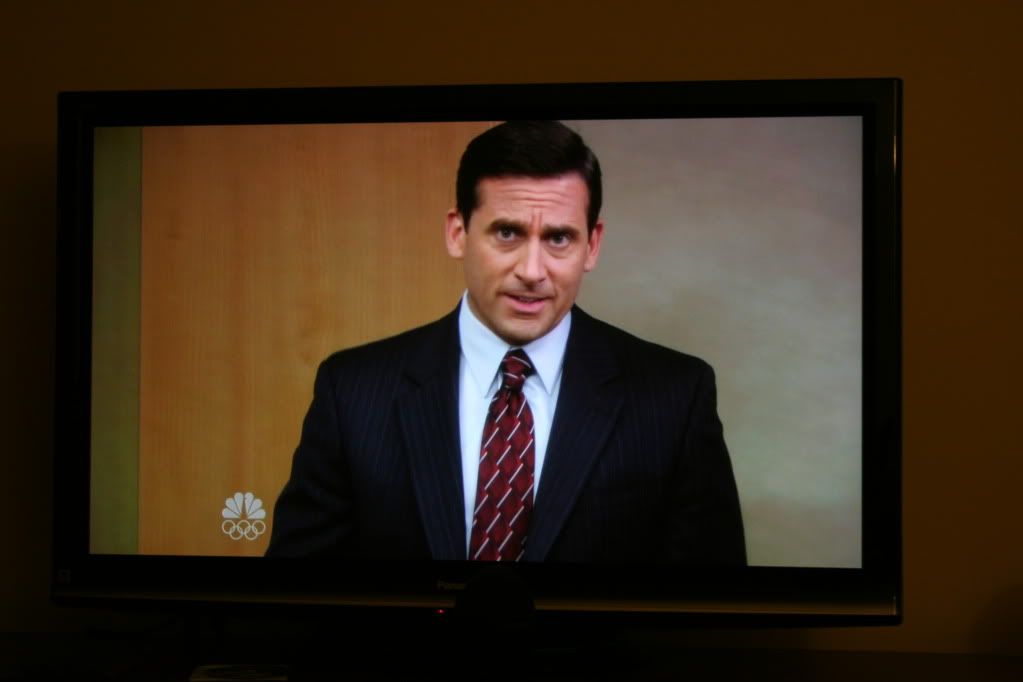

It had the same issue tonight. Here are two pics

I'm not an expert but that could be something simple like a loose connection on that part of the panel, or something more serious like a bad panel or one of it's integral video boards. I presume that bar also covers the on-screen picture setting menus? This is fairly rare defect on a Panasonic.
I'd press for a replacement, but they'll probably want to send a local technician over to diagnose it and possibly fix it himself.
