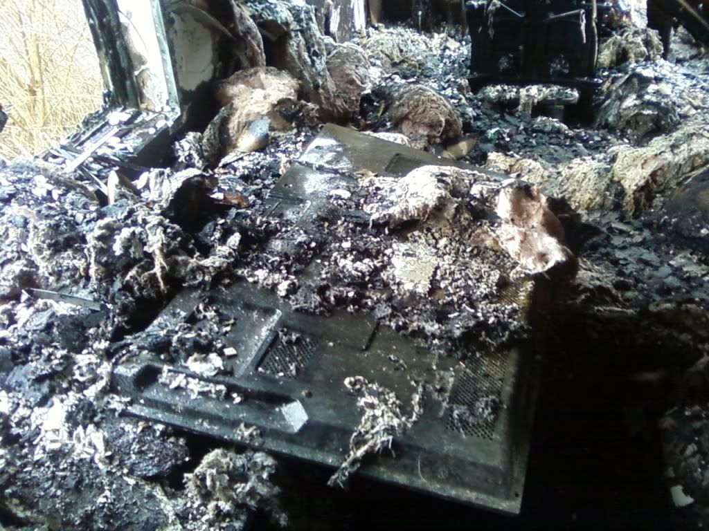

post #1732 of 1734 Old 06-20-2014, 07:46 PM - Thread Starter
PENDRAG0ON's Avatar
Location: Missouri
Posts: 9,490
Liked: 579
Originally Posted by PENDRAG0ON View Post
This will be the final picture I post of my 50c450. PM me if I need to update the first post.
Hard to believe this was over 3 years ago... Still think about it every now and then but the past is the past. Still, one funny thing, Samsung may have outlasted Panasonic in the plasma market, but only a Panasonic survived that fire.
PENDRAG0ON is offline
