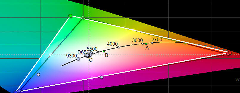

Originally Posted by TiVoHD View Post
Rather than have people post calibration settings in the general owner's thread where they'll get buried, I figured I'd start a new thread specifically for calibration settings. I figure it makes sense to have people post their settings for both the D7000 & D8000 models since they essentially use the same panel. If anyone tries any of the settings that are posted here, please report back. It will be interesting to see how well the settings transfer between individual sets and sizes.
My PN64D8000 was calibrated by Gregg Loewen from Lion AV. He did a great job and kept me informed about what he was doing every step of the way. The gray-scale and colors ended up spot on.
Here are the settings that I ended up with after the calibration. I've also attached the before and after charts for reference.
Those charts are very impressive! How long did it take Gregg to dial the display in? Did you have him work on 3D? Your basic settings look similar to what I'm using on the 59D7000. Gamma = -1 is perfect at night. I have gamma set to 0 during the day. I've increased sharpness for DirecTV, but have it lowered to 0 for high quality (bluray/1080p) sources.
