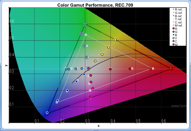

I made two attempts to follow your procedure. I am using CAL-Night with color and grayscale at defaults. Gamma +1 (59PND7000). Color and tint adjusted with blue only mode (46, 52/48).
Trial 1: Used the emulator to calibrate ADC and make ADC/WB adjustments, ALL in movie mode (with factory resets). Set blue and green gains to 110, 90 in ADC/WB. HCFR result (CAL-Night, cool tone): red gain at 140%, luminance spread, gamma lower than expected.
Trial 2: Reset both Dynamic and Movie ADC/WB to 128 using emulator, factory reset. Entered SM using normal remote control (Mute-1-8-2-PWR). Performed ADC calibration with 1-235 pattern (via 4:2:2, result 130/73). Factory reset. Entered SM again with normal remote and set ADC/WB (110, 90). Factory reset. HCFR result: red gain still 140%, luminance tightened, gamma 2.2 but sloped.
Results attached. What am I doing wrong?

You don't need to re-calibrate the ADC every time, just leave them at 130/73.
I didn't say you should copy the 128-110-90 settings!
Ok, so:
1: Enter the SM (no need to use the Factory key in the emulator, use your IR remote).
Opcional: Calibrate your ADC if you haven't done so already (and do a factory reset if you re-calibrated or manually changed the ADC Results!).
2: Reset the WB settings to all-128 and use your color sensor to set the white point to D65 on a 100% window pattern by lowering only two of the Gains (leave the other six at 128 and do not increase anything above 128).
3: Exit from the SM with a factory reset, switch to Movie or Cal-Day/Night and select Cool, set the Sharpness to 0 and disable any other "enhancements".
4: Now you should have the white chromaticity close to D65, so you can skip the 2p WP and make some small adjustments with the 10p system. (But you should not increase the xxx-Gain you kept 128 in the SM at the 10/10 point of the 10p).
5: Skip the Color and Tint, use the Custom color space. (I recommend 100% level window patterns instead of 75% level.)

So has anyone else measured the saturation tracking on their D7 or D8? The dE vs. saturation calculations in HCFR are incorrect so I used the spreadsheet available in this thread.
After calibrating color using standard size 100% luminance windows I ran the saturation sequence with the following results.
Note that the 100% saturation points (which are also at 100% luminance) that were used for calibration look fine but there is a severe kink at 75% saturation in green and magenta and oversaturation in cyan. Red is also undersaturated and has a too-high luminance. These produce dE errors > 6. Has anyone else seen this non-linear color behavior? I don't believe it's the color decoder because when adjusting I noticed that the luminance control in the CMS (Red/Red, Green/Green, etc.) changes the saturation as well as luminance so these things are coupled which will lead to non-linear behavior relative to the white point.
zoyd is offline
I have that spreadsheet, have done 75% sat calibrations, and it is very laborious. Some say that calibrating at 75% saturation is the way to go, but since none of the software products that I own have that capability and the AVSHD disc has non-APL 75% sat windows in the ColorHCFR section ...
Maybe some of you guys with pattern generators and accompanying software can do this?
kjgarrison is offline
I was wondering if the Green/Magenta "S" curve is typical of these displays or if I've got something set wrong? I can put the 75% saturation point on target but it just moves the curve over and creates errors elsewhere.
zoyd is offline
