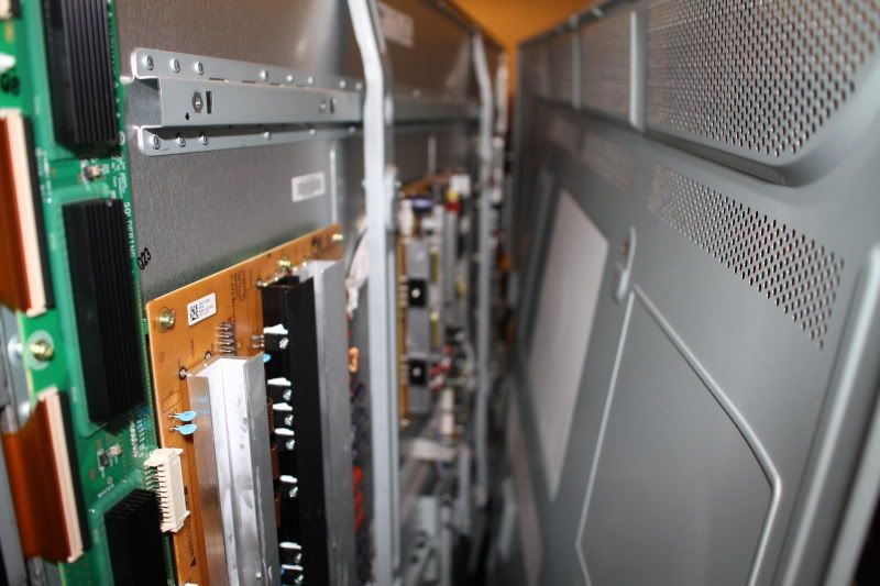

Took a stab at it. No dice. I can't seem to find anything that would turn. And I cannot fully get the back of the TV off. It stays stuck by the connections part. No idea why. As far as i can tell there is nothing to turn. I don't think this works with our set.

Take pics of what your turning. As I'm finding nothing to turn. Also. How did you get the entire back panel off? Mines stuck where the connections would be.

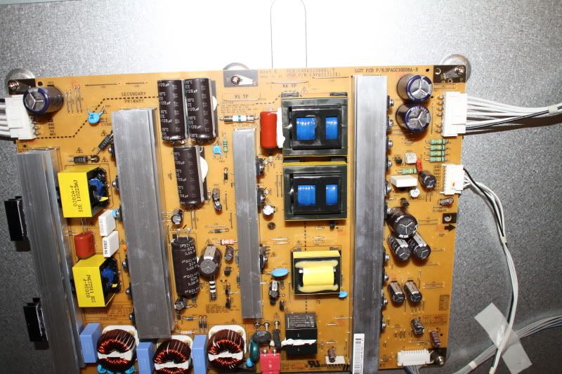

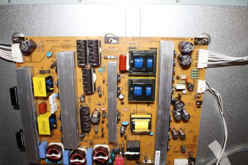

The Vs pot is on the main power board in the middle...there will be a cross pattern on the pot with 2 little holes...around the cross pattern there are lines for guides or markers...i used the holes to markwhere they met the lines for stock settings and notched it back counter clockwise one bar back...i used the hole that was closest to the top marker as set point....so if you count the lines itll be 3 lines from the top matched with second hole....if you look at it from stock settings the 2nd hole should be marked up to the forth line....so move that hole to the 3rd line counter clockwise....again ill post up pics as soon as i can on what i did and the after results...widscreen bluray 2:35:1 black bars blend with movies and black bezel...very very happy

^^^The picture right above this sentence is the spot of the TV I can't get off.

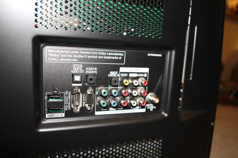

@jukebox theres 2 screws where the component conections are in order to take off the panel
sarge19806 is offline
post #286 of 852 Old 09-27-2011, 05:18 PM
sarge19806's Avatar
Join Date: Aug 2011
Posts: 43
One screw under the av connections and the other under the first component connections

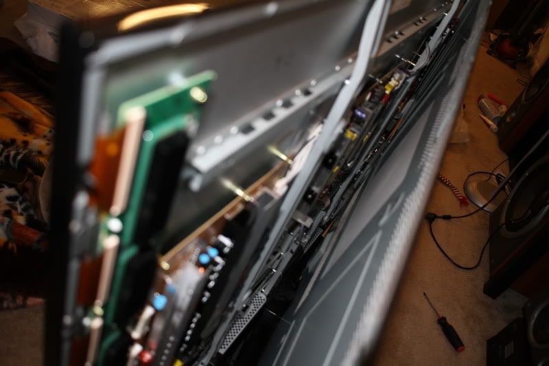

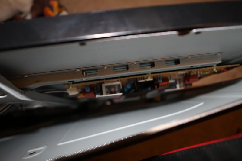

The manual helped. I didn't see to of em. Dam things hid in there perfectly. Before I start to turn anything I'm going to take another snap shot and ask what i turn and how I turn it before I do so. I really don't want to break this set. lol

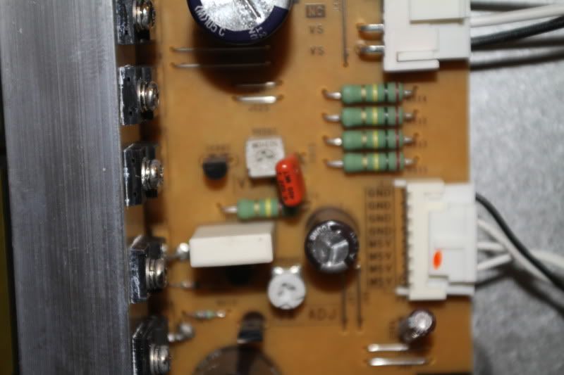

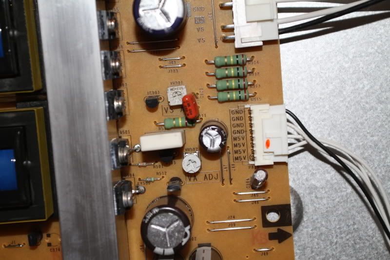

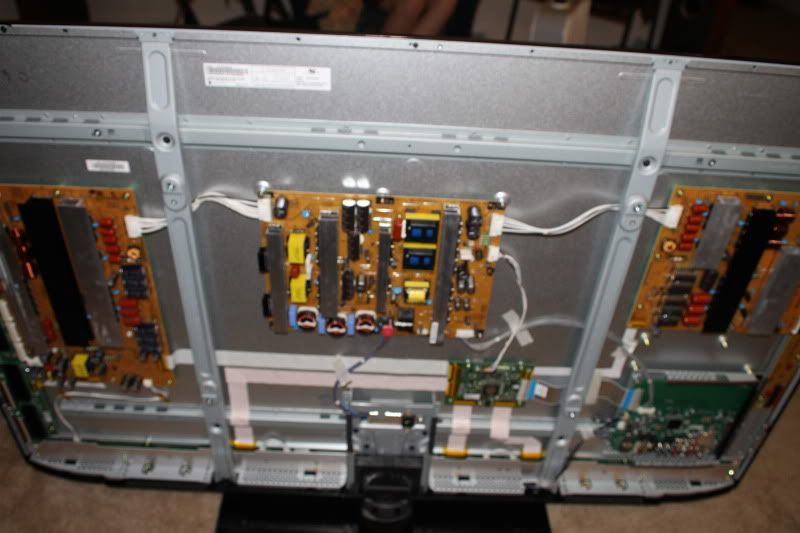

Something tells me I'm looking at the wrong spot?
JukeBox360 is offline
post #292 of 852 Old 09-27-2011, 05:31 PM
sarge19806's Avatar
Join Date: Aug 2011
Posts: 43

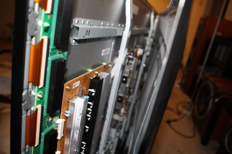

Ok...you will se 3 main boards the y board is the one all the way to the left there youll see white tuning pots the one closest to the middle main board will say set_up you want to turn that clockwise till you cant anymore.....thats it for that...now the middle main board there will be the Vs pot itll be the closest to the top of the board itll say Vs on it...now you want to turn that counter clockwise in line matching the last hole on the right...so 3 bars and hole should line up...thats it your done...make sure that you have calibrated it...before doing it to get the best results...

All those pictures are great...and correct...your looking in the right spot...remember the set_up pot is on the board to the left and the Vs pot is on the middle main board

I turned one of em. Now I'm on the middle. Cant find it. I see VA ADJ or something like that. That what I turn? It's a very small screw.
Vs is just above that, thats the one you want according to sarge.....
lifesun is offline

All done. Sarge was a HUGE help. I will confirm this indeed DOES make a difference in blacks. No. It isn't KURO blacks. But it's way better then it was before. Before the blacks were pretty much grey. Now, these are actually black. Just not inky. I'm taking some more pics. Will post once done.
