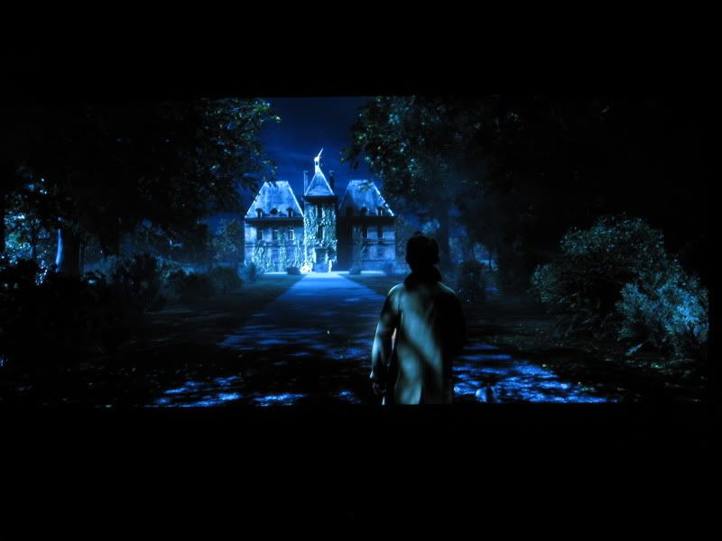

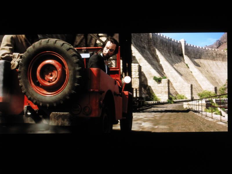

I know we do not have Kuro blacks, at least the top tier but the tweaking has more than satisfied the urge to jump ship.
When I was getting into the plasma race I wanted a Kuro and coming from a 28 Sony I was looking for a 42er but none were left to be had thinking that was big enough, silly me.
Anyway watching TinTin again this evening I got that Kuro feeling until the lights went on and remembered it was a LG we were watching.
Shot with a Canon G10

Been tweaking for a few hours earlier (yep, again), finally put the cover back on because I reached satisfaction. The blacks are deep and mix with the bezel in the dark, I believe it's the best I can get on this set.
The green pixels are present for the first 5-10 minutes of warm up on a cold start up. But from my viewing distance I barely distinguish them in the dark areas.
A very small compromise considering the quality of image I could attain ..
PS: very Kuro-like pictures 8)
