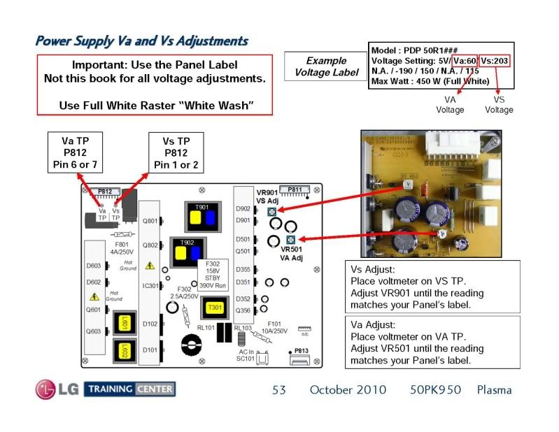

The Set_up is clearly indicated in the service manual as the main adjustment for the APL and will probably vary from panel to panel in conjunction with the minimum voltage required for pixel (panel) discharge, while the other pots affect timing etc; most are realizing that one voltage adjustment has consequences on an other in order to achieve the deepest black without introducing pixel misfires or other artefacts.

Location: CT USA
Posts: 54
Got a chance to make some adjustments, not trying to max out because of my inexperience at this. I'm quite certain that my blacks have improved and didn't notice any picture issues (again not the best judge here). Went short of full for VA and VY and it semed I could max out Set Up but dialed back some. Made 2 slight adjustments to Set Dn but didn't see much and decided to back up a bit because I didn't want to lose my gains.
Will keep watching but football soccer ice hockey all good and "planet earth" great BBC nature documentary looked stunning as it should. Thinking about raising my brightness a tick, but maybe not. So this particular 50PV450 needed help and got some.
Thanks guys. And thanks to my wife for the lifting!!!
Jimdish255 is offline
post #198 of 1476 Old 11-26-2011, 04:40 PM
lifesun's Avatar
Location: Michigan
Posts: 494
Originally Posted by losservatore View Post
I did full clockwise without a problem.The tricky part is in the set-down.
turn "Set_Dn" clockwise untill you get pixelmissfires. Turn a microamount counterclockwise untill you dont' get new pixelmissfires.
In 60hz the black levels can go even lower turning clockwise little by little the set-down,that's if you can leave with two or tree pixelmissfire in 60hz,but when you change the settings to 24hz the pixelmissfire wont be there anymore and you will get better black levels in 24hz
This depends on what model you are working with. I have a pv450 and followed this advise based on the 950 thread and had to take my set back off the wall and readjust. I had adjusted the pots while in 60hz mode and it looked great, however in 24p mode with bluray I had misfires all over the place, mainly green. So I ended up sacrificing lower MLL in 60hz material to have a stable 24p picture.
lifesun is offline
post #199 of 1476 Old 11-26-2011, 06:39 PM
xrox's Avatar
Join Date: Feb 2003
Posts: 3,204
Liked: 57
Originally Posted by rob80b View Post
Hi Chad
My biggest concern is that I’m seeing folks jump right in without fully understanding the technical consequence of each adjustment, each panel has been measured by LG for their optimum voltage and the VS (highest voltage) and VA (lowest voltage) is marked individually on each set.
I've not read the manual but it actually says this?
From my understanding of PDP driving the following makes more sense:
VA = Voltage Address = bottom electrode of cell (vertical)
VS = Voltage Scan = top two electrode(s) of cell (Horizontal)
Set_Up = Reset/Initialization ramp up waveform
Set_Down = Reset/Initialization ramp down waveform
The Set_Up should produce a strong discharge that essentially overcharges all cells and then the Set_Down produces a discharge that removes the charge to a value that is well below the discharge start voltage. At this point all cells are "reset" or "initialized" and ready for addressing.
Messing with Set_up/down messes with both the wall charge and priming electon generation which both affect pixel control.
For proper panel illumination, I would believe that if there is a bit of tolerance to achieve a deeper black outside the factory configuration, then it would only be a matter of proportionately increasing the wave-forum size and timing, within certain limitations of course, and could be easily dialed in with proper equipment, an oscilloscope and voltage meter to be specific as I mentioned earlier on when starting this thread.
As it stands now the majority are doing it on the fly with hit and miss results.
Another concern when I first picked up on this was the effect on the gray-scale, color and the gamma which I believe is LG's strong point but from tweaking my PG25 it looks as if only the MLL was affected which is good thing. I'll be practicing on the PG25 a bit more before dialing in my PX950 and most likely to use a scope in aiding the process.
Like I tried to state in the other thread, when you adjust the "Reset" waveform (ie - Set_Up/Down) you have probably put the panel into a condition where under very specific circumstances (APL, temp, pixel on time, age..etc) some pixels will lose all control and either fire or not fire when asked to. In other words, your panel will work perfectly fine (with the lower black level) until a specific condition is met (even for a moment) and then you may see misfires.
This is due to many factors such as dishcarge delay, discharge probability and wall charge bleed that are all directly addressed via the "reset" waveform.
Over thinking, over analyzing separates the body from the mind
xrox is offline
Hi xrox
I mentioned the VA and VS as you stated above in another thread, I was trying to simplify the initial voltage driving the panel but I like your explanation.
Robert
Toronto, Ontario
rob80b is online now

Now if I may take the liberty of quoting the first post. from http://www.hifi-forum.de
Poti tuning of the LG-PK series - the right way to Black
http://translate.google.com/translat...-141-2177.html
"Here I wanted to, because there are no separate thread for this, one just to make the tuning potentiometer, the LG-PK to treat screens ...!
Here the guidance of Marc Wessel:
Now that I've continued experimenting with multi-meter, I can tell you that it follows at least in my Panel->
First Vs. leave it where it is (the ten to 12 hours I could have saved me)
Second Va clockwise until it stops
Third VZB eighth turn clockwise
4th VSC first turn counterclockwise until it stops and then a quarter turn clockwise
5th Vy until it stops turning counterclockwise
6th Pick a movie scene that is full-frame (ie without cinemascope, zoom in doubt easy!) And a cloudy sky at the top of the screen and has (or a snowy landscape.
Turn SET_Dn so long in a clockwise direction until you get strange-looking beige vertically oriented noise pattern.
Then you go counter-clockwise back to exactly the point, these noise bars disappear on the back!
7th SET_UP turn clockwise until you get blue, red and / or green pixel misfire.
Turn counter-clockwise back a touch delete the faulty pixel with the ColorWasher and see then whether it comes back to pixel misfire - if yes, run by the same procedure again.
Repeat this until you get no more error pixel.
Actually done, but you can still try further:
8th Now you can still use Vy for fine adjustment and it goes like this:
Turn SET_UP far so clockwise, until you get back but light and small backfires.
Vy then turn in one 16teldrehung Uhrzeigerinn delete the faulty pixel with the ColorWasher and see if the misfire occur no more. If it does, another six-tenths of a turn clockwise with Vy.
If at the end instead re-appear vertically oriented beige bars of interference, it is not worth it to give up potential for Set_Dn and instead simply Vy You turn back counter-clockwise until it stops.
Done. Watch the best the next day as normal remote, to ensure that indeed no artifacts appear before you screw on the TV again."
Robert
Toronto, Ontario
