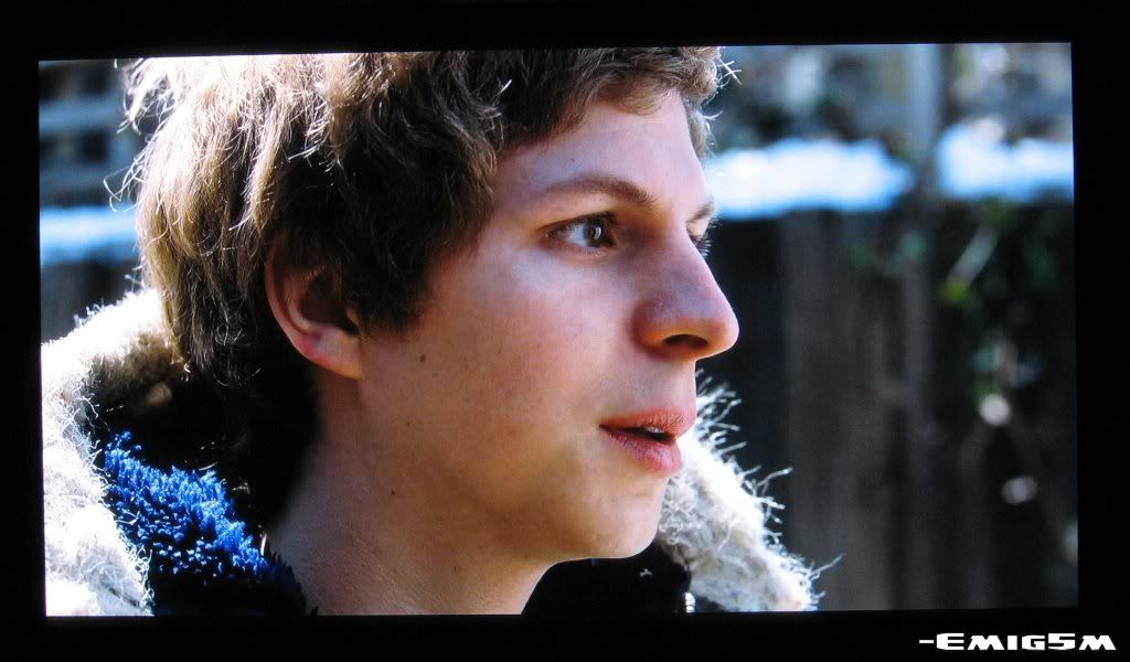

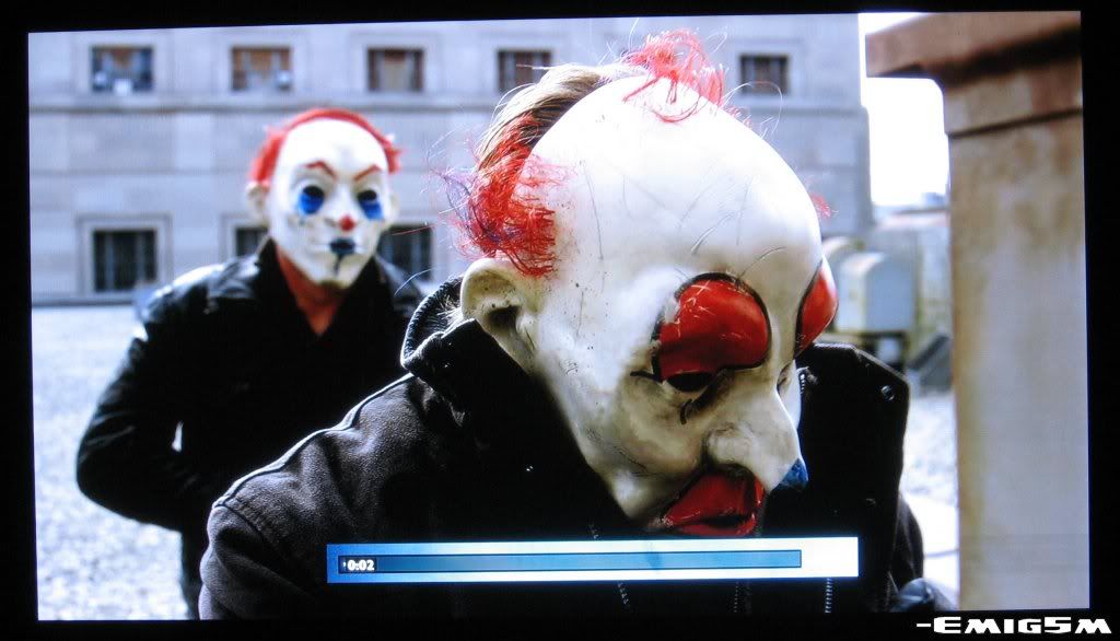

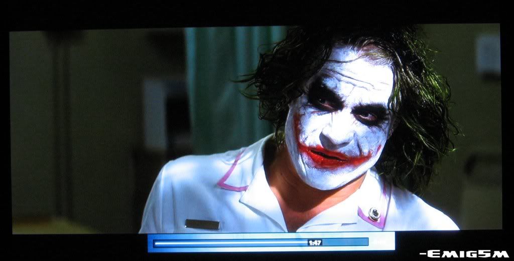

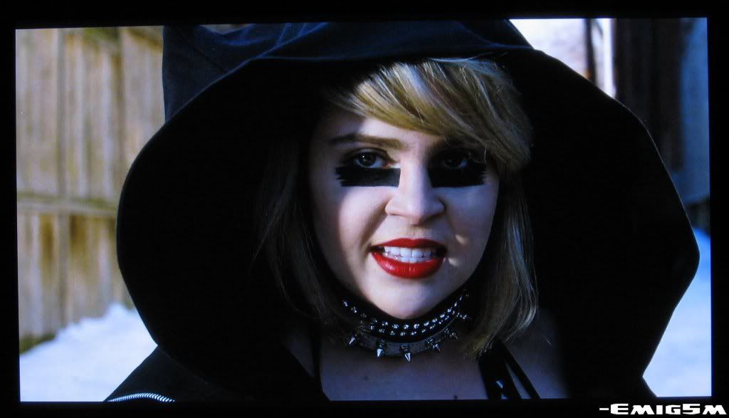

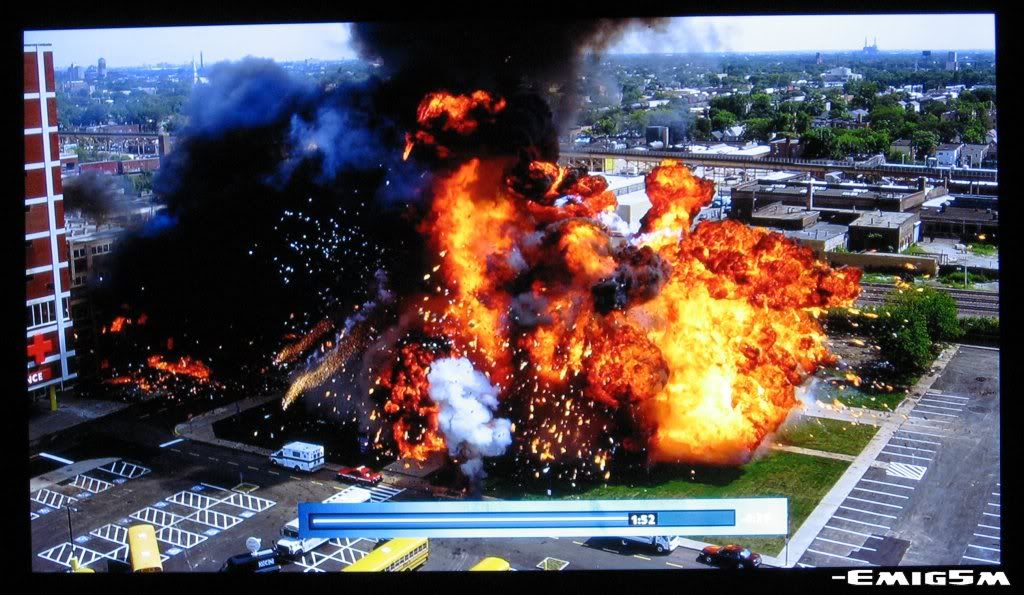

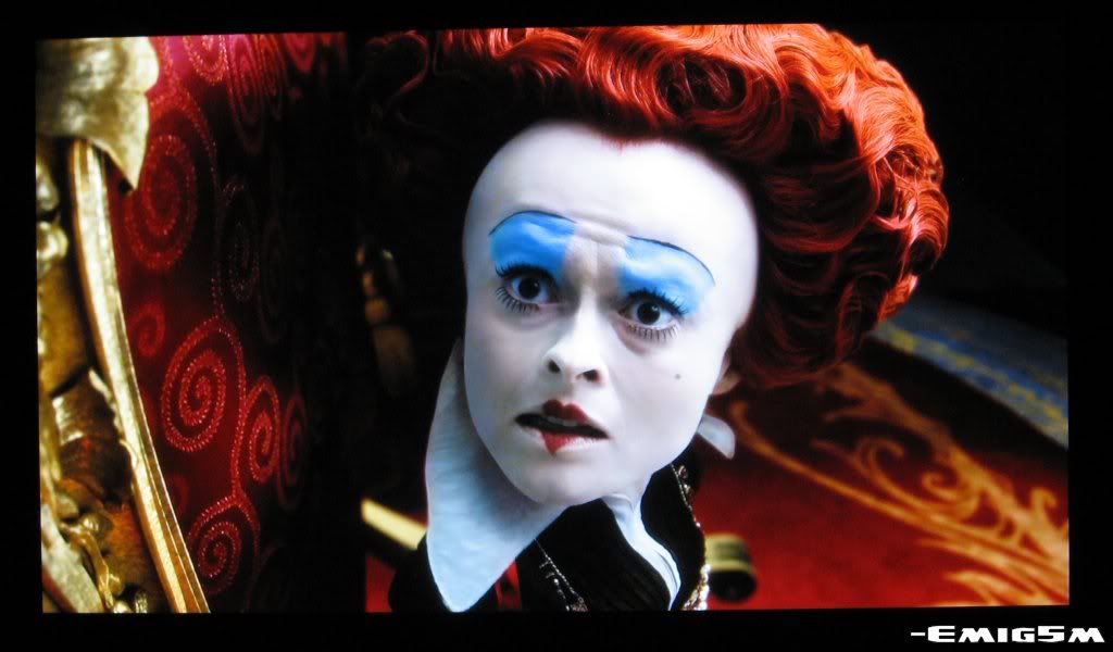

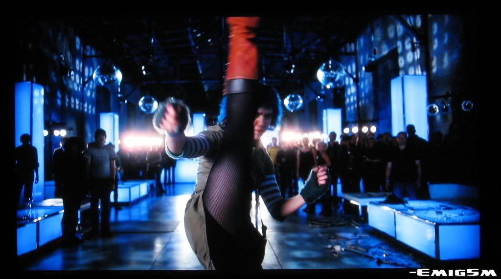

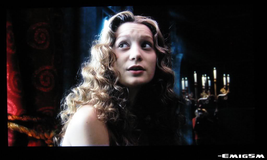

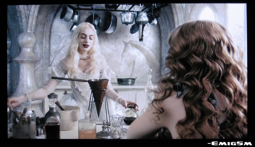

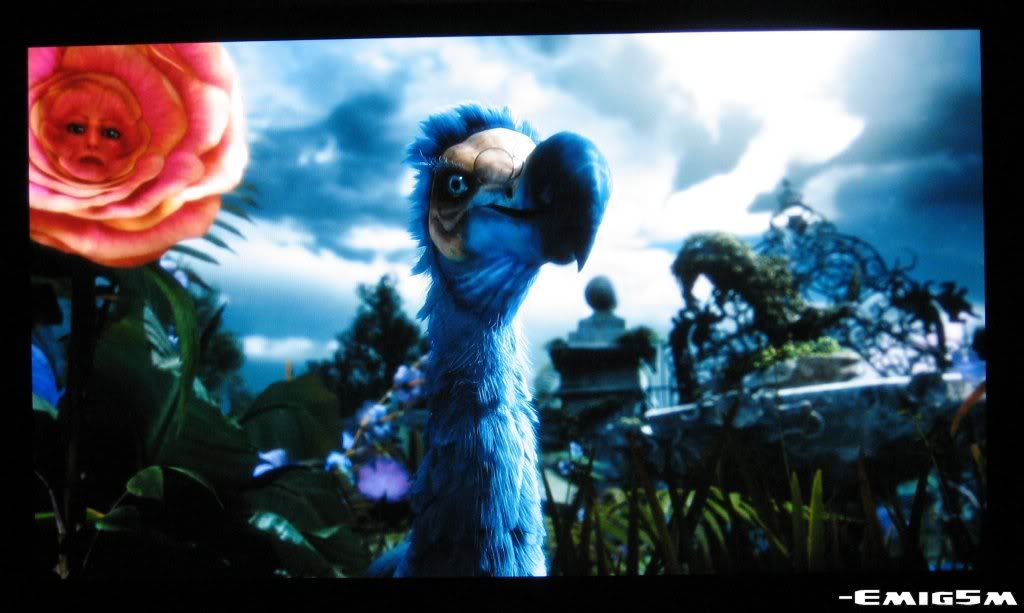

Do the initial setup using the Picture Wizard. It should save to Expert1.
Now go into the Expert1 menu and then scroll down to and enter Expert Control menu. Scroll down and change White Balance to Cool.
VoilÃ*, LED bright whites!
Now if that doesn't work, you might just have a bad set. I got a bad LG plasma last year that was very dim regardless the settings. I exchanged it for the same model and the second one was fine. Here's a couple photos I took of it:
If that isn't bright and vibrant enough for you, I don't know what is! That's a LG 50PK540. My 60PV450 is capable of the same exact image quality.
