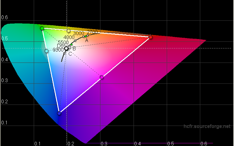

My color accuracy were gone because of the green sparkles. I had a green tint in shadows and a little banding. Also magenta was a bit much and the overall saturation looked to much, like a sunburn (not as dramatic as it sounds).
I tested the troubleshoot picture (the beach pic) and could see some missfiring in the upper right. I don't had any missfire on any other pattern or image. So this is a good test.
I reopened again and find out that "Ve" depends on "Vs". When Vs is at 207 Ve is at 80, when Vs is at 201 Ve drops to 77. So I put my Ve back there it was before tweaking. I now have my colors back with this setting:
Vs=203
Ve=78
Va=58
Vsc=-182
Yrr at about 00:30 to 00:45

The color accuracy on my display in both gray scale and color material was perfect before the voltage/timing adjustment and is perfect now. I made extensive measurements of these and confirmed visually. I did not have to do any special adjustments of voltage levels. The tweak only effects mll (by lowering the pre-discharge energy) and the probability of misfires, it does not affect the luminance of colors. Calibration results below.
zoyd is offline

Maybe it's something with the bad D6900 sets or maybe had something to do with different ABL activity before and after the tweak.
When I use the Burosch test pattern for contrast the grey rectangles on a white background were greenish with the wrong voltage/timing.
Edit:
Ehm, after I put my set back together, it is again over saturated. I didn't change anything in the settings. The only thing different is that all 3 HDMI cables are on, as it was open I only had my PS3 on. How is this possible?
