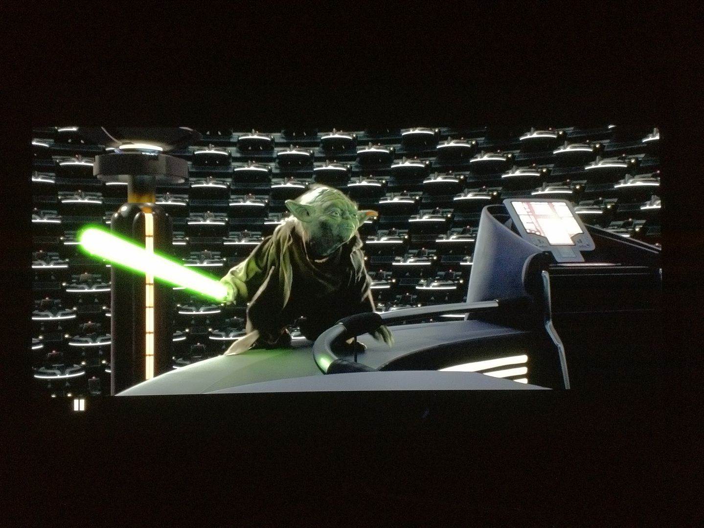

Here is another measurement of the improvement highlighting the performance with real material and measuring the black bars during 2.35 material.
pre-tweak
post-tweak

Oh yes, it was immediately noticeable. Of course it makes the most difference at night with dim lighting but even in the daytime the entire picture is deeper and richer. I've never owned a panel with this black level but I can assure you I will never settle for less from here on out. Very addictive to watch.
I've borrowed a very sensitive detector to nail down the true mll and will post some measurements later after it gets a bit darker.
