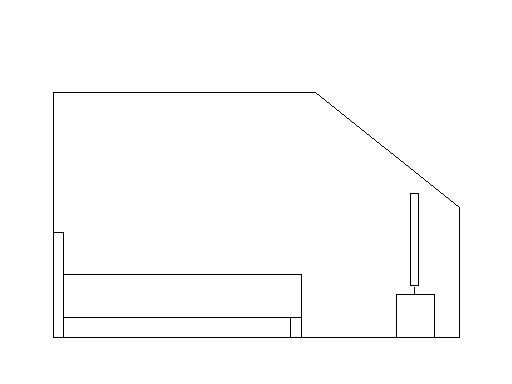

I'm working with a couple to redesign their media room and bedroom. The TV in the bedroom is currently on a short stand at the foot of the bed. The stand is so short (and as such uncomfortable to view the TV from) because the wall it's on is below a dormer that slants into the room at around a 45 degree angle. They've asked me to look into if it would be possible to mount the TV directly to the slanted dormer wall. The key is that they want the option to push the TV back parallel with the dormer and lock it in that position when not in use so they maintain the walking space between the foot of the bed and the wall.
I'm looking for suggestions on how, or even if, this might be accomplished. I've seen plenty of posts about mounting to slanted walls, but none with the option to swing the TV back out of the way when not in use. This obviously takes building the dormer out to a 90 degree angle to the floor off the table, but I'm curious if there is a mount out there, or one that might be modified to get the job done. They're willing to do (and pay) what it takes to make it happen. Any and all suggestions welcome.

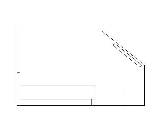

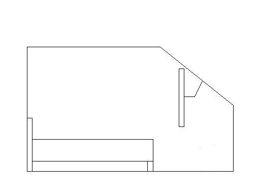

Ok, so here are a few rough drawings.
The first is how they have the TV set up currently.
The second is where they'd like the TV when they are using it.
The third is how they'd like to keep the TV when not in use.
Thanks in advance for any insight.

There is no way that it will stay pushed against the angled wall like that. What is the length and width of the room (ie 10x12, 12x14), not some drawing as a cut in of what you would see if this was a doll house.
As for at the foot of the bed, it would be better placing it in a cabinet and having it at the area in the first drawing. You can have rollers on the cabinet, that you can push it out of the way to store it when not using, and roll back if you wish at the foot of the bed. The other option is for them to turn the bed, but need a floor plan to see what the dimensions of the room is.

Yeah, the weight would pull it down buy if you could find a way to lock it in at the sides you could use something like this:
http://www.amazon.com/Unibrak-UNB-55...715738&sr=1-11
Possibly a metal shop could create a frame, or bar that extends beyond the tv's sides, that incorporates a strong gate latch, and attaches to the mount, then you could lock in at the wall and help support the tv while in the up position. Like this one: http://www.amazon.com/Stanley-808790...3716404&sr=8-4
