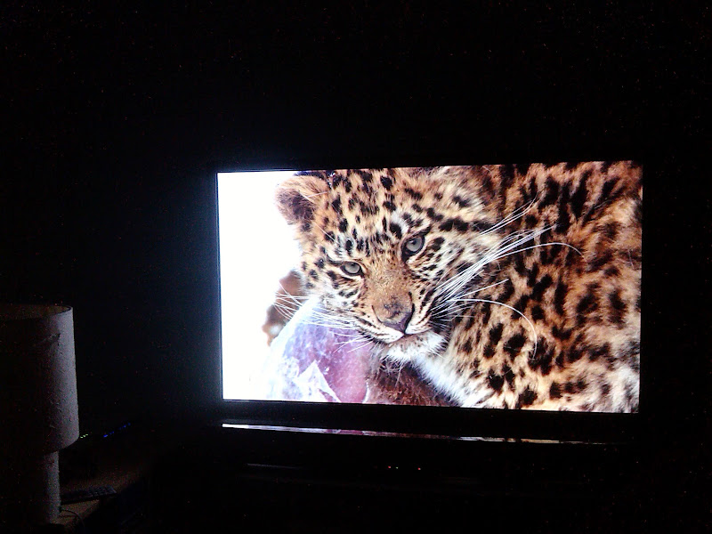

Originally Posted by jer88 View Post
I fiddled with the picture settings for months on my 43" and 51" 4500. I was having trouble because I copied the Custom Color Space and White Balance settings that have been posted to this thread. They looked awful at my home. All this plasma needs is a few minor tweaks for a gorgeous picture. Here are my final settings.
Picture Mode: Movie
Cell Light: 20
Contrast:95
Brightness: 48
Sharpness: 15
Color:50
Tint (G/R): G50/R50
Picture Size: Screen Fit
Advanced Settings
Dynamic Contrast: Off
Black Tone: Off
Flesh Tone: 0
RGB Only Mode: Off
Color Space: Custom
R 40 3 2
G 25 49 2
B 0 2 47
Y 50 50 2
C 26 49 50
M 39 5 48
2pt White Balance: Default
Gamma: -1
Motion Lighting: Off
Picture Options
Color Tone: Warm 1
Digital Clean View: Off
MPEG Noise Filter:Off
Film Mode: Off
Black Optimizer: Dark Room
Turn all Eco Settings to Off.
I used these settings and the image on my TV looks very solid. The only trouble I am having is when I watch hockey games which is fairly often. The whites on the jerseys are fine but the ice looks very dull and not as light/white as it does on my other plasma televisions. Does anyone have any ideas on how to fix this issue for me? Overall love the TV so far can't beat it for $399.
brendanb33 is offline
post #999 of 1675 Old 10-16-2014, 04:07 PM
jer88's Avatar
Join Date: Jul 2005
Posts: 214
Quoted: 73 Post(s)
Liked: 47
If you change the Color Tone from Warm 1 to Standard, the ice will look bright white. For most content, it's recommended to leave it on Warm 1 or Warm 2.
jer88 is offline
