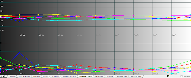

Saturation Shifts

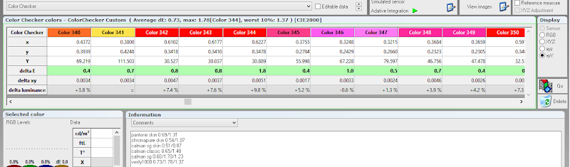

1000 Point Colour Verification
