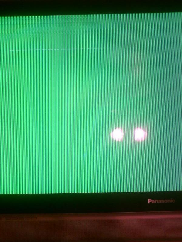

HI everyone,
Haven't been on this forum since I bought my Panasonic TH-42px50u back in June of 05'.
Came home tonight and played a little Wii which is connected via component cable. Then went to watch some TV so I switched over to HdMI and the screen was black w/no signal.
Went over to the CAble box Sci-Atl explorer 8000 hd and made sure it was on, then unplugged and plugged back in and still nothing. I then selected the cable input on my tv and the screen showed up perfect, switched back to hdmi and the screen was black. I then selected the cable input again and put on HBOHD and switched to HDMI when the screen displayed the show and the picture was green then the screen went black. I then turned off the cable box and the screen looked like this.
Anyway, I then changed it back to cable and the picture is perfect.
I then thought that possibly it could be something with the TV not processing HD so I hooked component cables up to my cable box and tv and the tv displayed the HD perfectly.
Any suggestions as to what this could be??? We had thundestorms here in PA tonight but pretty much everything is working aside from using the HDMI.

Here are the pics that didn't show up in the post before, sorry.
