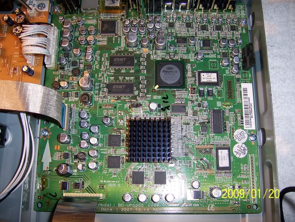

In an effort to get to the bottom of the freezing problem on one of my 5000s, I've been doing a little testing on the theory that it is heat related.
I ran eight tests, all with the Blu-ray "Patton", which is 2.8 hours long.
Each test was started with a cold player. (i.e. off long enough to reach room temperature)
I verified that the internal fan is working fine and I also have the unit sitting on a wooden desk with open space all around it.
I alternated the tests between having the cover on the unit and taking the cover off and here are the results:
Test #1 - Cover On - Freeze-up at 00:15:32 (hh:mm:ss)
Test #2 - Cover Off - Movie played all the way through
Test #3 - Cover On - Freeze-up at 00:32:01 (hh:mm:ss)
Test #4 - Cover Off - Movie played all the way through
Test #5 - Cover On - Freeze-up at 00:17:55 (hh:mm:ss)
Test #6 - Cover Off - Movie played all the way through
Test #7 - Cover On - Freeze-up at 00:28:21 (hh:mm:ss)
Test #8 - Cover Off - Movie played all the way through
Based on the above results, it appears that at least on my player, the freezing issue IS heat related.
At this point I don't know which internal components are the culprits but I suspect it is one of the processor chips. (which run very, very hot)
I have some combination fan/heatsink cooling devices on the way to see if they will eliminate the issue and to help determine which chip is the culprit. (if it is a chip)
Next test today will be swapping-out the power supply board from my other, problem-free player to see if it is the cause. Others on this forum have suggested this so I'll be testing that theory next.
polyscroll is offline

FWIW, I just got done with the first test swapping out the power supply board from my good player.
The board from the good player is now installed in the player with freezing problems.
I put the cover back on, fired up my Patton Blu-ray, and guess what, it froze at 00:07:17 !
I tested it a second time with the cover on and it froze at 00:11:21.
That clinches it for me.
That test tends to eliminate the power board as the culprit. Interestingly enough, the power supply in my freezing player has a higher revision number than the one in my trouble-free player.
Now I just have to wait until the coolers come in and do the trial and elimination tests on the processors...one by one...until I find the temperature sensitive one.
It makes sense to me that it could be a processor problem.
Processors in computers are rated for different clock speeds even from the same batch. They are tested at the factory for max speed and labeled as such.
Faster clock speed processors within the same family tend to cost more because there are fewer in a batch that can run reliably at the higher speeds and higher speeds equals higher heat generation.
People who overclock their computer's processors are able to do so (up to a point) if they add additional cooling.
That's my theory with this BD-UP5000. It must have a chip that performs at the low end of the reliability scale with respect to heat.
I hope the added cooling will solve the problem.
More news later after the chip coolers come in.....

Well, it looks like I found the cause of my freezing issues.
If you recall from previous posts, my problem was that one of my two BD-UP5000 players would freeze anywhere from ~7 to ~35 minutes into a movie. The only recourse was for me to turn the player off, the back on again, and go through the agony of trying to pick back up where the freeze occurred.
This would only happen when I would first turn the player on after it had been off for at least a few hours...on the first disc I played. After the power off/on, it would play just fine for the duration.
I ran some experiments to see if it was heat related and I found out it was.
Both of the large processors on this unit run extremely hot. This would be the Main Processor and the Reon-VX chip.
My solution cost me about $10.
I purchased a 40mm x 40mm x 28mm "Chipset" fan and heatsink assembly.
This is a 12 Volt DC powered fan rated at 5 CFM.
I disassembled the fan from the heatsink and installed the fan on top of the existing heatsink on the 5000's main processor. This is a three wire fan but only 2 wires are needed (Red+ Black-) so I clipped the third wire. (Yellow)
The Red and the Black wires were tied into the 12 Volt DC supply on the 5000's power supply board.
I then attached the fan to the top of the existing black heatsink so that it would be blowing air down on the fins.
The gold-colored heatsink that came with the fan (that I disassembled) was installed on top of the Reon-VX chip to help cool it down as well,
The Reon never had a heatsink on it to begin with so I decided it could use some help too. I decided not to install a second fan on the Reon because I didn't want to load the 12 Volt power supply down too much.
I've run through several tests now that are identical to my previously stated testing with the player's cover on and have yet to have the player freeze on me.
By the way, the underside of the main circuitboard opposite where the main processor is mounted has a thick gray silicone heat transfer pad that makes contact with the board on one side and the inside bottom of the steel sheetmetal chassis on the other side. This is there to draw more heat away from the main processor. This heat get transferred to the sheetmetal case on the bottom of the unit.
Before installing the extra fan, this bottom area under the player would get extremely hot as well but after the fan installation, it is only warm to the touch.
I've included some before and after photos below.
I'm posting this because there may be others out there with a player that behaves like mine did (with the freezing) I hope this helps you too.
Pollyscroll
ORIGINAL (BEFORE)
MODIFIED (AFTER)
FAN
