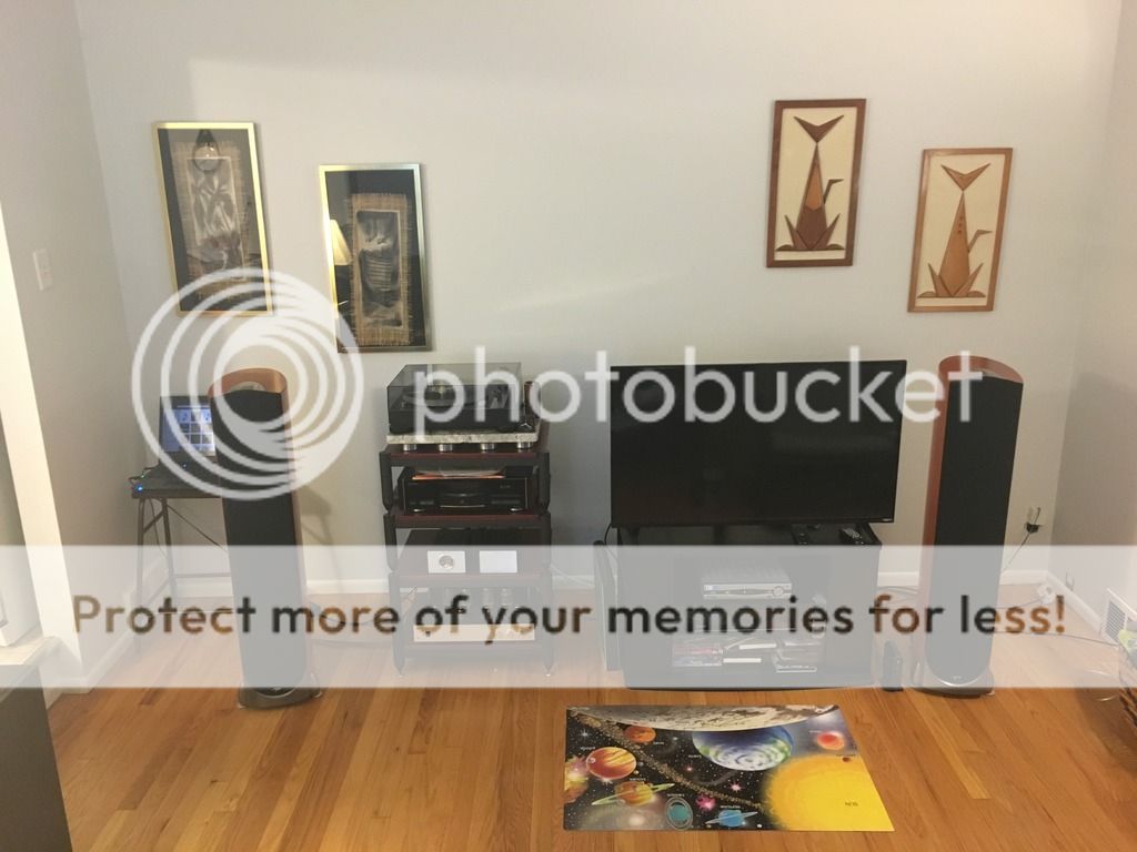

Hey all,
I just bought a new pair of Focal 936 speakers, and I'm using a NAD C356BEE with them.
While I like the sound, I don't think I'm getting everything that I've paid for.
The only way that I get the separation between the highs and lows is to crank it up to a point where I can't hear the person sitting next to me.
I realize that there are dozens of reasons of why this could be happening, and one of them is not enough power.
I will certainly look at all options, but I'm just looking for advice here for a reasonable 2-channel amplifier without breaking the bank.
Dan

Please post a picture of your setup and how you have the speakers positioned also. Those are unbelievably good speakers and should be blowing you away. I have no experience with that NAD amp you're using however.
bluewizard likes this.

I agree. Perhaps it's a setup issue with the speakers in the room. That integrated shouldn't have a problem driving these speakers. They are pretty efficient but do have dips to 2.8 ohms.
bluewizard and bmcn like this.
Excellent idea. I know nothing about his amp but unless it's a real dog those Focals should sound great properly placed in the room. He also doesn't mention the source. If he's streaming crappy low resolution content nothing's going to help.

Although one poster claimed that the 356 was not up to NAD's usual standard, I would expect just about any amp could make the Focal 936 sing.
So, I'm going to back others. I would like to know more about your room. What are the dimensions? Where are the speakers place? How far forward from the wall? How far to the side walls? Etc...? How is the room furnished? Curtains? Rugs? Carpets? Clutter?
Most decent speakers so NOT like to be pushed back against the wall or backed into a corner. That will result a a muddy sound, with excess bass drone.
I would say, you need the speaker a minimum of 10" to 12" forward of the wall, and about 18" minimum to the side walls. Though that's just a guess.

Hey all,
Thanks for all the suggestions. It took me a while to take pix and get back here, but I'm attaching one (hopefully) and the speakers are 8ft apart, 2ft from the back wall, an open space next to the right speaker, and I sit about 12 feet away from them. When I bought them I also bought the Bluesound Node 2 and I've been mostly streaming from Tidal because I have a $99.00 dvd player. I was given about 40 MQA files (anyone want any..I'll share?) and those sound really good.
I never had another pair of speakers with this NAD, these are the only ones so I can't really compare. These sounded incredible when I listened to them when I purchased them. I didn't bring any music with me and they used some demo cd that consisted of acapellas, some Barry White types singing lower than you can imagine, but mostly quiet stuff, to show off the highs and the lows I suppose. Their setup had the speakers closer to each other than I have now.
I'm not going to purchase more power since I don't know if that's the issue and I haven't even paid these off yet.
I'll go through the suggestions here and let you know what's worked and hasn't. Has anyone used an app with a mic to capture some stats? that sounds interesting to me.
Anyway, the picture is attached.
Dan

Originally Posted by SnoopGordo View Post
But a bigger room isn't an option, unfortunately.
In your case, near field monitors may work better. Google search on "near field monitors" will show you many options.
The difference then is probably not the amplification, but that hi end audio stores typically have some room treatment and they are good about placement.
Here are some things you can do:
1) Pull the speakers up so that they are flush with the front of the entertainment console. Then try toeing them in (angle them) toward the listening position.
2) I see hardwood floors. Is the room mostly hardwood floors? A big area rug can help with reducing reflections that muddy sound.
3) Do you have curtains with the windows? That can reduce reflections. Room treatments on the walls can also help as well.
Your questions are answered: Speaker FAQ

I have the Node2 and that NAD 356BEE AMP. I am running small inefficient Harpeth speakers.
I’m curious if you are using the DAC in the Node2 or if you are using the DAC in the NAD (if you have the module) or some other DAC?
I ask because the DAC in my Node2 sounds very different, and not as good as the DAC in the NAD or the OPPO 105 with the same content.
The NAD and OPPO DAC are pretty indistinguishable to me when feed the optical and/or coax output from the Node2, but with the Node2 connected via RCA to the NAD – Not as good.
Also – Is that a Pioneer AVR in your picture? – If so, how do the speakers sound driven with that AVR vs. the NAD?
+1 You beat me to it. I had the same observations.

If it sounds good when you turn up the volume and are further away, it's very probable your seating position is a problem, is your setup or seats in or near the middle of your room?
PretzelFisch is online now

Good suggestions. It's hard to tell from the picture but the speakers do look too close to the back wall. Also, I think toeing them in will help a lot. You should also try to be seated in about an equilateral triangle based on the distance of the speaker centerlines. These are not tried and true formulas but I suggest the OP experiment with speaker and seating position. Here is a picture of my setup. The front of the speakers are 34" from the back wall, the center of the front of the speakers are 28" from the side walls and the speakers are about 8 feet apart. My optimal listening position is about 9 feet from each speaker. Also, although I have hardwood floors there is a large fabric couch as the main seating area and the wall to the right has a doorwall with 8' fabric curtains.
You would still benefit a lot from an area rug, too. Those hardwood floors will just bounce reflections right up at you
bmcn likes this.
Not sure if you are being clever but the point of having finished hardwood floors is to see their beauty. There is plenty of fabric in the room, it's not at all live and the system sounds fantastic.
SnoopGordo likes this.
I have a 105 year old house with oak hardwood floors throughout (except in the kitchen and bath) that I personally sanded and refinished to like new condition, careful to match the stain to the original 105 year old mission style oak stained wood that is on the baseboards, the window frames and sills, and even the windows themselves. So I have plenty of appreciation for wood finish, not that it has anything to do with this.
An area rug will help reduce reflections and improve the sound. A fabric couch and a few curtains on the windows won't do it all. I wish I could do more in my room than I have. But I don't pretend like it wouldn't help.

I think OP should always first get a UMIK-1 and REW and measure his system. "Separation between highs and lows" is hardly a diagnosis, let alone a functional symptom that warrants spending money on a new amp.
But PS: reflections are real, and they make a huge difference. The best stereo in the world will sound like any old useless POS 200 dollar cheapo system if there are no acoustic treatments to reduce reflections.
+2 You beat me to it except that I'd have the speakers way further out into the room. No surprise there.
