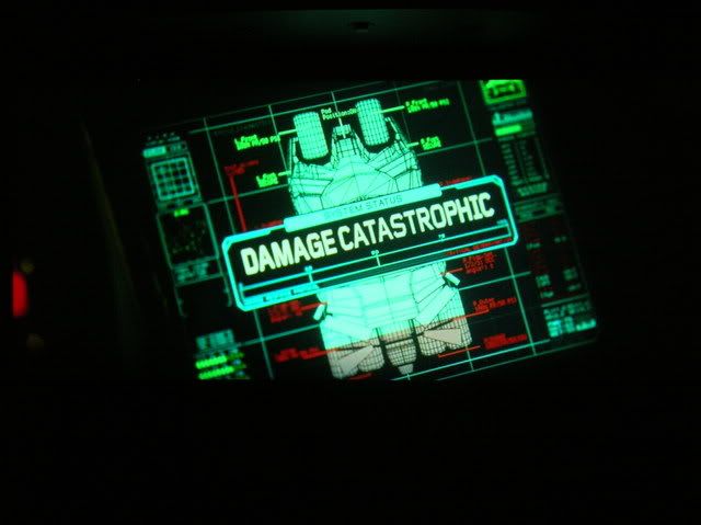

Does anyone have any screenshots with the SS prisms?

I posted these in the French/SS prism thread, they wern't necessarily identified as SS prisms and since you asked.
oman321 is offline

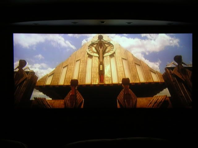

Whilst the 2 prisms work, they do have many limitations when compared to a fully corrected lens.
This image was captured using my MK4.
