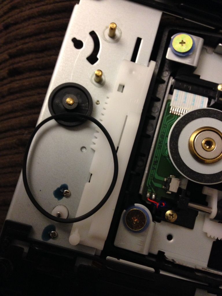

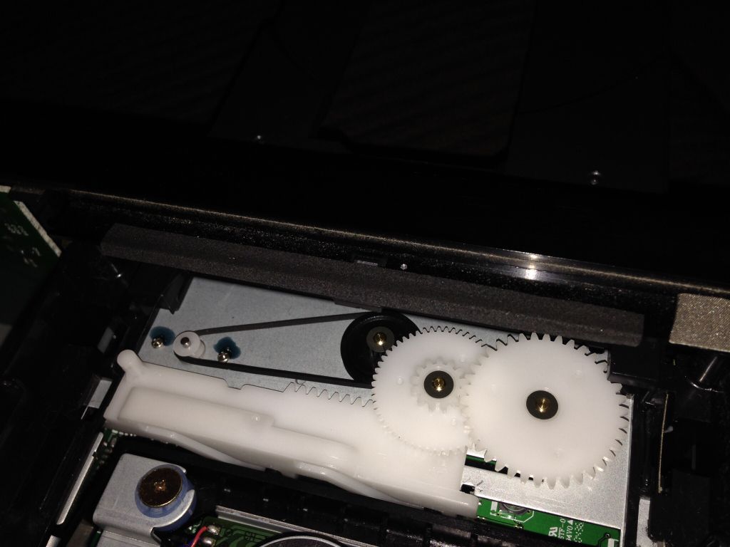

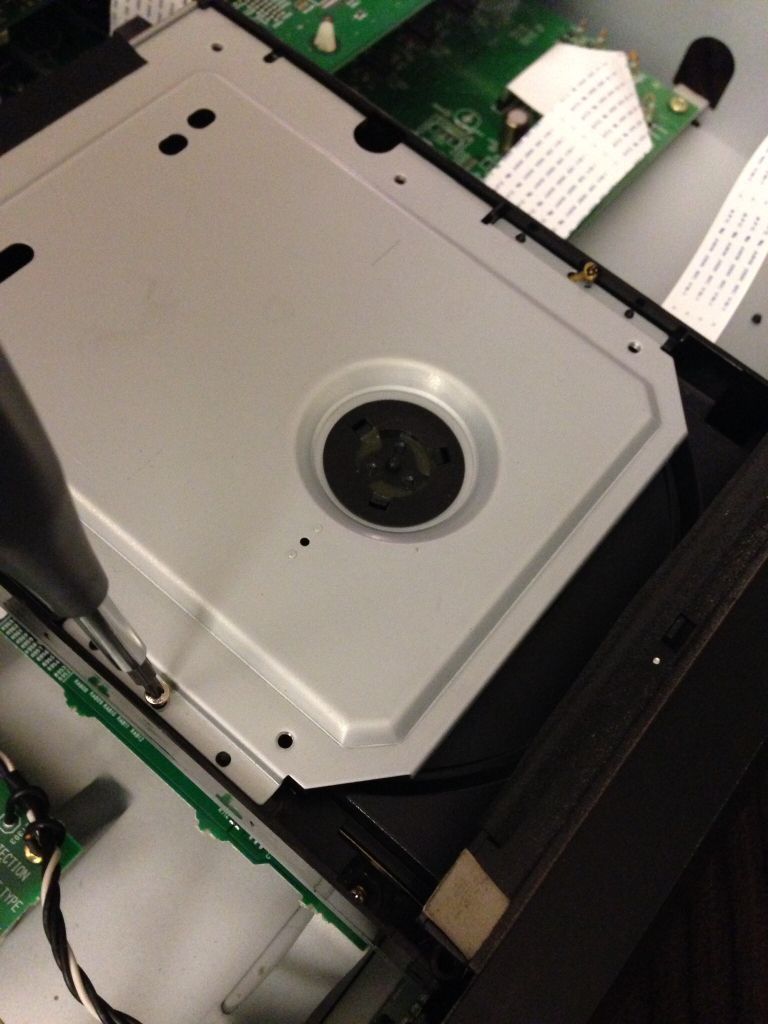

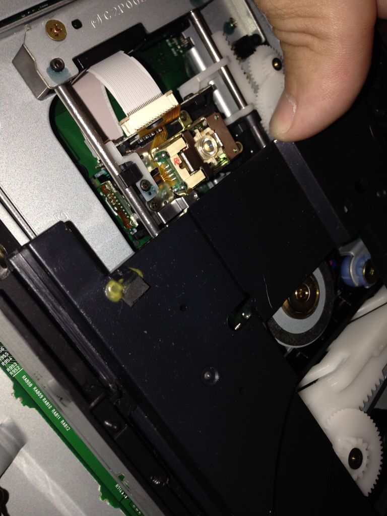

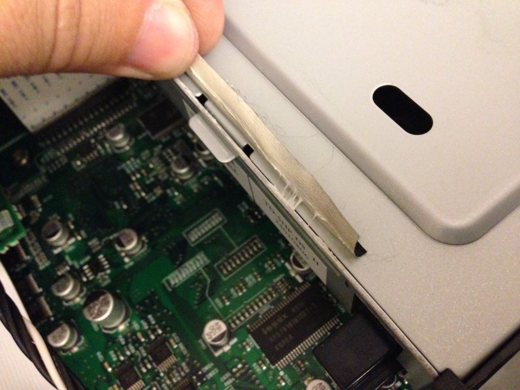

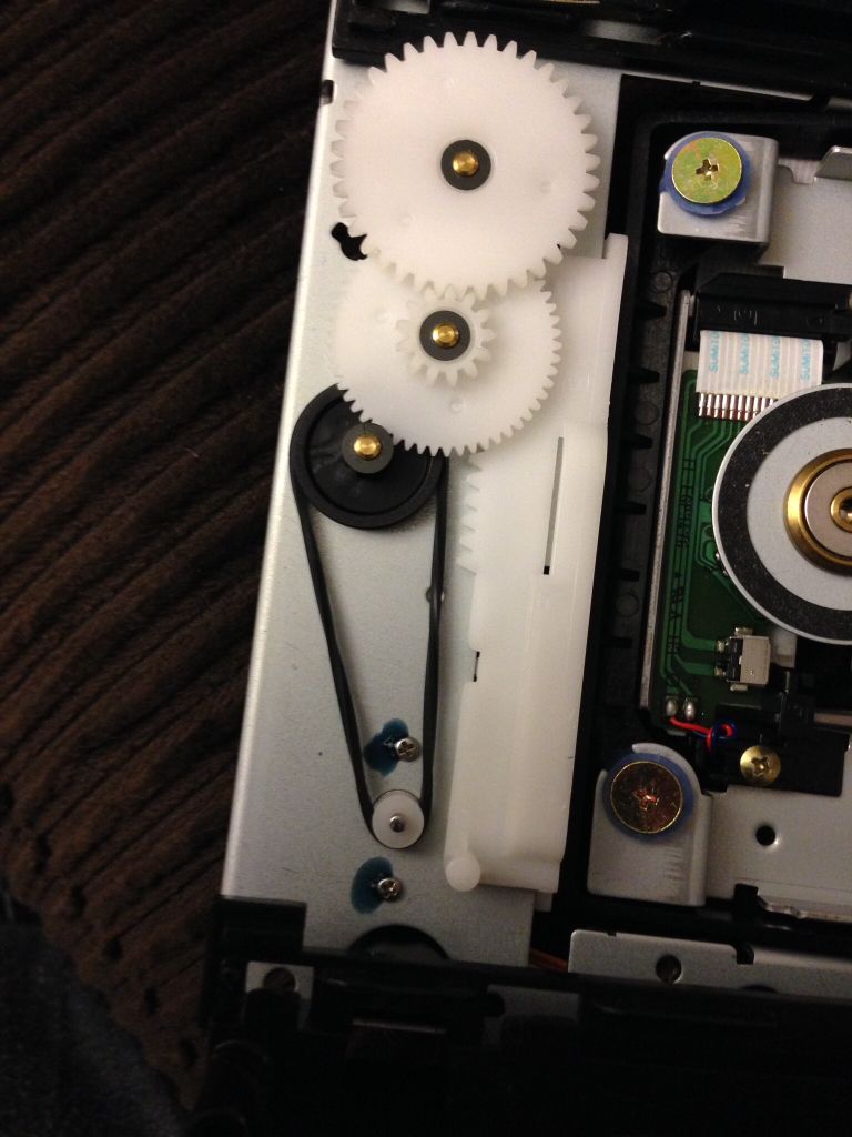

I just thought I'd post about my sticking disk drawer issue that's been getting worse over the last few years on my DVD 2910. Just in case anyone wonders, it is belt driven and the belt can be accessed without too much trouble.
With the top cover off, you can remove the two screws holding the transport assembly cover on:
Then pull the tape at the rear loose:
And wiggle the metal cover forward till the center tab at the rear is loose, then remove it. Then push the cd tray forward to reveal the gears and belt.
The tiny retaining rings are soft and a small tip flathead can easily remove them to get the two gears off to access the belt.
I didn't have a replacement belt, but after cleaning the old one and putting it back the tray is working normally for now. I traced the pulleys on paper so I can determine the proper belt when I find a local source for belts, if any still exist.
I did fully dissemble the transport, but I don't think it's necessary now that I know how it's assembled.
