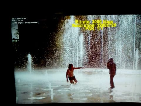

Orrrrrrrrrr, something hinky's going on at Netflix. I just tested my Toshiba BDK33 Blu Ray player. I noticed before cybergoobr posted about his Panny HDTV, that streams were coming in at 720P and going no higher. I assumed it was a combo of time of day, wifi from the router issues, or Comcast shenanigans. It hadn't bothered me because with summer here, extra streaming is going on and saving data usage was on my mind.
Running the ''El Fuente: 60 MP10'' clip and seeing it top out at 3000kbps 720p, I pulled the ethernet cable from my Samsung tv and plugged it in to the Tosh and tried again. Same result. Then, played the clip on the Roku 2 XD, which is wifi only. It ramped up to 5800 kbps 1080 in seconds. So the Toshiba hitting the wall at 720 isn't (I believe) a router issue or due to Comcast horse play.
It's possible specific devices may be having streams limited to 720 on Netflix' end. So cybergoobr should give them a call back again and continue to report his issues. It's not the app.

There are titles that stream at 720 max and are still called "HD". I've seen a couple of them lately at Netflix. I can't say that this is a change from the past. But I was watching one and quickly switched to "Example Short" which immediately ramped to SuperHD.

My Panasonic DMP-BDT110 BDP is limited to 720p, but it doesn't seem to use quite the same set of Netflix video encodes as other devices that I own do. When I stream "Example Short 23.976" or "El Fuente: 60 MP10" on it I don't see the burned in resolution/bit rate information.
There are more than a few HD titles which are 720p-only (720p is an HD resolution--most HD cable network channels are 720p, as well as ABC and Fox). I've even seen some titles which are limited to 3850 Kbps 1080p Netflix video without the 4300- or 5800 Kpbs "Super HD" encodes. Back when they used the "Super HD" designation, it was possible to tell which were 720p only; the ones which were labelled simply "HD". You can still see that in devices whose players feature the old Netflix common UI (my Panasonic BDT220, WD TV Live and Sony BDP-S390). Scanning through my My List queue on my BDT220, I see that Chasing Amy, The Cider House Rules, Emma, Equilibrium, Life is Beautiful, Mimic, The Prophecy (also II & III), Reservoir Dogs, Strictly Ballroom and They are all marked "HD" whereas all other HD titles are marked "Super HD". It's probable that they're all limited to 720p, though some may have the non-Super-HD 1080p encode as well.
Often HD titles can't be played in HD on PCs (Silverlight player, HTML5 player in IE11, Win8 Netflix app), though sometimes they're just limited to 720p. I've seen some titles which I could play in 1080p in the HTML5 player but not the Win8 app (the Silverlight web browser player is limited to 720p for all titles).

My Panasonic shows Super HD and I haven't found any issues with 1080p streams. Since the ST50 uses the same software, if he's actually watching 1080p content, which he claims he gets on his PS3, then I wouldn't be surprise if the issue with his set was with his ISP.

Let me be clear that I was speaking specifically about my 2011 Panasonic DMP-BDT110 and not of Netflix on Panasonic equipment in general; my 2012 Panasonic DMP-BDT220 streams resolutions up to Super HD without a problem. I was responding to Westley-C's statement, "It's possible specific devices may be having streams limited to 720 on Netflix' end". It's not just possibly; I own such a device (though I don't use it anymore).

Exactly. That's was also my point and why I posted, that unlike my older Panny 2010 BD player, my S60 streams Super HD and so should the ST50.

''El Fuente: 60 MP10'' is the only clip I use now to test a device. You can actually tell how long the buffer is at the end because they show content all the way though unlike the Example short which shows test patterns that even my Fire TV shows a 3 to 4 minute buffer which is wrong as it is actually around crappy 25-30 seconds which is why it is terrible for streaming Netflix during peak hours. Using the ''El Fuente: 60 MP10'' clip the PS3 is around 2 1/2 minutes, the Roku 3 around 1 1/2 minutes and the ATV3 around 1 minute.
