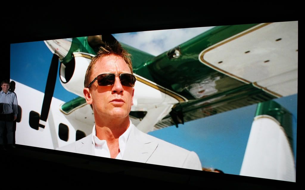

The one Wolfgang is pictured here demonstrating (Barco DP2000) would be one of the first choices.

Is that really designed for a movie theater? it seems much larger then other Projectors. anything special you would have to do with this projector different.

When you said an 18' screen you get outside the realm of consumer units just on shear lumen requirements.

If you were willing to accept a 16' wide 2.35:1 screen using a quality anamorphic lens to fill the whole screen width with all the PJ light, you could get by with "only" a $50k projector, like the Sim2 HD5000.

My opinion is that if you want some great performance from the HT 5000 the OP screen size requirement is out of it's range.
On the StudeoTek 130 screen I'm down to between 18 to 19 fL at 14' wide after 300 hours on the lamp.
I think on my screen size it would be real tough to beat right now but going up two to four feet is a lot more real estate to light up and I would not recommend it.
