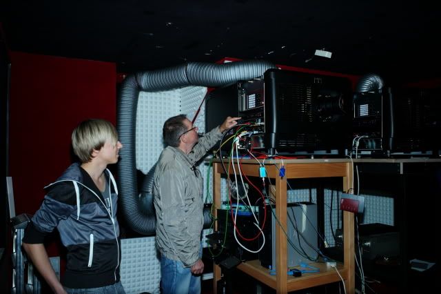

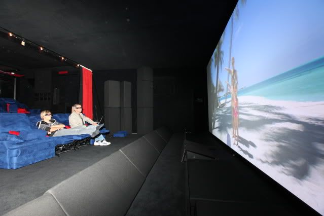

fine you like it norman..
here 2 pictures from yesterday night.
normen take a close look at the 4k imb board from doremi.
and yes its the highlight the new very close new first row at
0,8 times the screen in wide where you believe to be at the place
the picture was taken in true 4k 3d when the picture was made under top conditon.
btw. as the quality goes up a lot now i can see every mistake i did when i takes the pictures
the optic companys have a definition what is sharp under different apertures
like for sample with apature 8 my 28mm Leica optic when i select 5 meter it will be sharp from 3.5 meter to infinity.
"thats just a sample"
now this rule is not anymore right as you can see with this set up fine
differences between it and may only 4 to 50 meter are real 100% in focus.
with my old setup i can see it but now i can.
that means that i have to improve the way i record my stills in 3d
a lot.
also no way to make jpg pictures anymore i will use in future only RAW data
process them and than makes the 3d processing.

Sorry Wolfgang: As a kind of entrance to my post I've chosen the headline "Blinded by the Light" but I forgot completely to mention this point
When we came into the cinema all lights were on, door wide open, "ideal conditions" for a good projection and as soon as WM fired up the first pj I thought we will see something washed out, but as soon as Bonds face appeared I was struck by lightning. A fat good picture on the screen, bright like a flatscreen panel. The first visual WOW effect we had there. Then I thought when the lights are turned off the picture will be tooo bright or to speak very directly: Unwatchable.
Question to all readers here: What happened when the lights were turned off and how many footlamberts did we see?

Well...the nice thing about the human eye is that it has the most effective build in iris there is. So with 40+ ft/l and scenes with at least some bright elements your iris does its work - and the black level will seem very decent. Throw in a scene (make sure it is long enough for your eyes to adapt) with very low overall/max brightness and the blacks will get a very milky touch.
Nevertheless - this is an amazing setup and an accomplishment based on pure passion for HT. Kudos.

Thanks for your rating Lion, you are in the ballpark, but add 50% and you are there
Long story short: the picture looked fantastic and well belanced, so WM became unsecure himself and decided to take a measurement: We had 60fl (!) on the screen and we did not have the feeling that it was too bright. Crazy!
And black levels were still good. My colleague is used to the JVC blacks and he has much better eyes than me and he didn't get it, why the blacks were still apparent.

thats how our eye/brain works.
its takes some time for the eye to open up the pupil apature when its longer expose to dark.
it from humen to humen different it can take 30 sec. or some min.
other when your pupil are open and a bright sequence comes.
we can close the pupil very fast (well below 1 sec).
but as the 60FTL (that the lowes i can do in 2d as the lamp is dimm
down to min. at around 4000 watt) show always something even at almost 100% black sky with some stars on the pupil
never open up completely.
when you watching a 100% dark test pattern for 5 min. yes thelion
is right but even there (i try it) it was a big surprise that it was not
that bad.
you have to see it to be believe it.

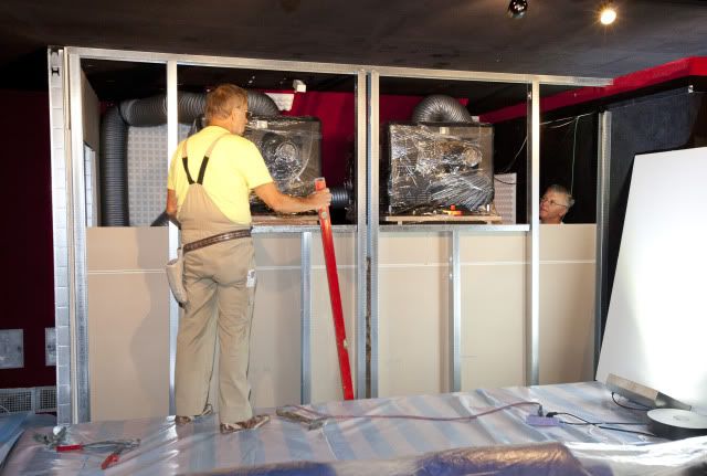

last few days the new pr. room was build.
they put double sound protection inside!
the company told me even with this design that is very unusual
in germany (we build normally all walls in stone very strong)
that the sound protection will be very good.
lets see........
also important will be how i will design the opening that i need
for the optic without any glass between the optic and the screen.

next will be the design for a opening in each panel for the light beam from the optic that it can hit the screen
"without" any port hole glass in between.
i did some measurments and it seems i found a good way
that not will increase the sound level to much even when i
drill a bigger hole into the each panel.
the only reson why this panel are there is when i sale some day
this pr. i can take it out from the front as the door and the room was to small
to do it and i not like to remove the whole sound prove walls and rebuild it.
as this 4k dlps from Barco are 100% modularly developed it will be
very unlikely that the whole pr. have to go back to the factory and need to
comes out but with this panels i was prepare for everything.
the right pr. panel was removed to show the pr. inside the sound prove walls.
