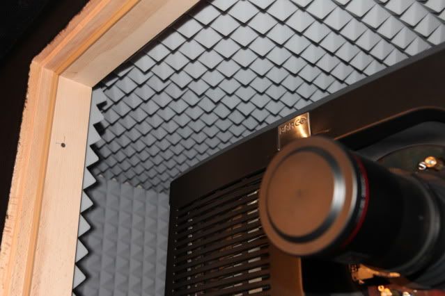

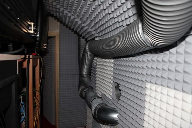

I start working at the soundprotection inside the pr. room and put everywhere i can sound protection waffles.
some of the old waffles from the old pr. room in white are still there and i use them.
this will drop the level of noise inside the pr. room some db as it kills the
noise close to the pr. itself and this will of course also decrease the outside noise level.
also as i have now a lot of sound absorber free as i have in the past in my cinema
in the direction to the screen 2 rows of them at the floor (see older pictures) but now
as i put a new first row this absorber are free.
this will decrease the sound level inside the pr. room additional and opposite
to the waffles it will kill also lower freq. much better.
next will be to put the bd player the denon a1 and all the rest back to work.
i decide to put everything under the rack from pr. number 1.
as i can almost look to the screen when i handle the bd player and the a1.
it will be the best way.

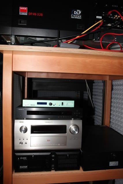

the left side from down:
the doremi 4k show vault cinema server
the denon a1
the oppo 3d bd player
the doremi dimension 3d box
left side the 4k computer for the 4k 3d still pictures.
next week infitec will install the new filters inside both pr.
there will be some features that will be first time used in a dlp pr.

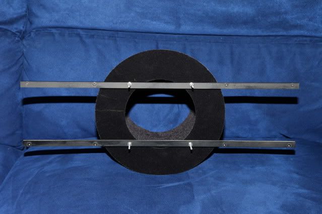

the last big thing was to build the sound protection for the lens without
glass in between the optic and the screen.
as i like to try a other optic for some reason i can not start with it.
i like to wait before everything was 100% clear that i will use the lens i
have in future as well.

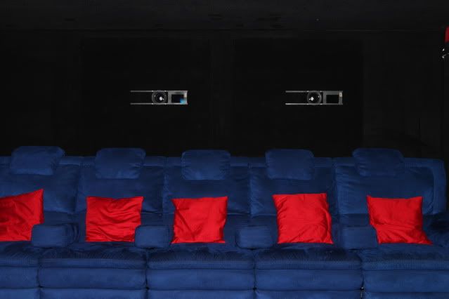

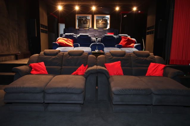

yesterday the new first row a black two double love chair arrived
earlier that expect.
this will be the place to watch at around 0.7 times the screen wide
my native 3d 4k stills and some day true other 4k content.
i can movie with the 4k dlp also the "now" secound row that are perfect
to watch 2d and 3d bds from 1.15 times the screen wide to 1.0 times the screen wide in distance.
the problem in the past with the 2k dlp was that at 1.0 times the screen wide in
distance i can see pixels in some areas but as this is with a 4k a no issue anymore
i did this change.
as there are new 4k opitics coming i deside to not drill a hole into the 2
plates for the 2 openings from both pr.(see the picture in the background) as this is a hightec material and very expensive.
the new optics are very likely a bit thicker and i not like to do it again.
i will keep this hightec plates and did it when i will be 100% sure about
what optic i will use in future.
for the time being i will order a 40mm thick hard wood and just make a hole into
it to couple the lens without any glass to the screen.
top sound protection have to wait a bit.
so soon i can reopen my cinema and i will select for it likely
Ben Hur.
this movie was one of the movie that i will remember forever also
like the first Star Wars 1976 and Titanic and 2001.
all this movies i saw in 70mm and beside titanic that was a blowup
from a Super 35mm all was real true 70mm films.

yesterday i look into
drop further the noise level.
as you can see in this picture the gab in the projector
room window is around 10 mm each side and noise from inside
the pr. room comes "a bit" out
from this gab.
sitoation before was this.
i design and produce a strange looking sound cancel tubesystem
see here "some parts" of it.
this almost close the whole gab and at the front
of the 4 srews I will add a aperture that let ONLY
the beam out and cover all the rest.
that means the small gab that is still there (around 1-2mm only) will
be closed as well and it will looks more nice.
i try it and the sound level is with all this action
as good as if there was not any hole at all!
cant hear any difference now between a 100% closed
window (that I still have to try it) or this with the hole
with the sound protection.
also some more sound absorbers inside the pr. room itself help
to get the nosie level down.
no question you still can hear all this huge fans.
2 x 600 cubic meter exaust air +1x 1200 cubic meter inside air and 2 huge
32000 lumen pr. with two 6000 watt xenon lamps and the
cinema server the 4K 3D computer and more all this you can still hear outside
but good is that sound level is now much less than in the past with one single barco dp 2000 with inside and outside air system!
also I will add a filter slider after this new aperture
next week that
will have the Infitec 3D filter and other filters i will try in future
for 2D and 3D.
this will also make it very easy to switch between
2D and 3D and on top of this I will add some different
apertures that will kills
the light when I project a 2.35 format movie
the black bars on top and bottom as with my light gun
this is a improvement as less scattered light will hit the room.
I did the same with my DP 2000 and it was a good improvment
this time but now
as this pr. have almost the double light it will be even more important.
also it will help to drop the light level for 2d as i cant dim enough
the light level with this 6000 watt xenon (min. is 4000 watt)
and thats
a bit high for 2d at least with a very new lamp.
also it is not to good for the lamp itself
to dim this huge xenon lamps at all.
if you dim very often between max. and min.(worst case!) this
huge xenon lamps will produce more flicker!
the beam cant burn into ONE place as it always move
form one place the beam select at max. light out to a other
place for min. light out.
this jumping will enlarge the filcker.
here a picture from the sound protection wise ready system
without the apature.
the 4 srews will get some more parts as above described next week.
W.Mayer is offline

Good idea, what are these rings made out of? Rubber, silicone?
Sincerely, GC*
rAVe Best ATMOS DEMO CEDIA 2016. HOARDS AWARDS, ACCOLADES, 1ST ART CREDS.,WLD. RECORDS, & HI PERFORMANCE 16-24-32-48 CH. MIDI-PLF CINEMAS WW. - CUSTODIAN HIGH END IMMERSIVE CINEMAS TO SMPTE & ADV. IMAGING SOC. HELP Combat Channel Insufficiency with Altitude 48!*GC = GANGSTA C. genus: cineramus maximus. GC Twitter (Now staging Humanitarian Relief Aide to Great Bel-Air Circuit B-chain & 6P/HDR Projection Famine of 2017)
CINERAMAX is online now
Old 10-31-2011, 12:35 PM - Thread Starter
W.Mayer's Avatar
Join Date: Mar 2002
Location: Germany
Posts: 2,161
Quoted: 220 Post(s)
Liked: 264
i am a pcb manufacturer and the parts are made from pcb material
called FR4.

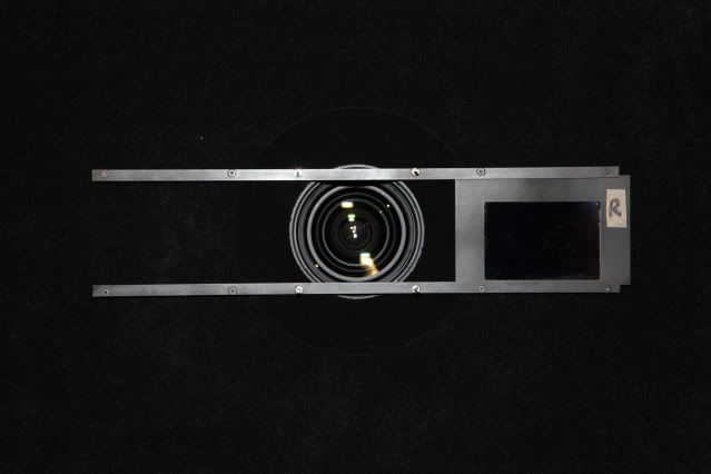

the filter slider is ready
it contains temporary only the new infitec filters.
the one that will be made in some weeks will have 3 filters for each pr.
possible also gray filter to drop the lumen in 2d!
yes you hear right I like to drop the lumen
as I cant do it with more diming I have to do it with a gray filter.
the min. 4000 watt produce with a new lamp around 70ftl at the screen at full 7 meter.and that is a bit too much even for my taste
till 50ftl is ok but over 70 ftl is to much.
I will likely drop it to 30-40 ftl.
