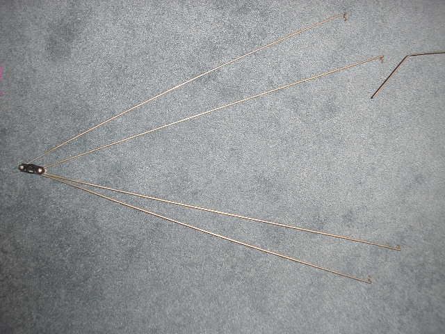

I have one lead going down through my attic from the MATV (Master Antenna)... somewhere that is split within the walls.... I have a coax outlet in my living room for one... & the other was hanging coax in the basement. So it is split somewhere within the dwelling.
I can see other leads passing through my attic for other units, however not knowing who is using what I keep my hands off, so the distribution amp if there is one (for some reason though I don't think there is), is likely inside the attic of the dewelling closest to the antenna.
The cable company ran a seperate outlet to the Living room for cable for the previous owner. I also had that unused lead in the basement (I have this hooked to the splitter now for my stereo receiver)... this is how they should install cable.. not hack up existing wiring as I will mention later.
I also ran another outlet to the other side of the living room & 3 more in the basement. These 4 lines are variable & end at my splitter but are not attached. If & when I need these I can attach them, they are color coded. I suppose if the next owner wants cable he could feed off these too.
Usually when the Cable company came into a dwelling, they sliced up all the antenna connections & outlets in the living rooms to make them cable only & rendering the antenna unusable... not so in this case, & I checked this before I bought the place.... to make sure I didn't have the un-needed expense of a cable bill... figuring evey dollar may count some day & this would be a savings.
Originally Posted by Floydage View Post
RF 8 is upper VHF so it sounds like your attic antenna is more for UHF. RF 8 needs the big element(s) like you see on big outdoor antennas. Now if you have a big one then it could be a flaky element(s) like you said, a bad connection where the VHF and UHF sections combine (or along the VHF elements), or the combining piece if it has one. Of course I'm just guessing at the antenna based on what I have (Yagi Uda v-shaped thing with a seperate UHF section). Also, make sure the amp is rated for VHF (might try bypassing it).
One of the large elements on that attic antenna is busted (came off of dads roof), although I had an RF3, 5 & 8 at the time it all seemed to work, I didn't worry about it. Now we only have an RF 7, 8, & 10 now. 7 is the repeater for TBN & is so weak I dont consider it, rf 10 comes in fair (60-70%), but about a year & a half ago , the signal from 8 eroded from 70-80% down to 10-20% over the period of a couple weeks. This only happened on my attic antenna & not on my outdoor antenna. I was thinking sound barrier construction several miles away may had affected it.... only variable I can think of, though the antenna is hard to get to now I really should consider going up there & looking... I'm not as young as I once was though. I would think the mid length elements would be used for RF 8
The good possible news is that RF 8 plans to return to it's pre DTV transition allocation of RF 31 (though remaining on virtual 8). Dunno when that will happen, sometime perhps before the summer.
I would really like to lop off the broken elements & properly mount that attic antenna... may be OK since we do not have low VHF here anymore.
BTW my pre digital analog signals were always very good for all channels on my outdoor antenna. For the attic antenna, not quite as good, though 8 was my strongest channel & near perfect.
Bismarck440 is offline
Do you mean the big elements are keeping you from rotating it to the proper position? I think all the elements parallel up to give the proper impedance. You can probably bend them for position, just don't let them touch each other.
Now broken ones you could try taping them back together. If a piece missing you could tape a piece of stiff wire or small metal tube to get back the right length (I avoided any mention of soldering in an attic ).
Also check the wires/rods that connect the elements together.
The insulators at the boom are broken, I'm pretty sure the elements are there but flopping around, I was careful not to short anything, but true it prevents orientation. & proper position. The newer antennas are starting from Channel 7, so the really long elements are no longer on these antennas. My thought was to lop off the broken elements & terminate them on the boom in similar fashon as they are on the broken end (or should be)... or just shorten the boom.
The elements themselves aren't broken, just the plastic insulators where they swing out of the boom, you said removing these would mess with the overall impeadance though?
Possibly, I'm rusty on my antenna theory from college and never designed the things. I would guess that the bigger ones would mostly affect the ones nearest them (in size that is but I'm assuming it's the taper down in size (V shape) type).

Yea, I know better just not to cut off the elements, this would have to be shortened in a manner not to leave element stubs. As far as I know, the elements aren't broken. just dangling by the blue plastic insulator & that heavy rod that cris crosses along the length of the boom. Since there is nothing below 7 here (or FM), the low VHF is useless except for Summer DX.
Of course I don't know how much you know about such things but it sounds like you know more than most folks. I don't recall how they terminate the heavy rod and such at the end of the boom, hopefully with no tuning elements (doubtful there are any IMO). Next time I'm up in the far part of my attic...

I think they just loop it on a screw or rivet to the plastic insulator @ the boom end(s).
Unfortunately I'm at the far end of my attic too, the insulation people installed a dam over my opening I may have to remove to get up there.
OK so it appears to be an open termination. If there's any length of rod between the last element and rivet than it could be a tuning section (same would hold true if it were a shorted termination - black magic RF stuff ).
Damn dam!

That would be what I wondered, are these criscrossed rods actually cut to a length to where they are resonant or tuned. (I'm going from memory for the exact termination, I believe these are just rivited at the ends... I could be wrong).
The sections between the elements very well could be but I wouldn't worry about those, just anything after the last set of elements. If they end right at the last set of elements then just cut the rods right after the rivets on your 'new' last set of elements.

A while back ago I posted part of my Gray-Hoverman Antenna I had found in some celing rafters in a Storefront in Ashtabula, seemed to be mounted to serve some purpose once upon a time.
Possibly the part of something like this RS production or similar model.
Decided I may take this a step further & either duplex it with my attic antenna, or try it as a stand alone.
In the single bay, they seem to be using a reflective blanket, I'm not sure if there are elments in front of the blanket, everything just seems to be hung on the wall here with no adjustment features.
I like this setup better, the exterior reflector dimensions from the plans seem to be 30" x 40" for a single bay (half of this one pictured below... my antenna is about 12" x 28" without the reflector), the reflector seems to be simply chicken wire?? (this is the part I really don't get if reflector lengths & spacing are that critical)... just chicken wire serves as a reflector?
Was going to fabricate something like this, the PVC for the frame but cutting this in half as a single bay... any better ideas for a reflector, or should this actually work?
Unfortunately a few months back I cut up a damaged antenna for the recycler. I could have just used parts of this & recofigured & cut the reflectors to the exact size.

The Gods of AVS are nice today, the buttons on the panel are actually working, allowing me to post links, pictures, italisize & use smilies.
Hopefully not the host blocker script.
I did a quick search and there's a lot of DIY articles on the G-H including this one with the ol' familiar pic:
http://www.digitalhome.ca/ota/superantenna/
Looks like they can be sub-band dependent (thus probably higher gain than a broadband antenna) so that may be an issue.
I'd try it stand-alone first since combining it (splitter in reverse) will cut signal in half for both antennas. Now a true frequency-dependent duplexer would be nearly lossless but you'd need to know the bands for which one to get, plus $ issue.
I think so too and no elements in front of blanket.
Hmmm, I suppose so since the wavelength is so much larger than the open spaces (ex: if you've seen circuit boards with 'Holy' shields ( RFEE humor), the holes are small enough for shielding purposes but large enough for IR solder reflow and heat dissipation). Also note the posted link design uses rods of particular wavelength dimensions.
See if there's any info in those articles. The chicken wire is nice from a fabrication POV other than having to be careful not to slice yourself up. Foil is a pain trying not to tear it putting it in an attic over an insulation dam . The rods of course will be more mathematically painful (and maybe the 'broad' reflector is less frequency-dependent > broader-band). Also check for any connections to the reflector, looks to be isolated in the broad types though.
