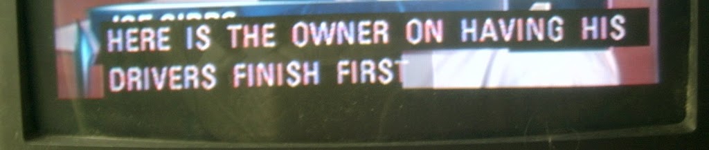

The picture above is of digital captions using the worst-looking font from a coupon-eligible digital-to-analog converter box. Imagine if you were to spend your $40 coupon on a coupon-eligible converter box (CECB) where all the caption choices looked as hard to read as those captions do. It could happen.
The purpose of this thread is to provide a central place for evaluations of how well closed captioning issues have been addressed in the different coupon-eligible converter boxes (CECBs). While all CECBs are required to relay CEA-608 caption data to analog TVs, only some of them offer the option of decoding CEA-708 caption data, which provides the user the ability to adjust the captioning to one's own preferences.
The main focus of this thread is on evaluating CECBs that decode CEA-708 captions to provide advanced captioning features. However, if CECBs that don't decode CEA-708 captions have any problems relaying the CEA-608 captions used by analog TVs, that's important information as well.

Here's my evaluation of the Insignia digital-to-analog converter box, which I purchased at Best Buy on 2/14/08. (This is the same CECB as the Zenith, but is simply produced under a different name.)
NOTE: I have used some pictures here, but it should be understood that these pictures are not high resolution (the camera used had only 4 mb pixels) and do not accurately represent how the captions actually look in reality. The pictures should only be used as an approximation of what the captions look like. I would much rather see pictures from professional photographers of these captions, so if someone else can take better pictures, please do so. (What would be even better is for the manufacturers to provide pictures of different captioning options on their web sites so that customers can judge for themselves what they might expect to see.)

d. When I took pictures of Font 0 and Font 7 captions, a close examination of the pictures showed that the solid background behind some characters had unexpectedly become transparent or clear, which made some of the characters illegible. I only noticed this in the pictures, and not during live viewing. I'm not sure how much of a problem this is or will be.
Font 0: Look closely at last word
Font 0: Look at the background behind the "T" in the last word; it's missing but a faint "T" can be seen.
Font 7: Look closely at "21st" and "Century"

Here's a link to a video of the 708 captions provided by the Zenith DTT-900 CECB:
http://www.youtube.com/watch?v=OORS0tC8JFw

The coupon CAN be used after the purchase (before its expiration date) if you follow the procedure above. If you're a person with a disability who uses the coupon without making sure the converter box will work for your needs, you can lose the value of the coupon, particularly since no other converter box at the store may work well for you either.
The Insignia has now crashed twice within the first week of purchase, and that might even be because I was using closed captioning. Unfortunately, engineers simply might not have run the box through its paces with all the different captioning features being turned on.
I put up a post and picture about the last crash at the following high-traffic AVS thread to get more input; I also noticed problems with the audio and video going out of sync, and the captions getting delayed the longer the box was on:
http://www.avsforum.com/avs-vb/showt...2#post13176692
Here's a picture of the crash (the second one):
Dana
