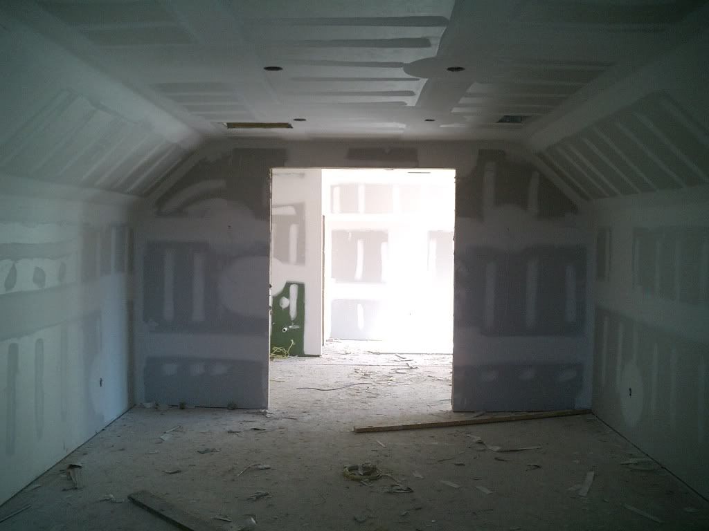

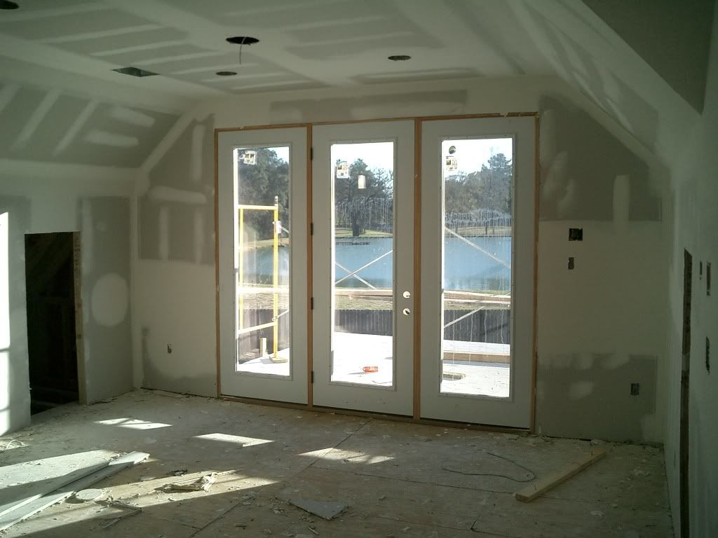

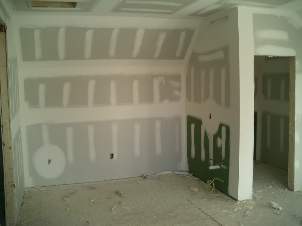

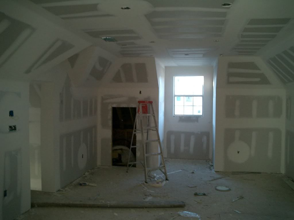

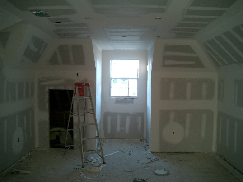

Here is my progress. My builder did the room up until this point. I will take it from here and finish the rest.
This is looking at what will be the screen wall. I will cover the window and build a false wall in front of the dormer at the point of the sloped ceiling. The door opening is just for attic access and will be accessible from removeable screenwall panels.
Another future screenwall pic. The opening to the left is the entrance to the bonus room.
Here is a picture from the front looking towards the back. There will be an riser centered in the space and double doors opening out the back of the theater.
Here is a shot outside of the double doors in the rear of the theater. This will be a small bar area and a half bath.
Finally, the rest of the gameroom area.
I will follow this thread closely to see how others are dealing with the problems with attic/bonus room theaters!

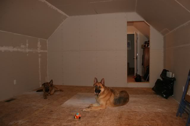

I've got one, too. I have turned this:
into this:
The room is 13' wide by 21.5' long, and 8' high at the center.
It appears my hypocrisy knows no bounds.

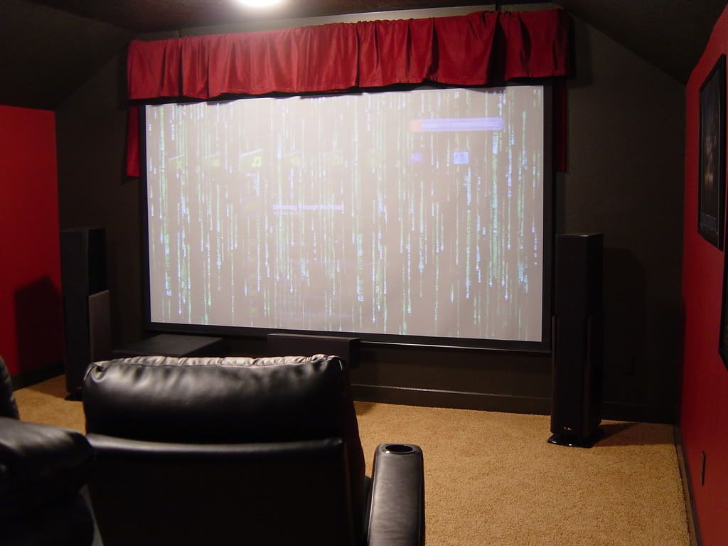

don't mind if I contribute to this thread?
THEN
NOW
Home Theater System: Sony VPL-HW45ES; 120" Carada 2.35:1 Criterion Series Projection Screen, Panamorph P752 Vertical Compression Anamorphic Lens, Lumagen VisionHDQ Video Processor, Oppo Digital BDP-93 Bluray Player, Origen AE X15e HTPC, Panasonic SA-XR57S Receiver, AV123 X-Series 5.1 Speaker System.

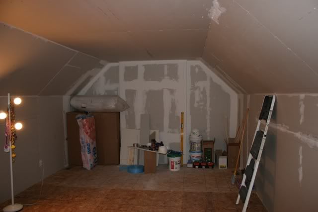

We also turned our attic into a home theater, bathroom and library areas.
Before:
After - still in progress:
Here's the constuction thread (will be posting new pictures soon)

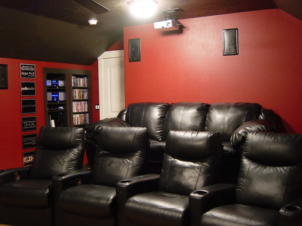

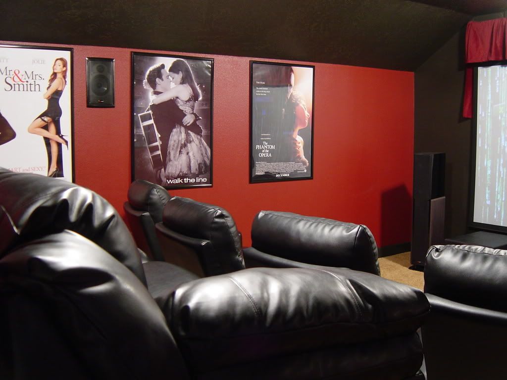

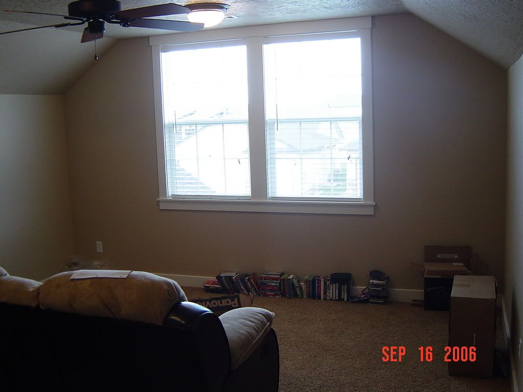

Before:
After:
fst96se is offline

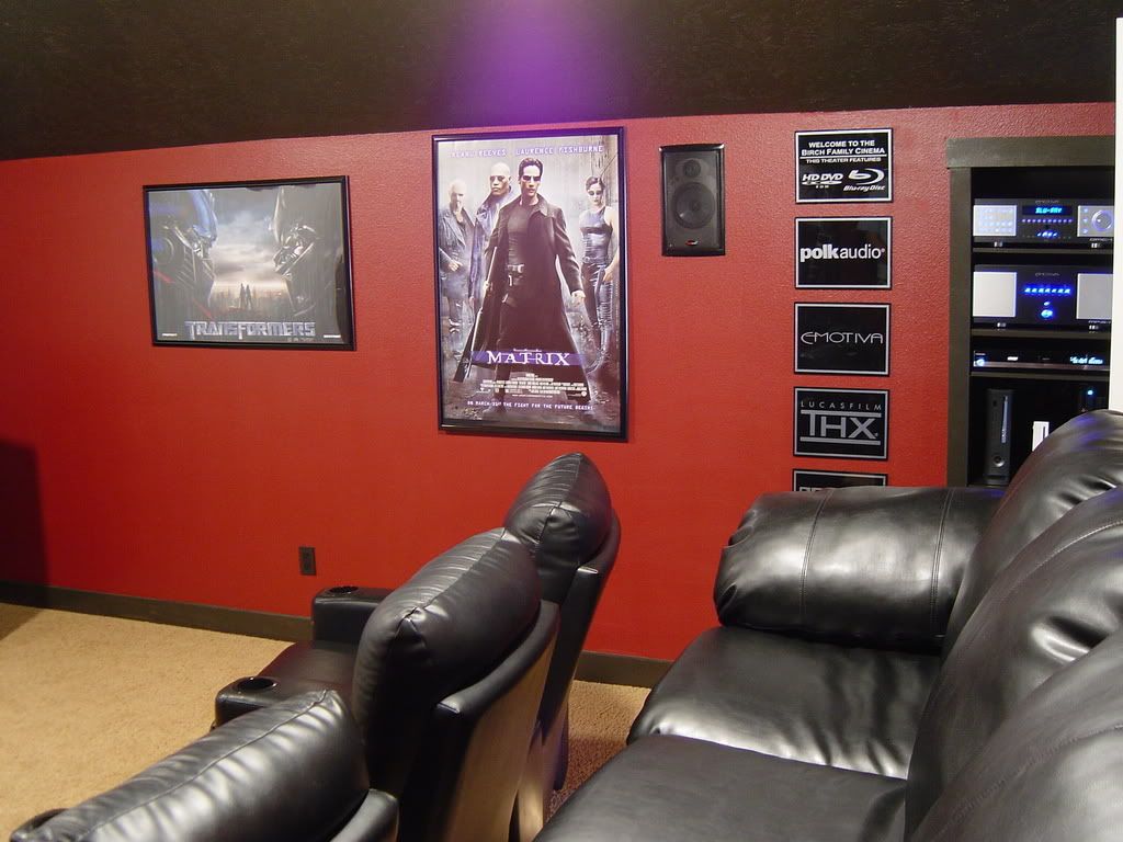

post #20 of 39 Old 02-29-2008, 09:20 PM
fst96se's Avatar
Location: Idaho Falls, ID
Posts: 586
Quoted: 66 Post(s)
fst96se is offline

BTW - I am considering that color scheme for the walls and ceiling also. How do you like it?
One more thing - I have been asking in this forum about the 2nd row seats being a smaller quantity than the 1st row. Any thoughts... And where do you plant yourself when watching a movie?
Thanks, very nice room and I like your "lobby area" as well.
The room is about 14'x15', I think. The wall height is roughly 6.5 ft high, maybe slightly taller. I am about 6'2" tall, and it is definately taller than I am.
I like the color scheme, we wanted it to feel "theater-ish" and so we went with that color. I think if I had it to do over again, we might use a dark earth tone, two tone, with chair rail or something. But ya, I do still like it!
Acoustically the back row in my room isn't nearly as good as the front row, since it is against the back wall. I also like the comfort of the recliner versus the couch. My wife often takes the couch, and I sit in the front row, second seat from the right when facing the screen. That puts me closest to the center of the screen.
Visually, I like the back row better. The front row is a bit close, and the second row is on a riser so the screen (120") doesn't feel quite so tall.
The "lobby" is a small loft at the top of the stairs. We have a 34" Sony XBR tv with four gaming chairs in there. That is where the kids hang out and game. Everything in the theater outputs (through a matrix switch) to the loft also, so you can game in either spot. The kids like it, and I like it so the projector doesn't get used so much!

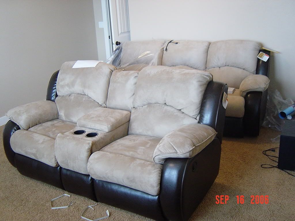

Here is my before:
As it sits today:
