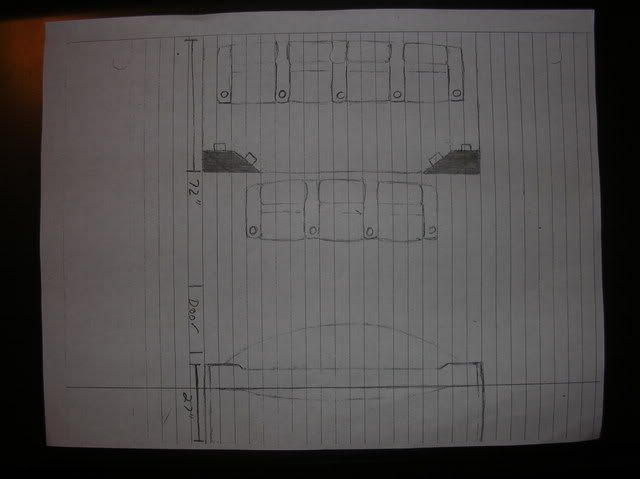

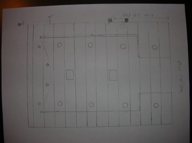

Shot off some pics of my design sketches. I tried to initially use sketchup and I know their is a fairly quick learning curve on it but I have always found it easier to just sketch my ideas on paper.
This was the initial cocept, sketched on index card then copied together. I was using this to show a friends boyfriend the layout for an HVAC quote:
The layout changed cause I couldn't put the entry door to HT where I wanted due to the main waste pipe. It followed the center beam and dropped underneath where the header would have been. Even with where the door is now I had to lift it a couple of inches to clear the soffit frame.
So I had to flip things around in the HT because otherwise we would be stepping up to the riser then down to a front row. The Mrs. wanted a more open feel so we eliminated the walls in the workout area. This is cool because this way we use the same set in the rec room during workouts and what not. I redid the sketch last night to show changes and a redesign in the kittchenette and cocession area.
I had also sketched out the riser and stage concept so thought I would share that as well:
Also sketched the layout of the lighting in the room along with the projector soffit enclosure. I did a L shaped soffit on either side similar to the Arthouse setup, but I promise I had done this prior to seeing his final setup. I also put the final 2 recessed lights in the soffit area in the back. I was originally gonna go with lighting around the soffit but I might have been to much for the room. I will be adding crown and ropelight to the false soffits. Also you can see the curve of the proscenium, which is what I will be moving to next.

Good use of the space. Nice add for the Kitchenette. Where is the equipment rack going?

Thanks, all the equipment will be in the media closet underneath the steps. Accessible just before going into the HT. Just going with a shelf on casters' for now, maybe in the future I'll upgrade to a pull out rack. The way it's set up now it's a usable closet which will serve the storage needs for DVD's and other items as well.
I'm also debating if I still want to make the door for the media closet (unfinished door on right)a faux ticket booth similar to Heynow's. His looks great but when I installed the doors I like the clean look of all the doors together.

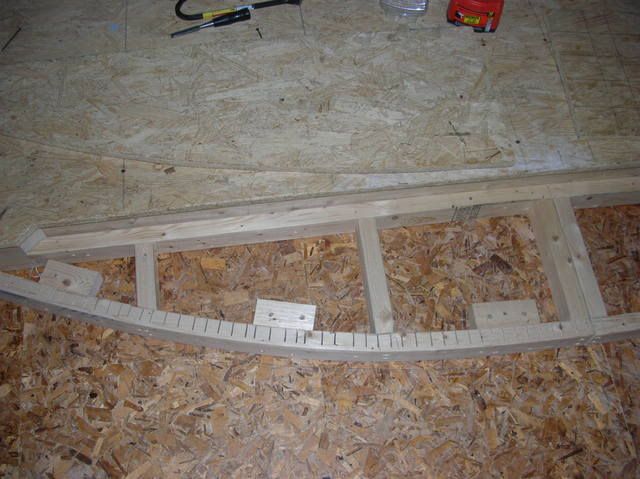

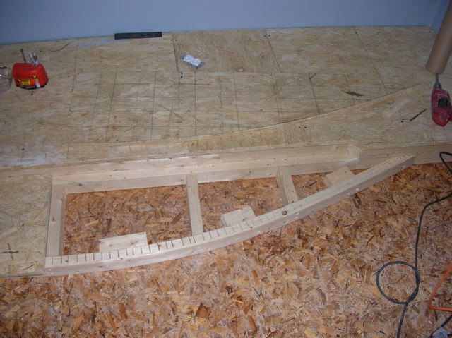

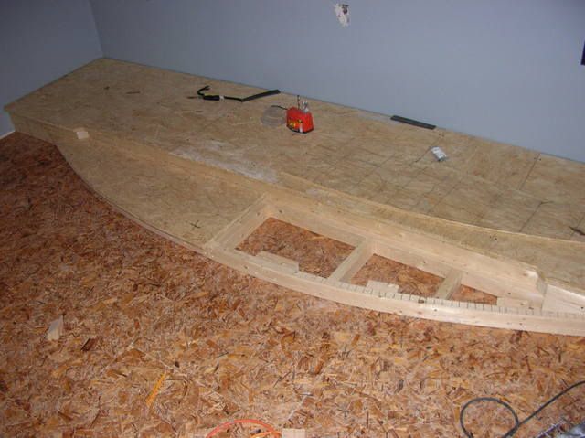

Item 1 is off the list, woo hoo. Here are some images of my curved stage step.
The long angled piece of the frame against the stage was put in place first. Then the rest of pieces were added to it starting with one of the center 2x3 pieces and then the curved 2x3 to the side of the stage.
I then added a couple of more 2x3 pieces for top supports. To secure down the front part of the steps (since the back was already secured in the first step) I added those horizontal pieces along the curve. Screwed from the front then through the top. Then I repeated the whole thing on the right side.
The tops being applied in the following steps were actually done before anything else. This allowed me to trace out the step and then create the proper recess and curve for the steps frame.
All in all I was very pleased with how it turned out, as was the Mrs. when she saw it. As many times as I've explained it to her and I have shown her my snazzy drawings up above I think it kicks in when she finally sees it in person

Last night I started item 2 of my goals list. No pics yet, but I have hung up the front left side of the soffit. I need to duplicate this on the right and then attach 2x3's from the front of the soffit to the back of the wall, where I have already hung a 2x3 going the width of the wall.
RPH who else has joined us in your August Goals challenge? I know there was at least one other, but I haven't seen it since the data loss. Who's gonna step up?
Edited in goals for reference:
Goals:
1. Build curved stage step as seen on the diagram/layout above.
2. Build curved soffit for screen lights, also as seen on the lighting layout above.
3. Install and wire four 3" recessed lights for screen.
4. Build curved false screen wall.
5. Sheetrock curved soffit, compound, sand, prime and paint.
Stretch Goal:
6. Build curved screen frame, and paint.
7. Paint the false wall and stage area behind the false wall black.
oman321 is offline
