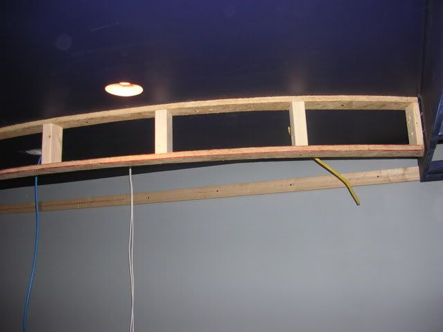

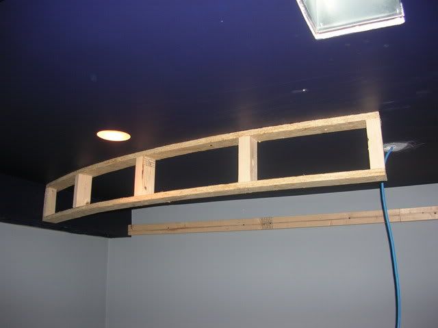

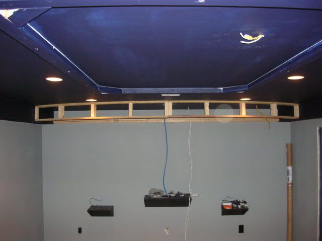

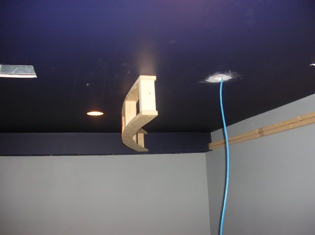

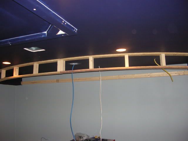

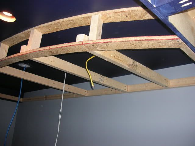

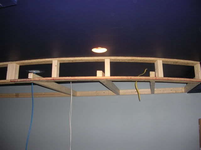

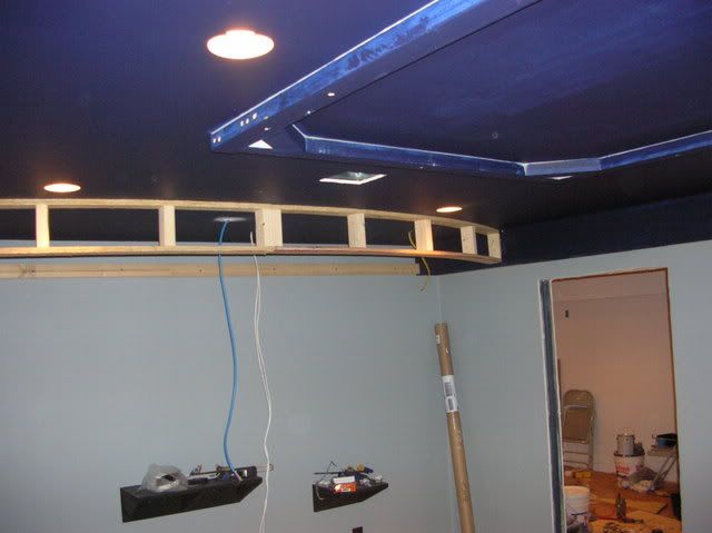

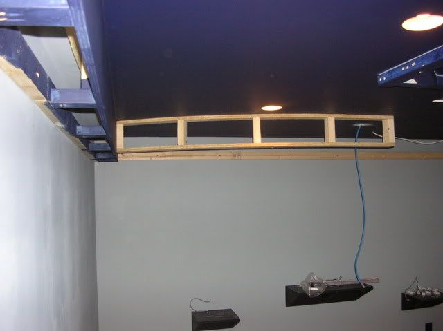

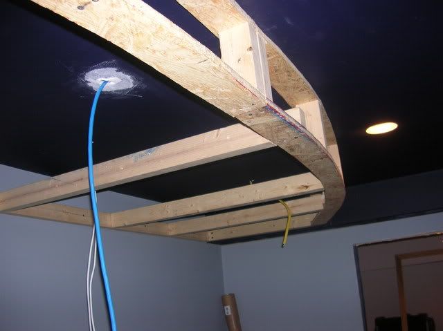

Time for a picture update.
This is the curved soffit I am working on which is part of the proscenium. The first couple of pics are of the left side which I had put up last week.
Then the right side, you can see 12/2 wire which is going to the GE for the 3" recessed lights which will be housed in the soffit. The blue wire on the left is PELV wire also going to the GE. This is for a GRX-CIR-WH basically a IR interface which gets recessed into the ceiling.
Then I added 2X3's for the cross section to secure it all together and for drywall. Still need to attach these to the left side though.
Getting a couple of folks in this week to measure for carpeting and give me some estimates, also my chairs should be shipping this week so the pressure is on. That's ok though I guess I tend to work well under pressure.

Oman, I love what you did with your curved soffit, it looks awesome!!! Makes me which I could have curved my stage soffit as well, but when you see how my room is you will understand why I went the safe route and did traditional square soffits. I should hopefully have some pics up by this weekend, the drywall guy is coming out to tape/mud tomorrow, and move that sheetrock around the stage cans. So I should start cleaning and moving debree out so I can paint the ceiling and soffits over the weekend and take some pretty pictures for everyone. Anyways, room looks great man, I cant wait to see it finished!

What do you plan on doing with the blue 2x4's mounted onto the ceiling in post number 93? This caught my attention, because I was thinking about possibly adding such a 2x4 frame myself and mounting a full sheet of drywall onto it in the center of the ceiling. Is this going to be a star ceiling?

Yes, that frame is for a Star ceiling/skylight. It is actually made up of 2X3's. I actually have some details and pics about it on the first page in post 23, but instead of using sheetrock I am using an inch thick insulation board that I found at Lowes. Very easy to cut and work with, yet sturdy enough to wrap in fabric. I was able to use an oversized needle to thread the fiber thru. I will be attaching trim and crown around the frame and insert that panel to give it the appearance of a skylight.
