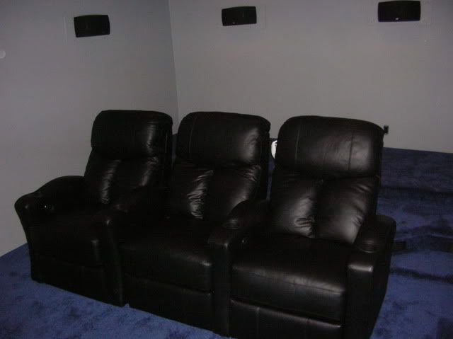

Well, again I would like to update the thread saying that I got my seats and everything is good to go, but alas I have some issues. 2 of my seats have damage on the bottom which will need to be addressed. I am in communication with Roman who promises to do everything he can to take care of me. We will see what develops, trying to keep my cool but it is really fustrating.

Ya, I gotta keep it in perspective. It's a material item which can be taken care of.
Me and the Mrs. chilled and watched some tv. Then we looked at our carpet samples again and made some decisions on the paint.
Other than the minor issues, the seats are really nice. The curve on the arm isn't as pronounced as I thought it would be. It felt really comfy and the power recline is really nice. Had the Mrs. check it out and it brought a smile to her face when she was reclining and she expressed how comfy it was, then started calling down the kids to check it out That's the reaction I wanted...

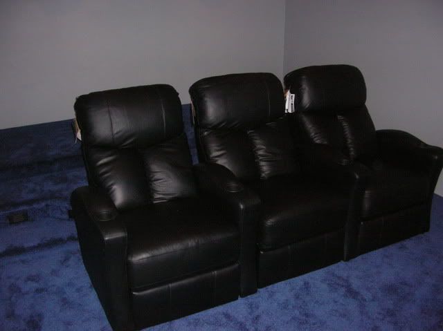

Good news on the chairs front.
Roman has ordered me 2 new chairs which have cosmetic issues in the lower sections of the arms. I am extremely pleased with the service and quick response from Roman. He immediately moved to take care of me and I can't ask for anything more. I highly recommend him and his company as others have done on this and other sites.

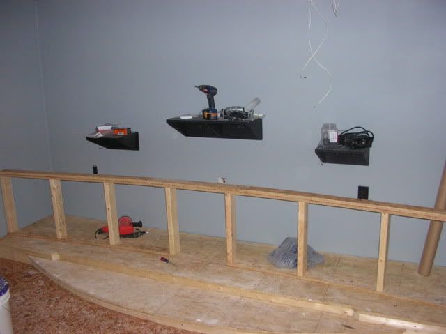

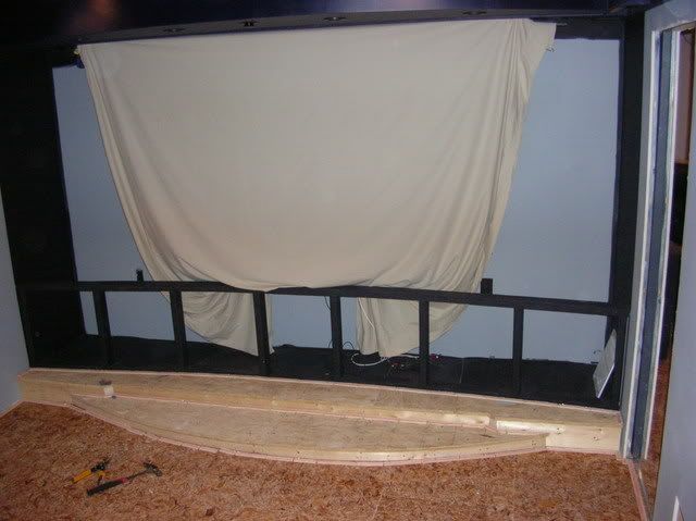

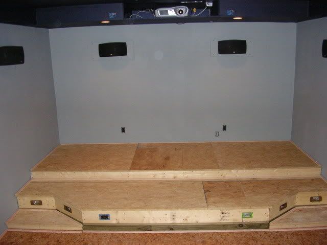

Ok, so I have been measuring and lining out a curve for my false wall as this is the basis for the curved screen as well and it will make it easier to actually cover the foward section of the wall with sheetrock. This has been more difficult for whatever reason to do vs. the curved soffit and stage step, but I think I have it licked.
I ended up using some left over foam boards that I had to try and create a template of the line I had drawn out for the OSB pieces I needed to cut out. I used the template to draw my line and proceeded to cut out 3.75" piece of curved osb the full 8' length of the board. Of course it was off ever so slightly toward the middle of this curved piece. However I was able to salvage the work done by using it for the other side of my stage and cutting down the piece to be the length of half the stage.
Then I was able to make the other half and I have the beginning of a curved false wall. Funny thing was the pieces wern't lining up with the soffit up above. I should have been able to just lift the pieces up and they should line up to the same 18" line I had drawn as a measuring point, but it wasn't lining up. The pieces were curving past each other when they met at the middle. Left it alone and thought about it, one of those thing that drive you nuts.
Well, I had a little time before going to work this morning. Tried checking again, hadn't changed overnight still same problem. Check again with the measuring tape, yup the line I drew is at 18".
Dohhhh!!! wait a minute I'm putting the pieces in front of the line up above, below I'm putting them behind the line where it should be. Move it behind the line and it's good to go. Another one of those can't see the forest for the trees moment.

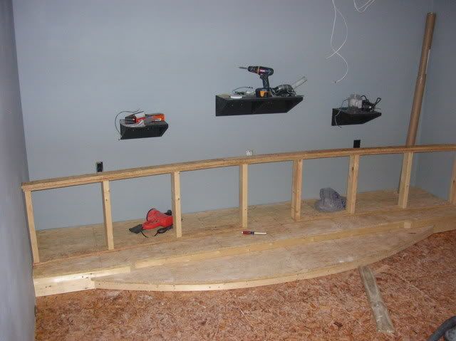

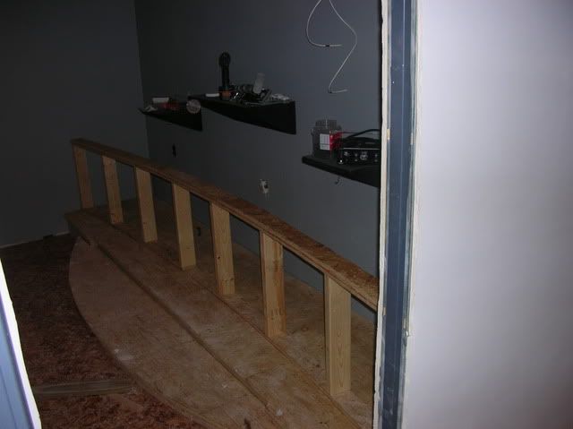

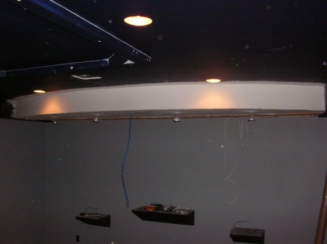

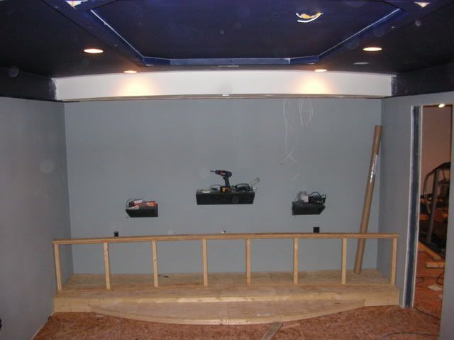

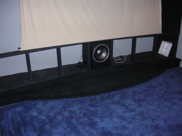

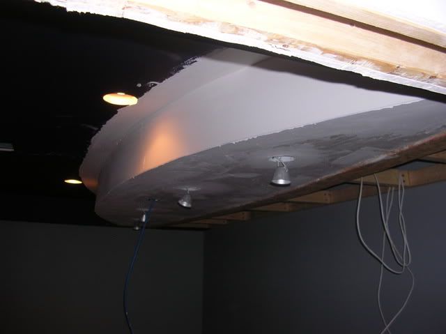

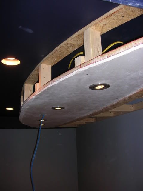

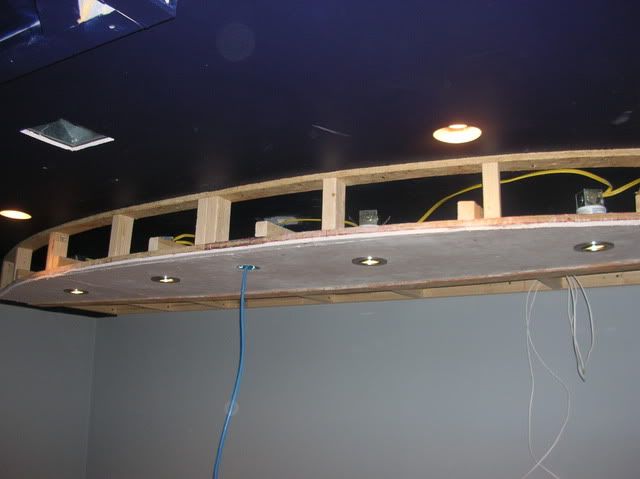

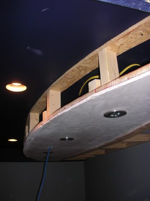

Pics as promised,
This is a pic of the sheetrock added to lower section of the soffit and the lights is place.
Lights on
From the front
With the rest of the sheetrock in place, light trims removed so they can be sprayed black.
Lower section of curved false wall. Hard to tell from the pics but the false wall is 18" away from the center of the back wall and curves out to about 24" at the sides.
That's it for now. Hopefully I can sand and paint that area and move on to the screen frame next so I can finish up the false wall.
oman321 is offline

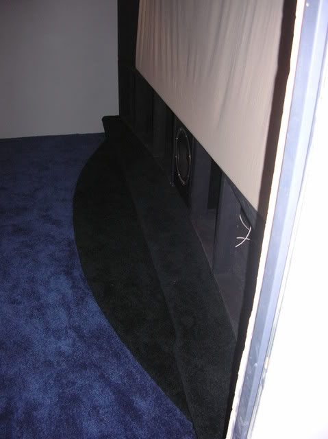

Mrs. stepped up last night. Most of my weekend was occupied helping my sister finish out some stuff in her salon which is supossed to get inspected today. Plumbing, electrical, HVAC registers etc... so don't get it twisted Jason... I had picked up some black paint for behind the false wall. She hooked it up for me. She did the false section which is up and the floor behind it. Getting home last night about 11:30 PM I thought I was to tired to go check it out. Once I took a shower I had to go see it, she did a great job. Nothing tough about it, but it's the thought of doing it for me that I really appreciate.
oman321 is offline

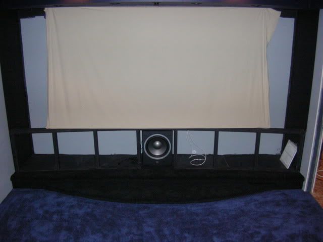

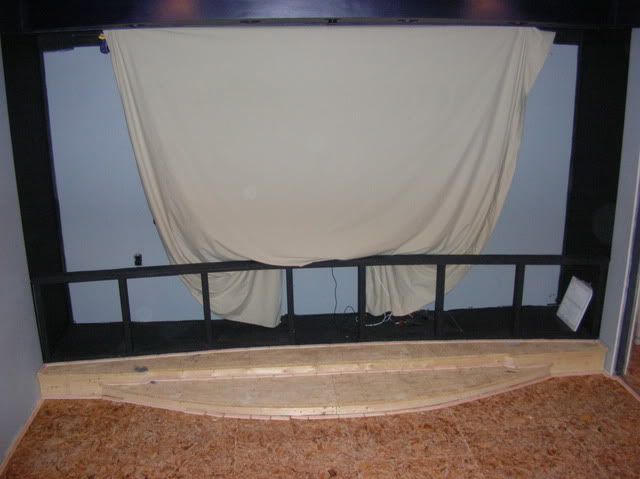

Cancel Christmas I've been naughty...
Saturday night the Mrs. was going to Fenway with my daughter. My daughter had never been and my wife promised she would take her the next time she got tickets. So it was just me and the boy and I had earlier in the day picked up The Forbidden Kingdom. So what is a guy to do when it's just him and the boy? I'll tell ya, you break out the projector and speakers and watch some kung fu on the big screen .
Threw up a bedsheet attached to the exposed section of my screenwall, brought another recliner down and there we were in all our glory with great 7.1 surround sound. Man the bass was thumping, double up .
My wife got to check out the movie last night and it just confirmed to her how the project has been worth it and she's eager for us to finish it. She also said how the chairs make it all the more enjoyable. It'll be tough to ever want to go out to the movies again, which is fine with me.
No worries, it all has to be put away for those who think I'll never be done now. Carpet should be in this week so I knew this would force me to break it back down again. It only took me 40 minutes to set it all up (a new record), so definately worthwhile. It also gave me the chance to test out the riser height and the ability to fully view the screen. As I suspected it's just clipping off the bottom of the screen by peoples heads. I will be adding a mini riser 43.5" deep from the back wall of 2x4's and 3/4"osb just to raise the seats. I was able to test this with some 2x4 scraps which raised it only 3" and it mostly solved the issue, the new mini riser will raise the seats by 4.25" which should safely adress the issue.
oman321 is offline
post #148 of 1056 Old 09-15-2008, 07:54 PM
RPh Drew's Avatar
Location: Grand Rapids, MI
Posts: 1,210
Oh the bed sheet screen... I know many say this is cheating but once in a while I think it gives you a little kick in the pants to motiviate you to finish... provided you put it back away of course.
I pulled mine out again to work on the size stage I wanted and wouldn't you know, it was just soooo easy to hook up and old receiver and two cheap speakers...
Gladiator rocks on the big screen.. make that big black wall.

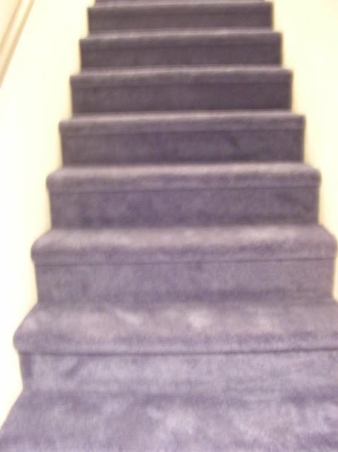

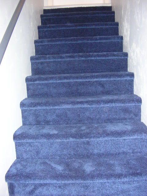

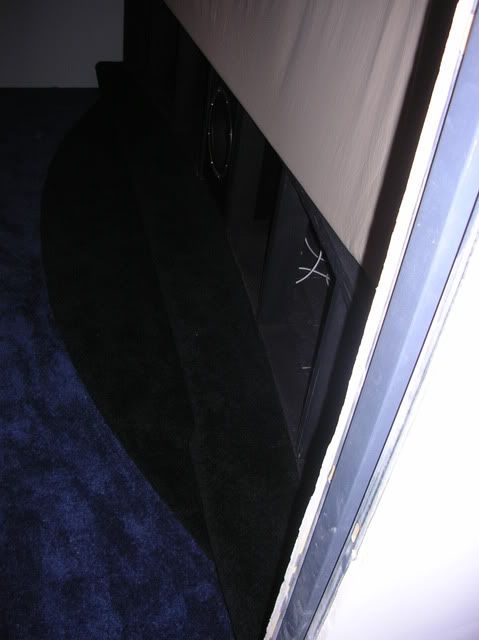

Time for an overdue update.

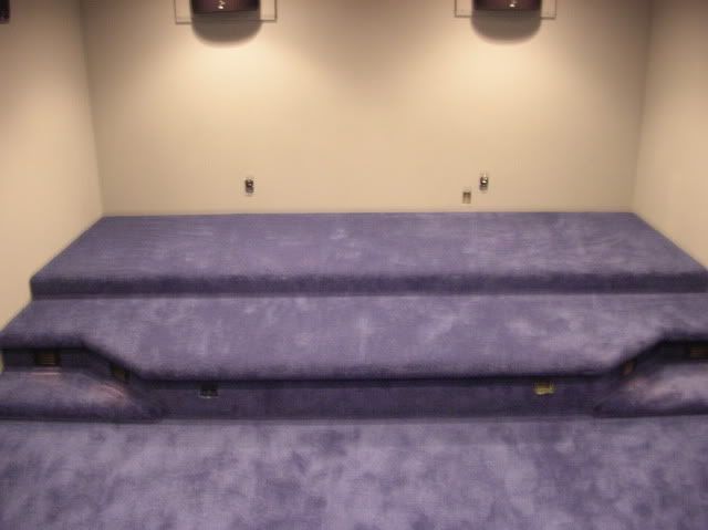

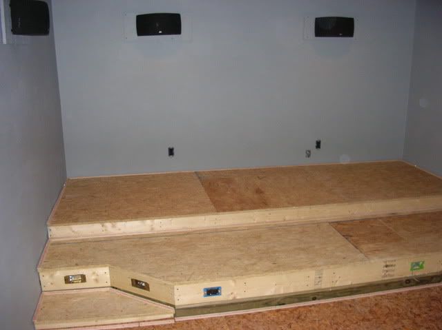

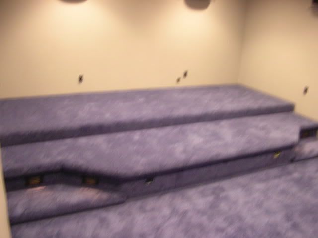

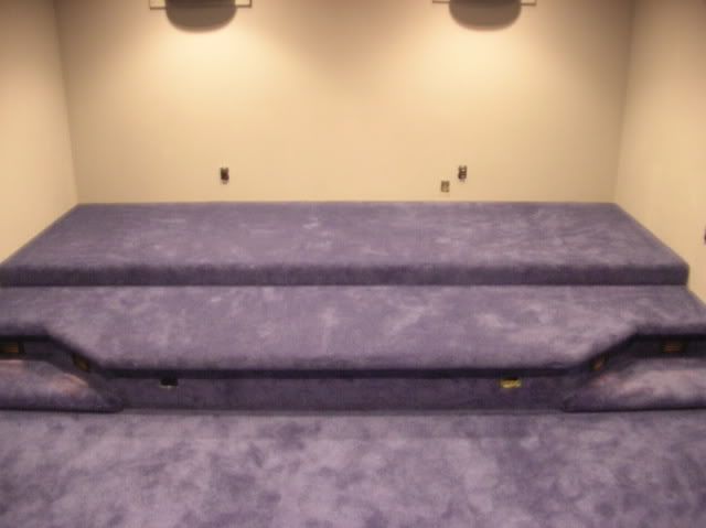

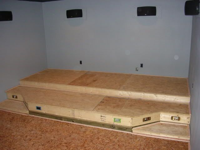

Here are some pics of the additional 4.25" riser added to the top of my 10.5 riser. With the addition of this mini riser it comfortably allows me to raise up my back row of seats to allow viewers to see over the top of peoples heads in the front row and see the bottom of the screen.
Also you will notice that tack strips have been added by my carpet guy Dave whos getting ready to carpet the room and steps leading down to the basement.
Stage with tack strips

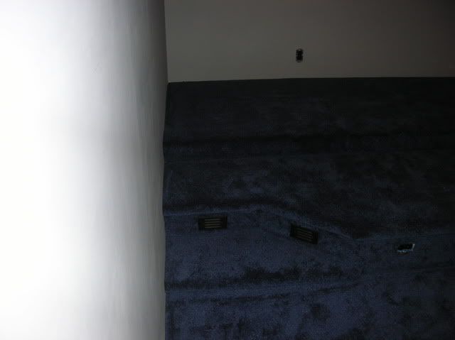

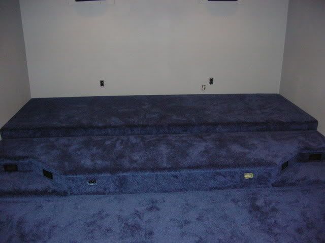

Now to the good stuff. The following pics are with and without flash, the pics without the flash are closer to the color of the carpet but typically come out blury, reason why I post both.
The stage ended up being a major struggle, and while it is a small area/section it ate up a good chunk of the day. We had to dis-assemble the front step because the staple gun wouldn't fit to tack from underneath. Once taken apart the upper portion was carpeted and the top of the step was carpeted from the front while off and then re-secured once the frame was put back in place. All in all it turned out great.

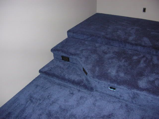

Here are some angle shots on the riser so you can see some better detail

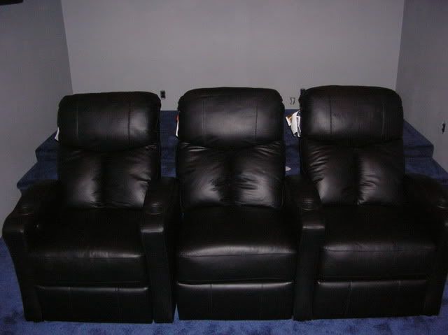

I took the liberty of putting back the chairs which were out already and since I really didn't need to rip all the equipment back down we got to enjoy a movie last night (Shhhh!! don't tell RPh)

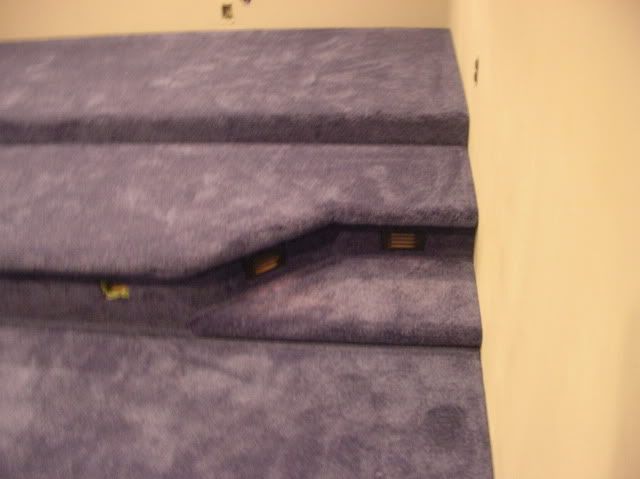

A couple of quick shots of the steps
Again just trying to show the difference between flash no flash.
That's the update, while we were a little worried about the solid color and combination, we are quite pleased and excited with how it turned out.
I gotta say my guy Dave did a great job with the install. First time he's done a dedicated theater room and while I threw a couple of curve balls at Dave with the added mini riser, the low stage and riser steps he took it all in stride and made it work. If any local guys in Mass or RI need carpeting installed for a fair price with quality service I highly recommend his services. Here is a link to some examples of his work.
