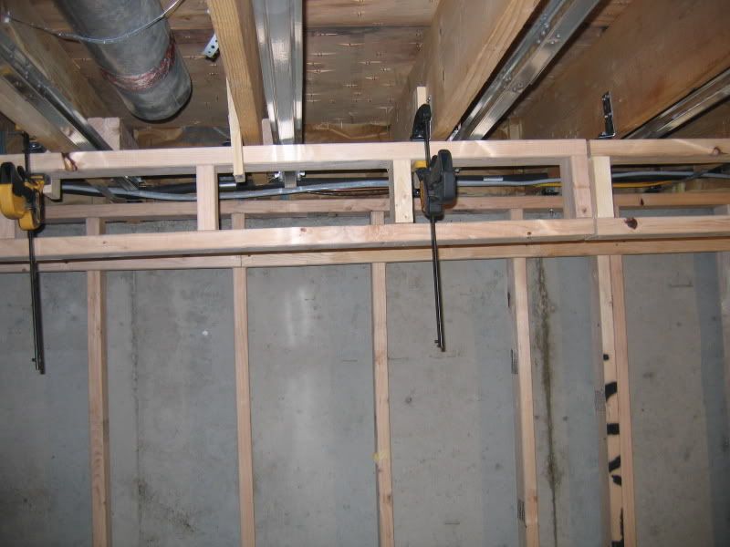

I did it using DC-04 clips.
Had I to do it over again (which I need to do as my soffit is a bit too low), I would have used Andy's method.
Cathan is offline

Cathan -
You saved me the trouble of taking and posting pics (and we all know how long THAT could take!)! Mine would look exactly like yours.

Jason - In my case I had to build the soffit on one side of the room prior to drywall because of all of the HVAC stuff that needed to go inside. For the rest of the room I'll be attaching the top plate of the soffet to the drywall using toggle bolts and construction glue. That would keep the post box soffet decoupled.

Cathan -
Tom
Glad to keep you from having to enter your construction zone. Wouldn't want you to have to get anything done.
