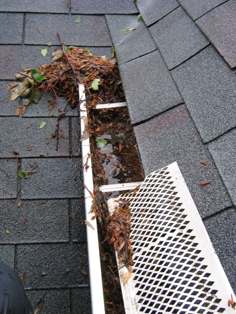

Grrrr. So the three inches of rainfall we got yesterday caused a leak to develop. It was dripping down the inside wall during the heaviest of the rainfall last night. This morning the drippage stopped, even though it's still raining. This isn't the first time this has happened. The spot you see on the ceiling first appeared after a nasty rain storm with high winds earlier this year. But it's been dry since, well up to yesterday.
Since the water was running down the wall I rigged up a way to get the water in the bucket... got to love duct-tape!
I suspect the issue has something to do with the piece of flashing that runs across the roof right above the wet spot. It's possible that when the volume of water is high enough, it seeps up and under one of the tiles. The roof is only a few years old, so besides reroofing the entire section, and other possible solutions? Do they may roofing patch tar that works when it's wet?
I'm also wondering if I should remove the drywall. We plan on repainting the room later this summer, but with the bum arm I can't do any drywall repair and painting for a couple more months. It's been my experience that I'm as likely to find the drip spot as not. For all I know it's coming from another spot and just running down the wood sheeting until that particular spot. And I'd hate to have a hole in the drywall for several weeks. Suggestions?

I'm thinking that upper gutter to the right of the skylight is the culprit.
That pile of leaves suggests that it is clogged, overflowed and got into the crease between the vertical dormer and the roof.

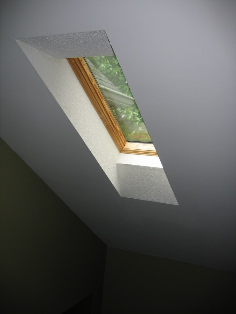

Unfortunately there isn't an attic above that particular part of the house. Whatever the cause, the leak is only present during the truly heavy rain fall where one is likely to get gutter or up-flow related type issues. I strongly suspect it's an issue with that flashing piece. The flashing is directly over the drip spot. Wind may have pried a shingle loose or something. Last house we had we managed to patch the roof with some tar like substance. I may give that a shot. I'll also inspect the roof just in case I can spot some issue further up the roof line.
DC- You are right in that it looks like I may have a gutter issue there too. I'll clean it out. Odd thing is that that particular gutter doesn't have a run off. Not sure I understand where the water is to flow out...

Looks like that gutter was clogged. Water may have been running over the flashing as a result. We'll see if that clears up the issue. For now I think I may put a very small hole in the drywall so that I can more easily tell if that area is dry or not now.
As you can see the previous owner put in some basic gutter guards. I may price out just having some real after market caps put in. We live in a heavily wooded area so leaves and stuff are definitely issues.
This is one cause of your problem. At a minimum you should have a down spout attached that directs the water onto a portion of the roof that empties into another gutter.
I'd be willing to bet there IS an attic, it just doesn't have an access panel. In my house, even with the cathedral ceiling in the bedroom. there is about a foot or so between the top of ceiling rafters and the actual roof rafters. I found that out when I was trying to figure out how to run a coax cable up there to get to the other bedrooms.
Come on, put your DIY man-belt on and go create an access!

agree with BIG. Even if the leaves are emptied, if there is no downspout to the lower roof, its just going to continue. Also I must say you are right this weather stinks! I feel like I should postpone my theater for an ark...
Exactly. It looks like any water that does get in there ends up flowing backwards out of the gutter and up the roof. A really heavy rain probalby has 4 inches of water or more at the spot in the valley where the gutter just ends.
At minimum, you should cap the end off and put an a downspout in a foot or so back. You can also slip some flashing in below where the downspout would drop onto the roof. A better way would be to remove the gutter, install the cap, then re-hang the gutter with forward slope (toward the camer on most of the shots) and install a downspout at the front going to teh otehr gutter or the ground if possible.
Once I cleared out the debris I saw that the gutter run about an inch short of the roof that it's directly over and just spills out. I'd take a photo, but no way in hell am I going back up there today. I nearly toppled the a-frame ladder when trying to get back down. I would have been stuck until a neighbor got home.
I agree with the suggestion about capping and rehanging that gutter. It should have been installed so that it runs towards the roof edge, down a downspout and into that smaller gutter right by the edge.
You're right that there has to be. Here a photo looking out that skylight. That's like a good 16" clearance between the drywall and actual roof. Plenty of room to go crawling around in...
You can also see where a downspout should have been installed.

is that gutter sloped away from the house?
Also it looks like the end is recessed into the roof?????
or is it just an optical illusion?
I just had another thought. If you have any other homes in your development with the same model you might want to check them out. I'm not certain you need a gutter at all in that location. It might be causing more problems then it solves. Once removed it looks like all the runoff would fall onto the roof below and then be carried away.

The gutter slopes towards the roof. There is about an inch gap between the end of the gutter and the roof. It's a completely asinine design. And yes, I most likely can ditch that gutter as it would just fall onto the roof below.
