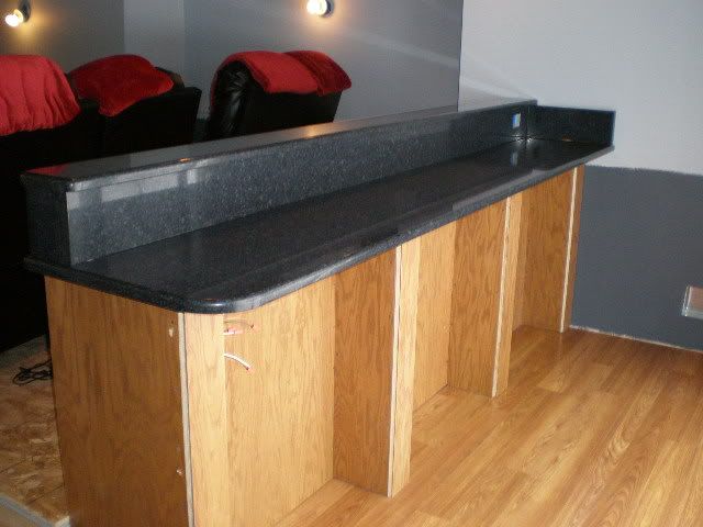

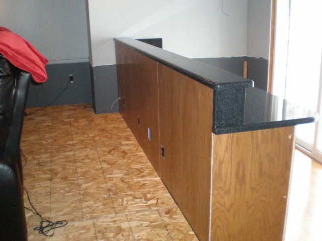

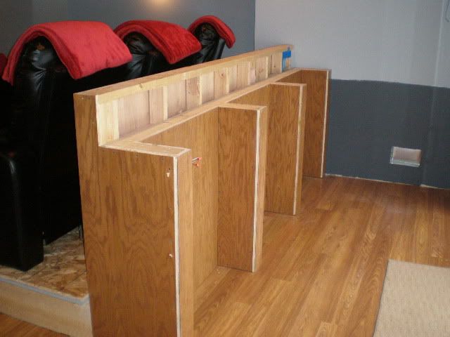

Finally.
I bought the material from a left over sale but when they went to cut it, some machine messed up so they had to order a new slab.
I still need to do the trim work around it but...
Before
After!!!
Dimentions if anyone is interested
18 3/8" of counter top depth
6 3/4" back splash height
7 3/4" depth of top shelf
118 3/4" length
Top shelf overhangs 1 1/2" toward counter top
Top shelf overhangs 3/4" toward front of room
Material: Stylestone
Color: Ebony Pearl
This was designed so I could comfortably fit my lap top on it.
I also had them groove the under side of the top shelf 1/2" wide and 1/4" from the back splash so I can recess some rope light.
Very happy with how it turned out. If I had it to do again, I might have gone with just slightly more overhang of top shelf (say 2 or 2.5" instead of 1.5") to hide the rope light a little more but no complaints.

I like the groove for the rope light. I look forward to seeing it installed.

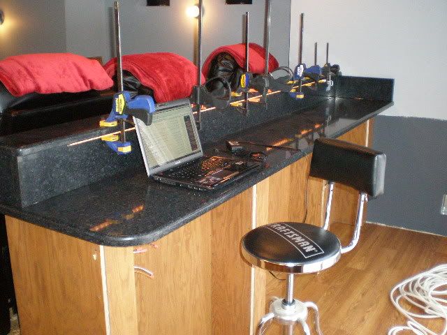

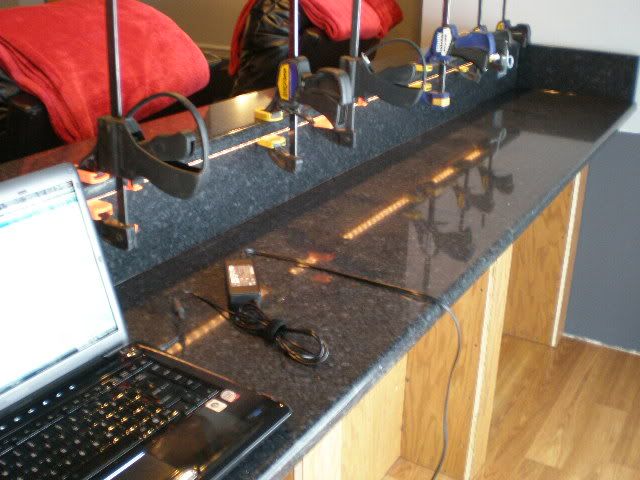

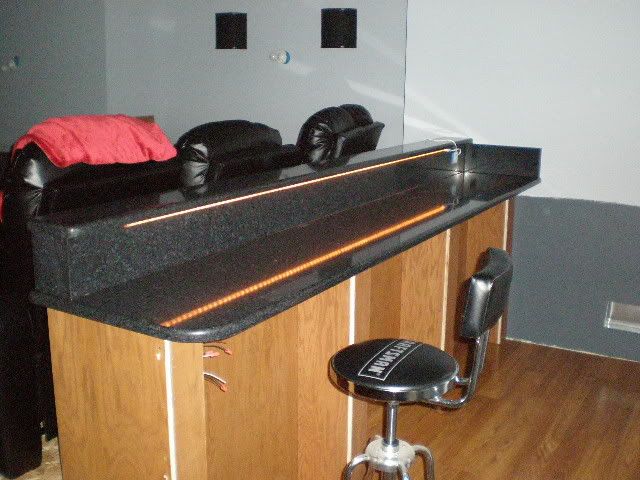

Me too!!!
My countertop is just under 10' and I can only cut the rope light every 2' so I am trying with 8'. I just used silicone to hold up the track Biggie suggested that I got from NoveltyLights.com. I had to trim down the base with a razor blade but it tucked in there nicely.
I don't have curtains yet so I can't wait until it gets dark in here to check it out. Also need to figure out how I will hide the wire at the end. The box in the back splash at the end is for that purpose but the cord is so loooong...
This one shows the reflection of the light on the counter top.
P.S. And no, the Craftsman stool is not the long term plan... Maybe if I was a NASCAR fan...

I was thinking about picking up some of those stools for the shop. Do you like it?
Yea, adjustable height, foot rest... not bad. I see they have some out with arms now. I wouldn't want to sit in it for a long time. Not a very thick cushon. If you wait and buy it when they put it on sale, it is a pretty good deal. This one is for my garage workshop but I stole it from there until I get my theater stools.

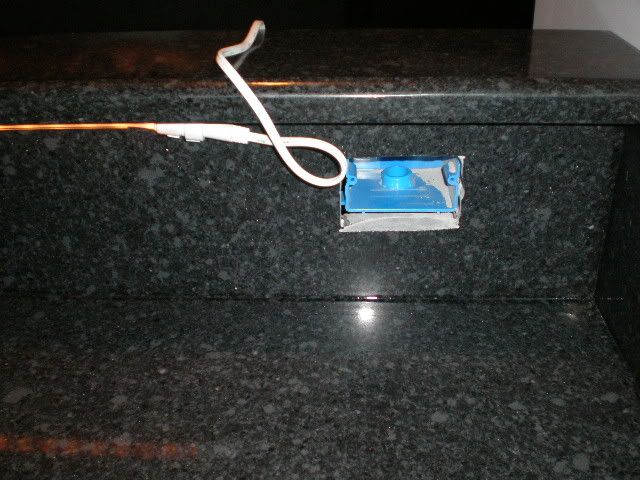

Lights... without all the clamps.
Hard to get a good pic
Eventually it will be on a dimmer and the switch will be under the coutnertop to the far left (by left knee of left most position where you can see some wires sticking out).
I think 8' will be enough.
Here is a shot of the box I have to work with. It is tied to a box on the other side of the bar that is run by the previously mentioned switch. Not quite sure how I will wire. It is very deep due to the depth of the back splash so I may install the outlet in the box that is deep then coil the wire in the 1" + space infront of it then put some other cover on the surface of the back splash.

Looks very clean! I can see why more overhang would have been nice though. Something you can try to hide the light is a 3/8" rope light instead of 1/2". It might sit deeper in the groove.

Good thought. I am using the plastic channel to hold the rope so I could also color the front part part of the channel with black marker or something.

Ahh... so you aren't tension fitting the rope directly into the groove? You might be able to stuff the 1/2" in there and have it sit lower without the channel/track. Otherwise, I might try the 3/8" rope.
