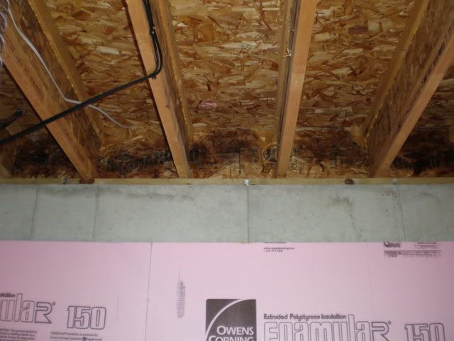

I did a fair amount of research on insulation and followed the results of a test out in Minnesota. They suggested applying extruded polystyrene directly to the concrete with glue then building the 2x4 walls inside of it. Basically, when sealed properly, it doesn't let any warm air from the space come in contact with the concrete. I have excellent drainage and sandy soil so the only exterior moisture I have to worry about is just the normal moisture in the ground.
Thanks to the crappy framing the builder's mini-van dude left me, I tore out his work in the HT and started over.
This is also when I removed the fiberglass insulation from the rim joists and noticed moisture behind the insulation. The basement is dry but just moisture from the warm air hitting the cold wall caused the condensation.
Notice the discoloration from the wet boards.
For the theater I used 1.5 inch extruded polystyrene and then built my walls.
Being that my shower stall was already installed and I didn't want to do this in the rest of the basement...
Time to bring in the big guns of insulation
After insulating and rebuilding the walls of the HT, I hired out for the closed cell spray foam insulation and man this stuff is great. He did all exterior walls except the HT which I already had the polystyrene on, the rim joist all the way around, and I had him spray an inch on the ceiling of the HT and game room to help control sound. That stuff really fills in the cracks. I didn't take many pics of this rather video so you will just have to take my word.
The stuff has a 6.5 R-value per inch and really seals up the air leaks. The inch I put on the ceiling was just a little extra sound dampening. I can't fill the joist space with insulation (as mentioned above) due to using them as cold air returns.
At some point I may download my video camera and capture some stills but I wouldn't hold your breath...
Ok... so now my cave is sealed... Stay tuned...

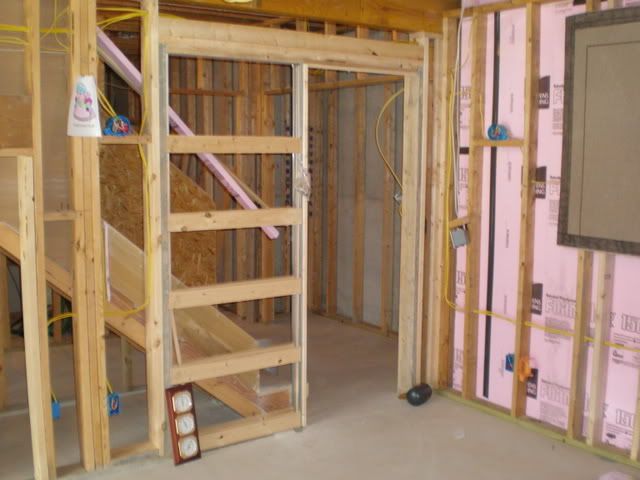

If you look at the floor plan in the first post, you can see that you can enter the theater from the hall at the bottom of the steps or from the game room. I gave a great deal of thought to closing off the entrance at the bottom of the stairs and dry walling over it. I just couldn't bring myself to do it.
The builder just had a makeshift rail up to meet code to get a certificate of occupancy.
I decided to go with a pocket door.
I still haven't decided on what type of treatment (color or drapery covering) the door will get but the door stays.

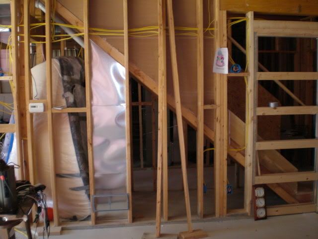

I have planned to run all of the equipment into the closet below the stairs with access to the equipment from the theater through the wall. Unfortunately there is not only a cold air return but also a 4-inch drain stack exactly where I wanted to put it. The cold air return could have been moved fairly easy but the drain stack would have been a pain.
So I had to shift it to the right where it will not be has high or as tall.
My wife and I are huge hockey fans (wing nuts if you will) and have been planning to use a jersey display case as a door to the equipment. As time has passed I believe I will be pulling the hockey theme out of the theater and applying it only to the game room. I was thinking of using a movie poster for the same purpose but now that I have read the recent thread on equipment racks and see how cool they can look even as a diy I may go that route???
Not sure at this point but the equipment is definitely going in there.

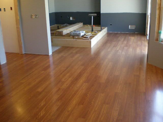

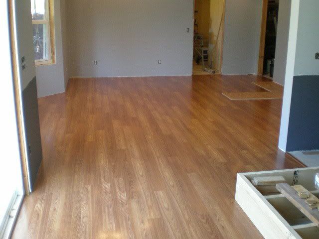

The Laminate Flooring is in!!!
Before....................
And after...
I am thinking about using the same boards to treat the sides of my riser.

post #20 of 1060 Old 05-16-2008, 12:13 PM
JeffC's Avatar
Join Date: Mar 2003
Location: Hawkeye State
Posts: 1,554
Looks good! Laminate has an instant WOW factor! Gotta love it
