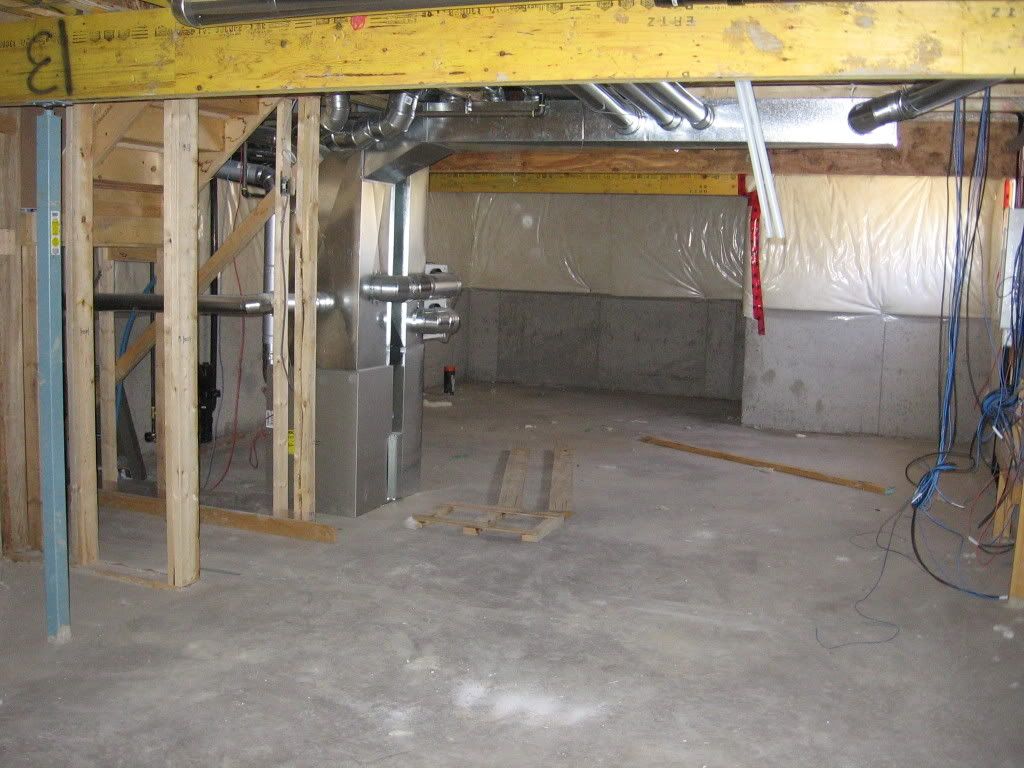

In prep mode for the build.

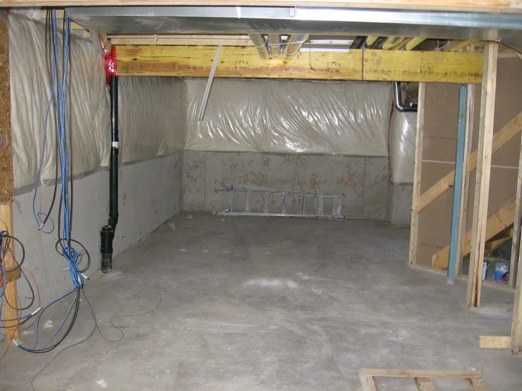

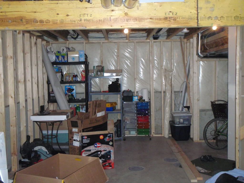

I have a lot of stuff sitting in my basement, so I have tried to clean some of it out. Without a garage yet, It makes it hard to find space for everything. Here are some pics to start us off:
Empty basement, looking towards the future screen wall:
Empty basement, looking away from the future screen wall:
Basement as it is today, looking towards screen wall:
Basement as it is today, looking away from screen wall:
Future AV Rack location:
As you can see, I haven't really done anything yet aside from move some stuff around and buy the studs needed to frame the outside walls. I will let them sit for about a week to warp like crazy, then get started on the framing.
More to come....

Posts: 825
Well, thanks to the many suggestions, here is a new layout. Thoughts and/or suggestions?
sgolko is offline

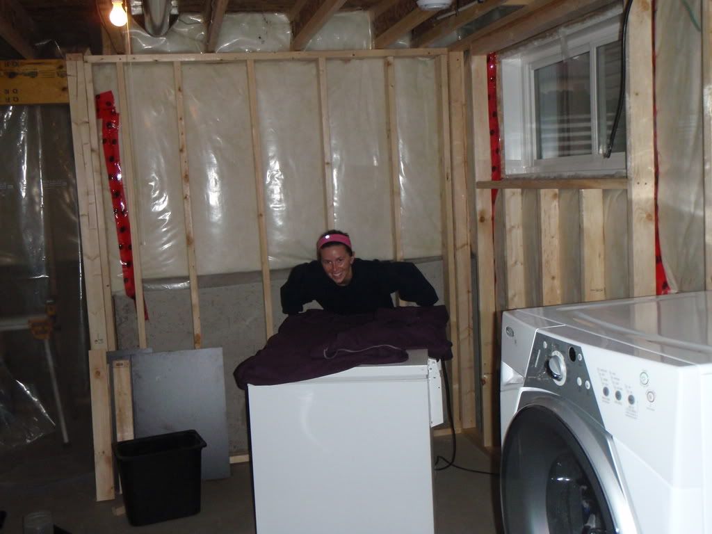

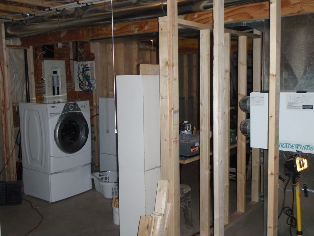

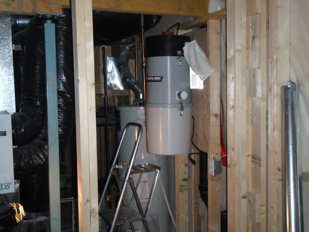

So maybe I should have called it "The Incredibly Slow Progress Theater".
Anyways, here's an update of what has been done (or not done) so far:
Framed the exterior walls
Moved the vacuum into the furnace room, but not tied in yet. Need to make another trip to HD.
Moved the washer and dryer to below the electrical panel. no leaks!!!
Moved stuff around (or got my wife to) way too many times. I wish the garage was built already so i could just get this junk out of the way.
Now I have started laying the DriCore, I have 65 of about 130 pieces down already. Sorry, no pics of that yet. After this is done, on to the framing of interior walls.
Note I have made some changes to the original post.
