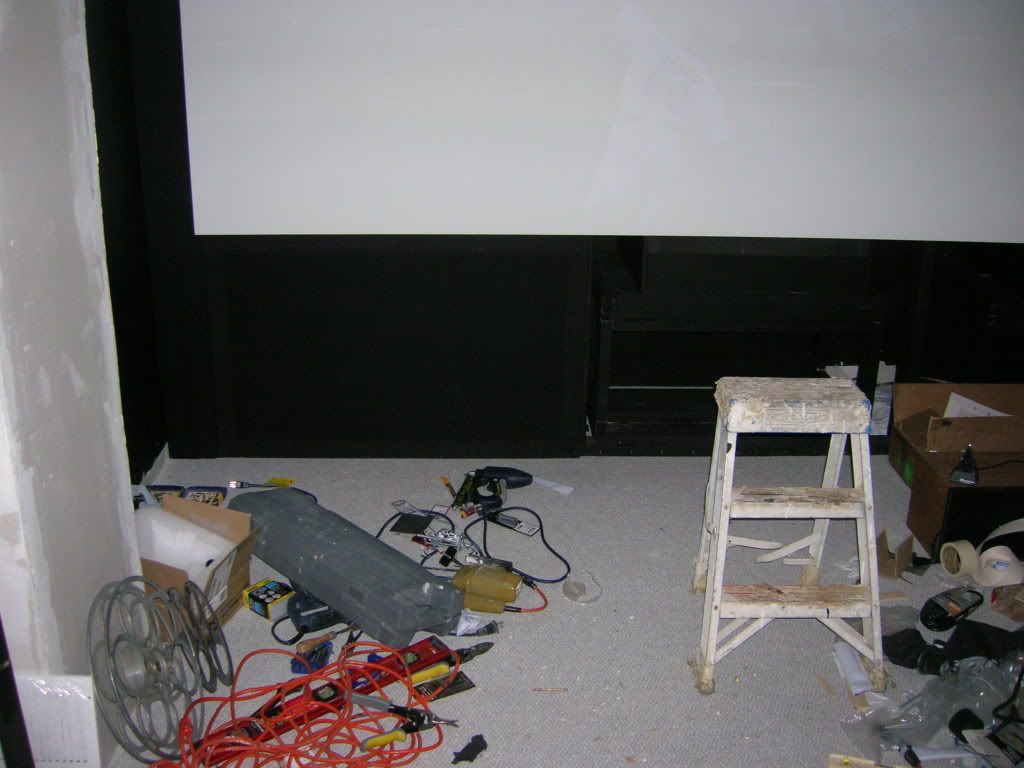

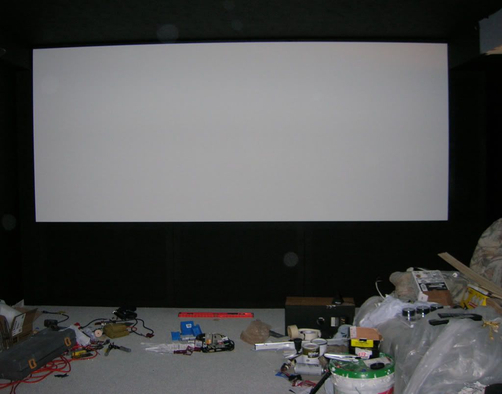

Screen fabric arrived.... here it is rolled out:
Frame angled for all I could get it out it:
Cutting the screen material:
Just before stapling.... I can't seem to find my stapling pics, though I know I took some....
Finished Screen:
Brian D is offline

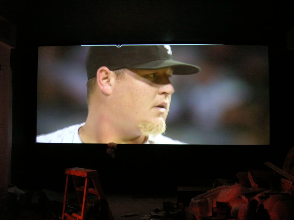

Quick shot I took while watching one of the White Sox/Rays playoff games... this is in HD, but I did not pause it, just tried to snap a shot where the camera wasn't moving a ton across the playing field. Also, I did not size the content properly to format, just using the whole screen... still looks really good in person.... you can see a plastic bag on the bottom of the screen because I had it over part of one of my vices holding one of the fabric panels tight until the velcro glue dried....
