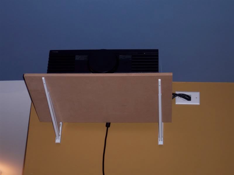

Below you can see the Panamax outlet for the projector. I have built a shelf on the back wall because I have small "I" beams in the ceiling that wasn't big enough to attach a mount to. I do have the Chief RPA-Universal though. The other plate on the wall is a single gang cable outlet where I will run my cables from the PJ through the wall.

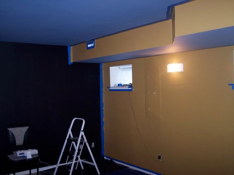

I covered the sconces so I could do the patchwork to the 12 holes the electrician put in my walls and ceiling.
Yesterday I painted the ceiling a Bluish Gray color called "Skipper" from Behr. Flat of course and 2 coats. Oh yea the whole room was primed white before any painted began.
That is where I am as of today. I plan to paint the screen wall tomorrow followed by the other 3 walls this weekend.

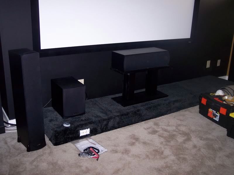

As for the speaker stand that I made, should I paint that flat black or stain it? I don't want to use a glossy stain if I decide to go that route. Do I need to prime the wood first if I choose to paint it? That's it for now!

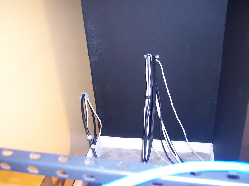

Today was filled with frustration! I began running cables and wiring up my rack finally. I spent just about all day doing this (I had the day off thank God). Since my rack can be rolled out from the wall, I planned on running the cables a certain way so they don't get bunched up when I push the rack back into place. I planned this out on paper and in my head and go figure. I get the whole rack wired and I can't push it back in because of the cables getting in the way! The rack was so nice and neat because I took my time doing it!
So I un-did whatever cables that was going to need to hang off the back and I will re-think another way to do tomorrow. I left the components all cabled up because they are attached to the rack.
My riser is almost done. Just waiting for a digital audio cable from monoprice that they have on backorder. Once I get that, I can seal up the other side.
I did some basic tests with PJ over the weekend and the picture looked pretty good and that is without any kind of set up or calibration. Once I finish the other things at hand, I will spend more time dialing in the settings on the PJ.
As you can see in the first pic, the rack can be pushed straight back into that cubby hole area in the room.
I thought by creating a "Snake" with all the cables by using velcro would help when I moved the rack back into place but that proved wrong. I think I am going to have to run the cables up the wall about a foot or so and mount some sort of hook or clamp so when I pull the rack out (hopefully not to often) the cables will hang instead of being on the floor. The last pic is the rack before I un-did some of the wiring.

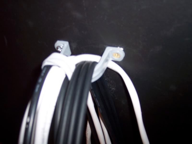

For the time being, I rigged my cables to run up the wall and then put a pipe clamp thing on the wall and ran the cables through that. This allowed the cables to hang instead of lying on the floor. I was then able to push the rack further back then I was before I rigged the cables.

Your speaker stand looks very similar to one I did in my previous theater. I say with a a satin black or ebony stain. Flat black is going to show a fingerprint everytime you even breathe in the direction of your stand.

I would stain it using black dye. That way it disappears against the front wall. If you do chose to paint then yes you want to seal/primer the wood first.
